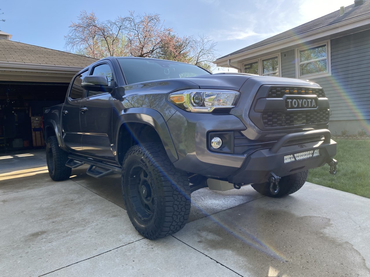

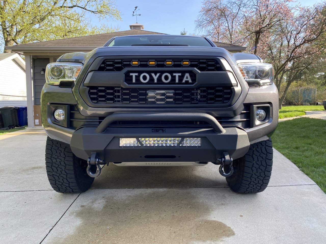

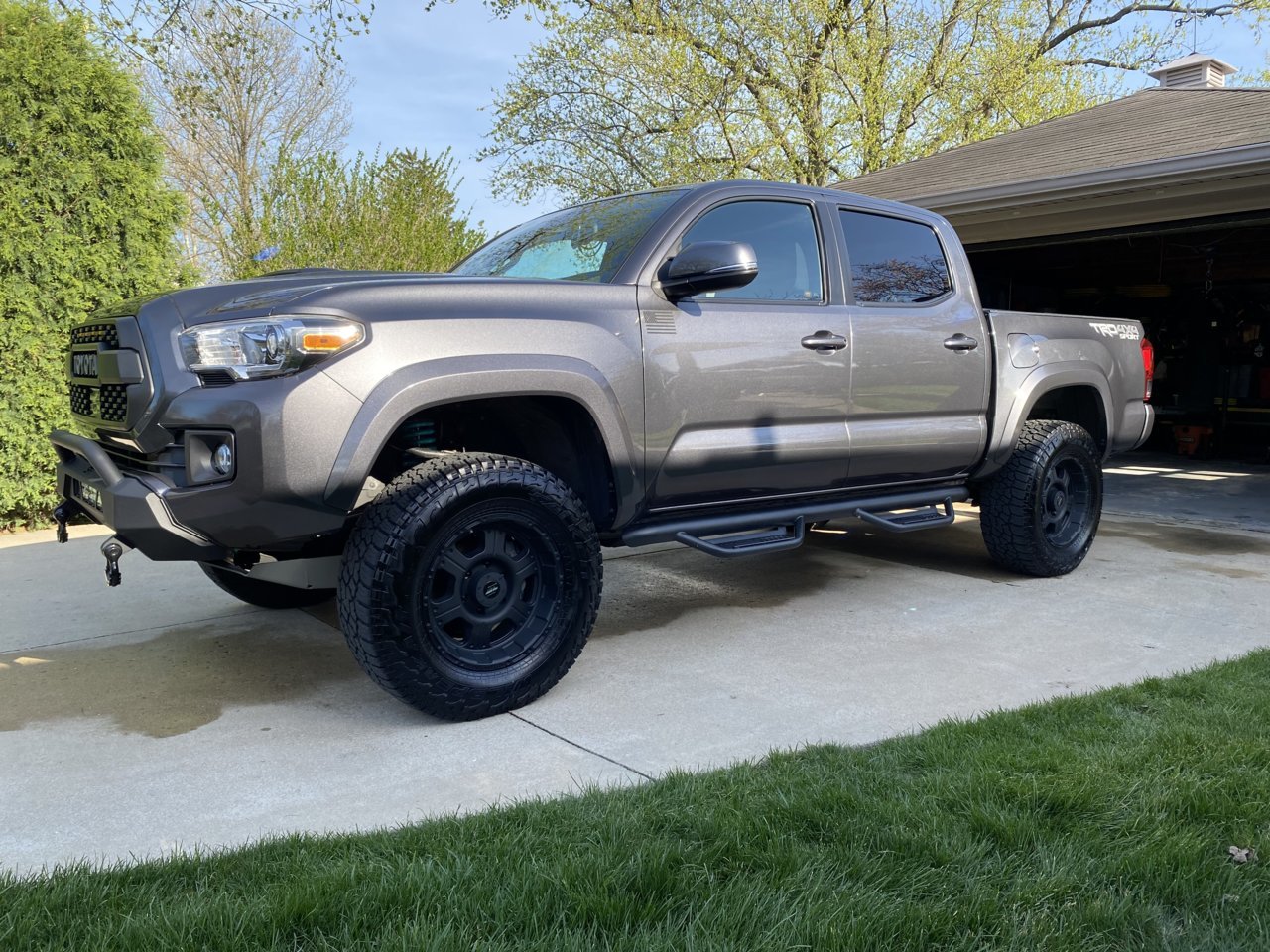

    So, after 1 week and 170 mi of driving, Measurements are
    From Hub Ctr to bottom of fender 22 3/4 both driver and pass side are dead on (I do have 1/4 lean spacer also).

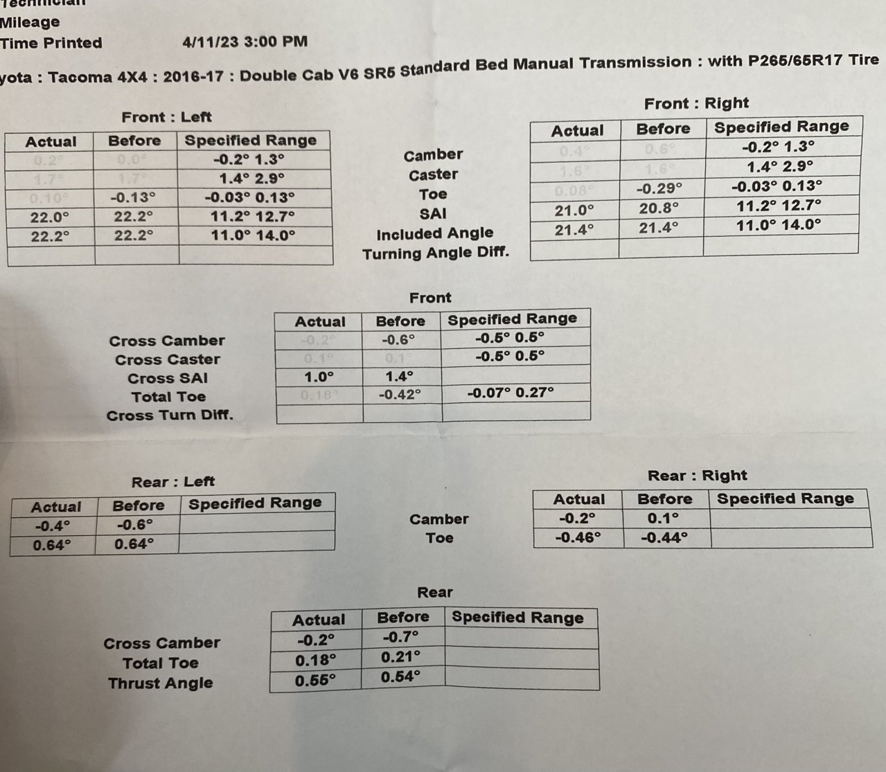

    Pretty sure I’ll need to get some UCA’s, alignment guy said I was pretty maxed out.

    What are your numbers at currently?

    What numbers are you referring to? Alignment or height numbers?

    I was asking about alignment numbers lol

    You had already looked at my alignment…. Haha. The alignment tech told me I’m maxed out with the OE UCA’s

    Haha so I have! Sorry I see so many different ones day in and day out
    Unfortunately without seeing the cam adjustment tabs it's hard to tell but if he's got them turned completely in any further turns would start going backwards then. Yes he is correct youre maxed out.

    Ok, thanks… looks like UCA’s are next on the agenda. Will have to wait till for awhile. But it drives fine so it’ll work
