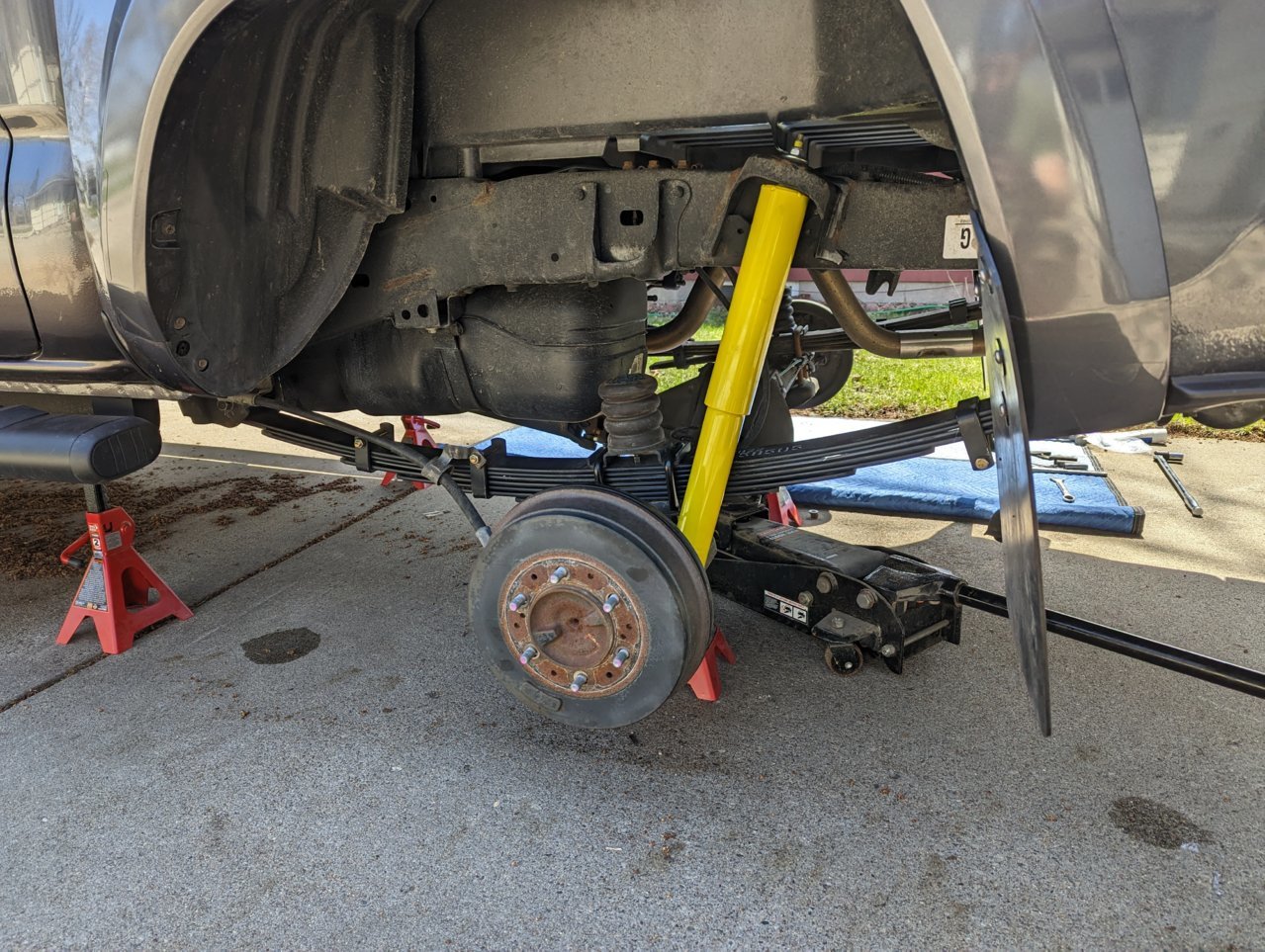

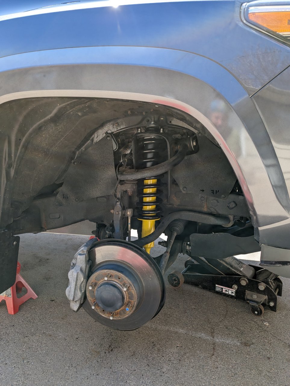

    Got my Dobi lift fully installed. Just have to install my steel front bumper this weekend and I have an appointment for an alignment on Monday.

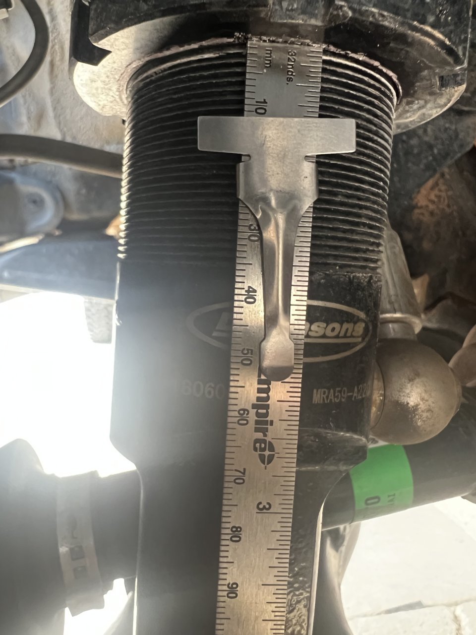

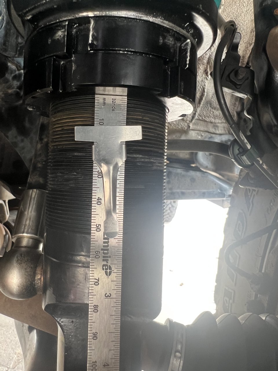

    I’ve got an interesting scenario…
    I adjusted my MRA coil seat height today. I raised the ride height on the front driver by ~1.25” after raising the seat height by ~0.6”. I then went to measure my passenger side and the hub to fender and ground to fender have the same numbers as the driver side! I measured the seat height to bottom of the threads on both sides and they are 0.6” difference. I am utterly confused.

    Sounds like you had a lot of lean that needed correcting and now it's balanced
