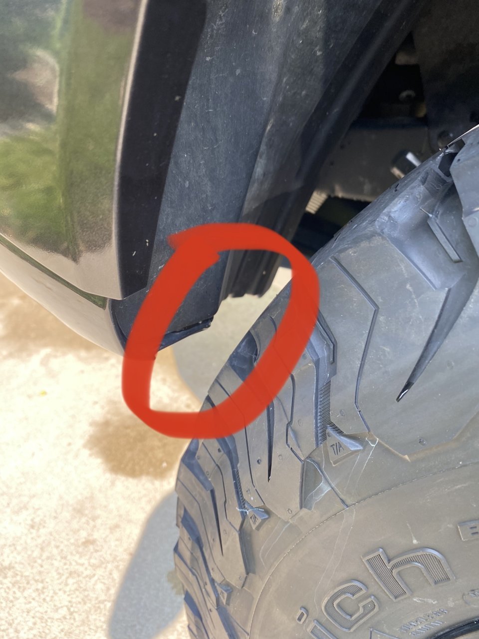

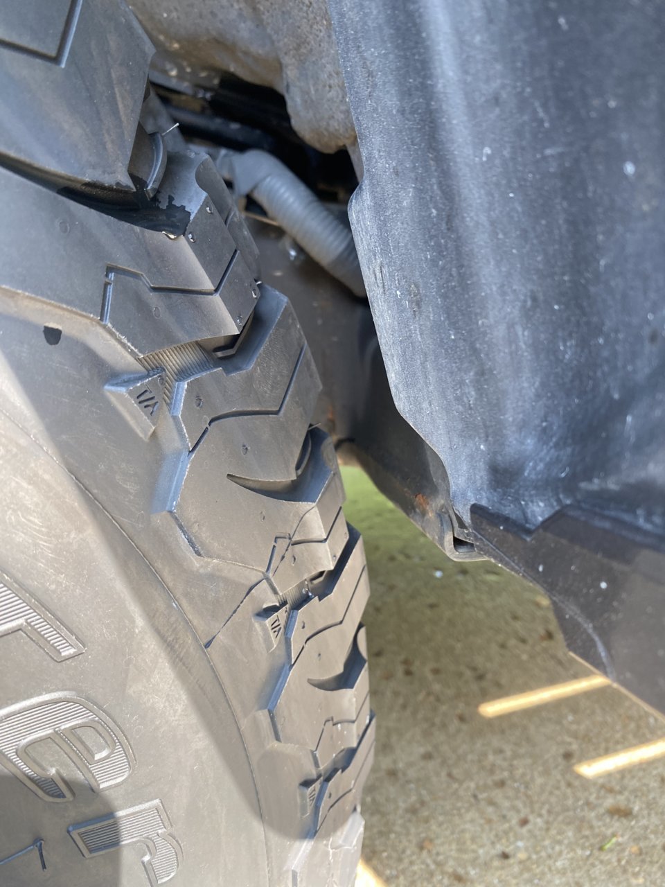

    @Crikeymike morning feller, hope you're having a nice day. This could probably be sent as a PM but I like posting publicly in case someone now or in the future has a similar question, actually 2 this time.
    1. Because of the coil seat height required to get the amount of lift to clear 285/75/16 tires on -6 offset (stock 2020 TRD OR wheels with 1.25" spacer) and account for considerable amount of Taco lean I have a good bit of kick out when going over a bump on the front driver side because of the preload, almost feels like a blown shock but I know it isn't. Is this something that can be sufficiently solved by adjusting rebound or am I looking at getting different coils? I opened the rebound all the way and it doesn't seem to have helped any. For clarity I have MRRs with 352 coils, with a stock front end, and only got 1.5" of lift in the front setting at stock seat height with 352 coils so I upped the seat height to reach a hub to fender of 23". I will measure my ground to fender and bottom shock bolt to seat height later today for exact numbers on both sides. Before I raised the seat height, it was driving like a dream and I think I got everything tuned exactly how I wanted it, but then I switched from 255s to 285s and needed extra height to clear the cab mount.

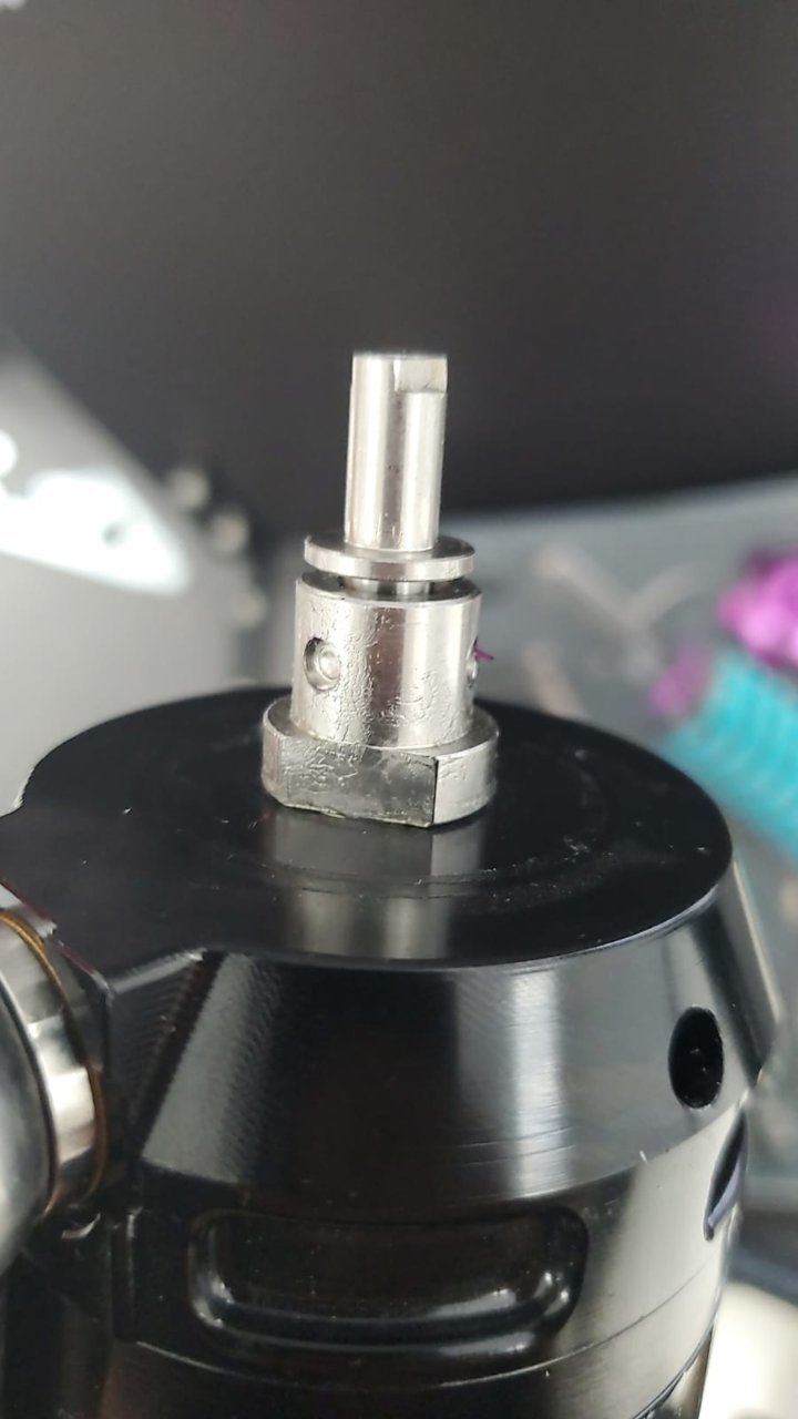

    2. My friend has had MRRs on his 4th gen V8 4Runner for a little over 18 months now and cannot adjust his compression knobs at all. He keeps his truck very clean and never goes through mud, so it must be some other grime from our roads out here in Colorado? Is it safe to wrench the adjusters open with a pipe for leverage? Dobinsons offered to inspect the shocks, but we leave for my bachelor party in Moab in 2 weeks so we are running tight on time...
    As always, we appreciate your knowledge and time in answering what is trivial to you but perplexing to us.

    Hey man.
    If it rode great before and now it isn't, then that's unusual. Those coils are definitely not rated for zero weight up front, so that's probably the main cause of it. You'll just have to play around with the valving adjustments. I recommend running more than less rebound adjustment, especially with a spring that's too strong for no weight, as the front will try to bounce back up really fast after compressing. Adding rebound will slow that down.
    Are you running UCA's? The ball joint angle binds up and firms up the front end if they're still stock at 23" hub to fender (3" lift).
    Also adding more lift won't make the tires clear. The range of travel of the strut hasn't changed, the tire can still go up and down the same amount. It's the alignment that can help clear tires more than anything, before cutting/clearancing.
    Sounds like he needs to take the adjusters off and clean underneath first. Dobinsons can give him the low down on how that works, but it's super simple. Just unscrew the screw in the middle of the LSC knob, then it comes off, then the allen head screws holding the purple adjuster on, then that comes off. Probably just got some gunk under there. You can use the adjuster tool it came with to add leverage, but I wouldn't use anything more than that. Mine are 3 years old and still adjust by hand, no tool, so it must be junk in there. Check for Loctite on the threads before putting it back on too.

    From my friend "when I unscrewed the first one, oil starting coming out, maybe I unscrewed the HSC"

    Have him call Dobinsons . Oil should not be coming out.

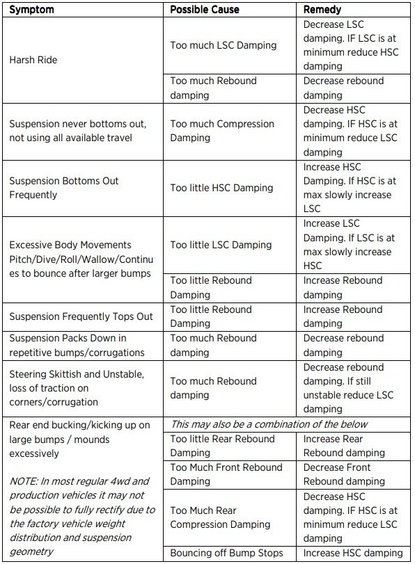

    @TheColoradoAthlete I'm sure you have all this, but MRA instructions and troubleshooting can be found here. @Supr4Lo shared his settings over here. I think you'll notice a difference after installing the weight. Also, if your thread count is maxed out, then you might consider adding the 1/4" spacer up top like I did to reduce the seat height.
