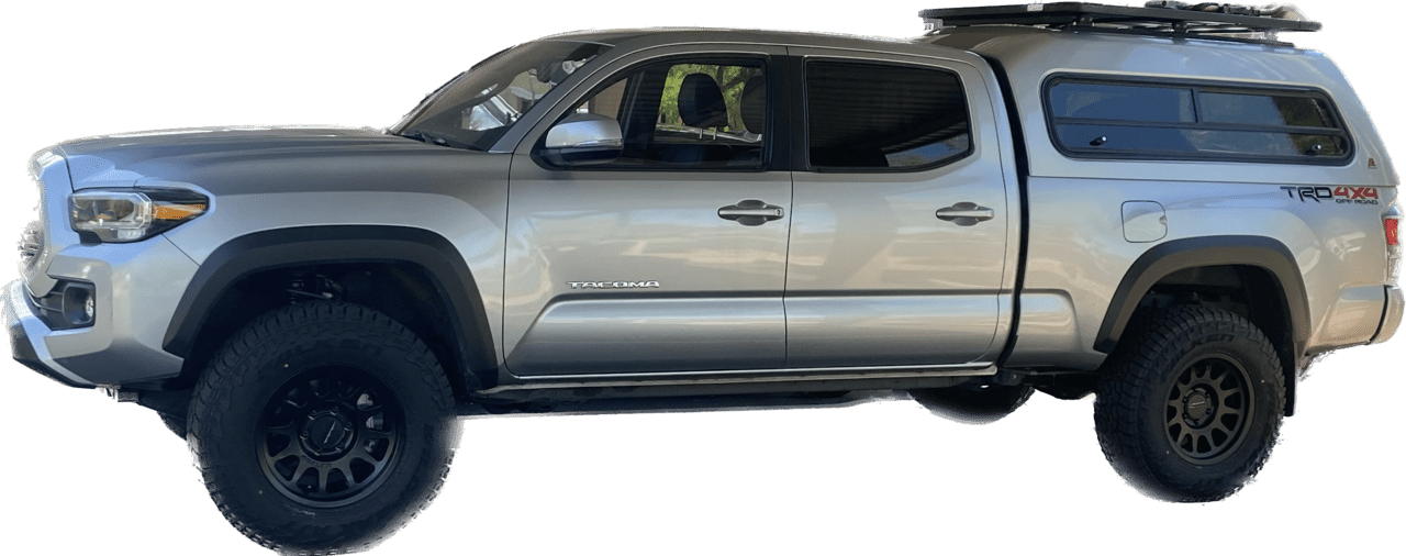

    Had a local shop install dobinson IMS a few weeks ago. C59-314 Coils up front. Heavy duty (L59-112-R) leafs in the rear but removed the 5th leaf. Ride height is about perfect. Slight rake in the rear, which is what I was after. Also had a set of SPC UCAs installed and had the caster set to 4 degrees. I have a slight rub at full lock on the driver side so I’ll do a Cmc this weekend and then go flex the suspension. Running 285/70/17 Falken Wildpeaks. Goal of this build is to increase the trucks capability but keep the weight down. No steel bumpers will be added to this little truck. 4.88 gear install schedule for next month.
