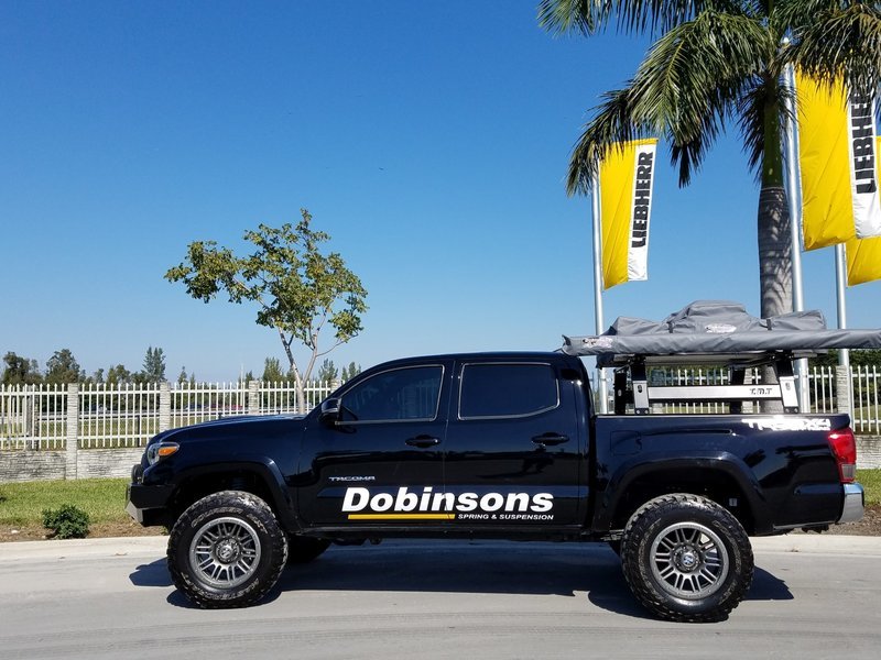

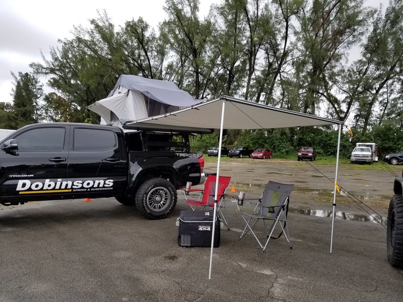

    New Klutch wheels are getting a lot of attention around here, finally got some UCA's and a good alignment. Also added a TMT bedrack we had laying around with our Dobinsons RTT and Awning.
