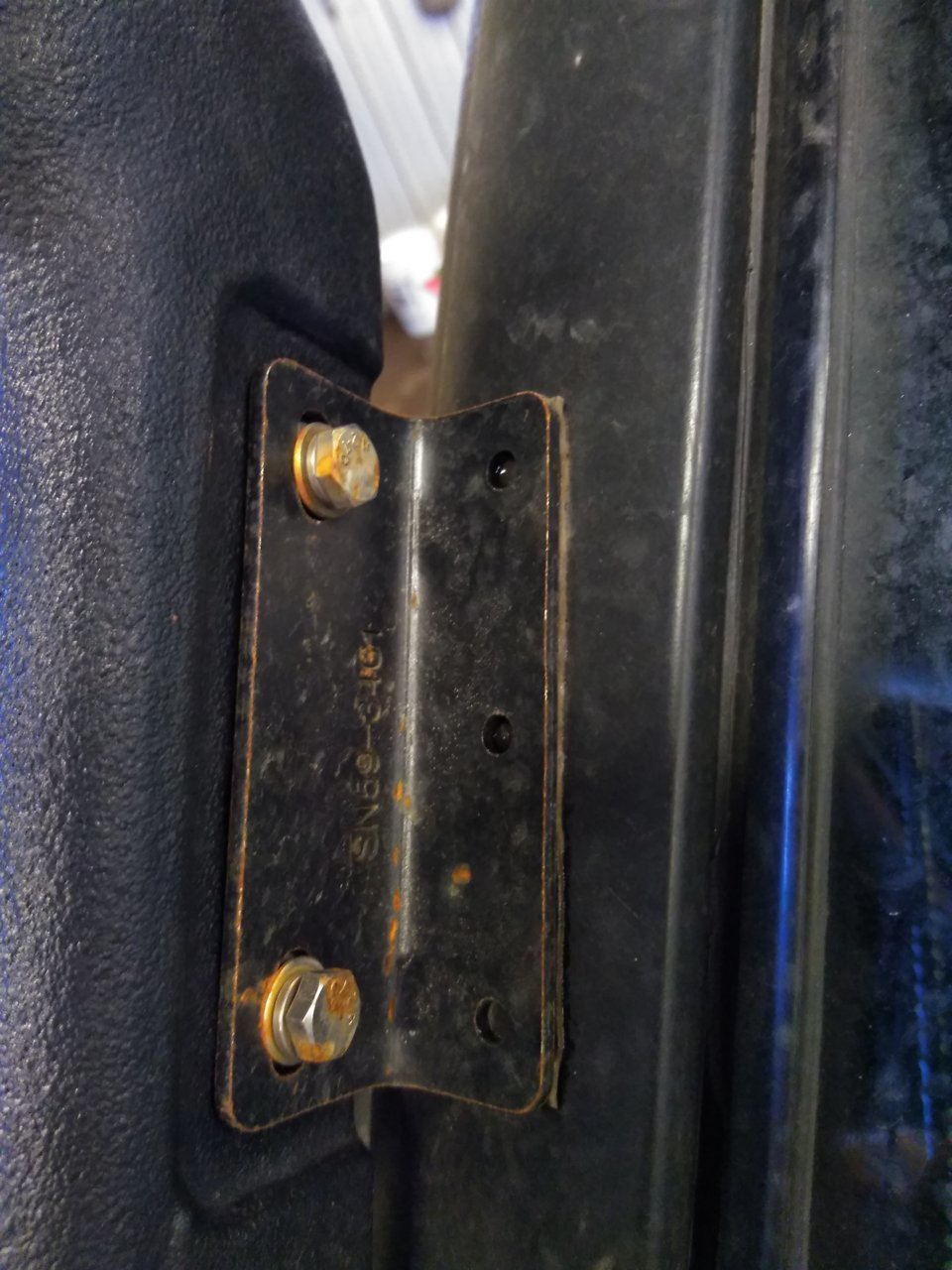

    I don't live where they salt and the bolts supplied with my light pods from rago rusted out like this. Not a bad idea to go stainless regardless of where you live. Have others noticed this issue as well?
    Biscuits and llamasmurf[QUOTED] like this.

    I believe it was an isolated incident as I haven't had anyone else report that bolt problem to me. It's all supposed to come with stainless bolts.
    CowboyTaco[QUOTED] likes this.
