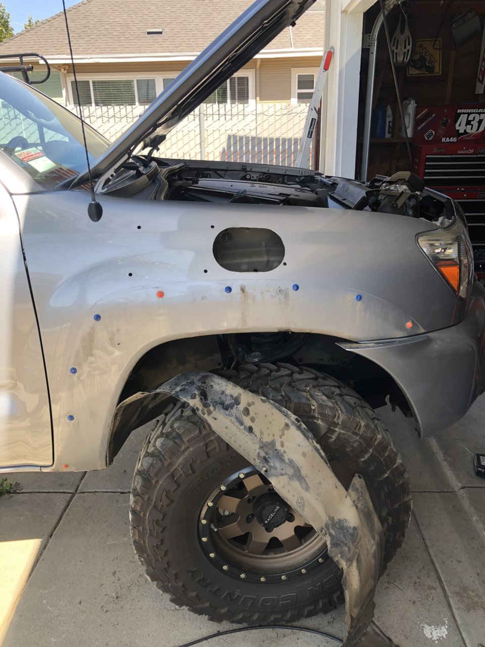

    I just installed mine recently and it went fairly well. I’m very happy with how it looks.
    Fitting the rubber joining piece inside the fender and getting it through the hole into the engine bay and joining everything took quite a bit of wrestling but it all worked out.
    The install instructions didn’t say when and what to use the recommended gasket sealant on so you just have to put it where it makes sense.
    Usually when a product says it’s a 3 hr install, I know it will take a loser like me the entire day with five trips to the nearest hardware store . I didn’t realize a 4.5inch hole saw and drill step bits was going to cost me another $120.

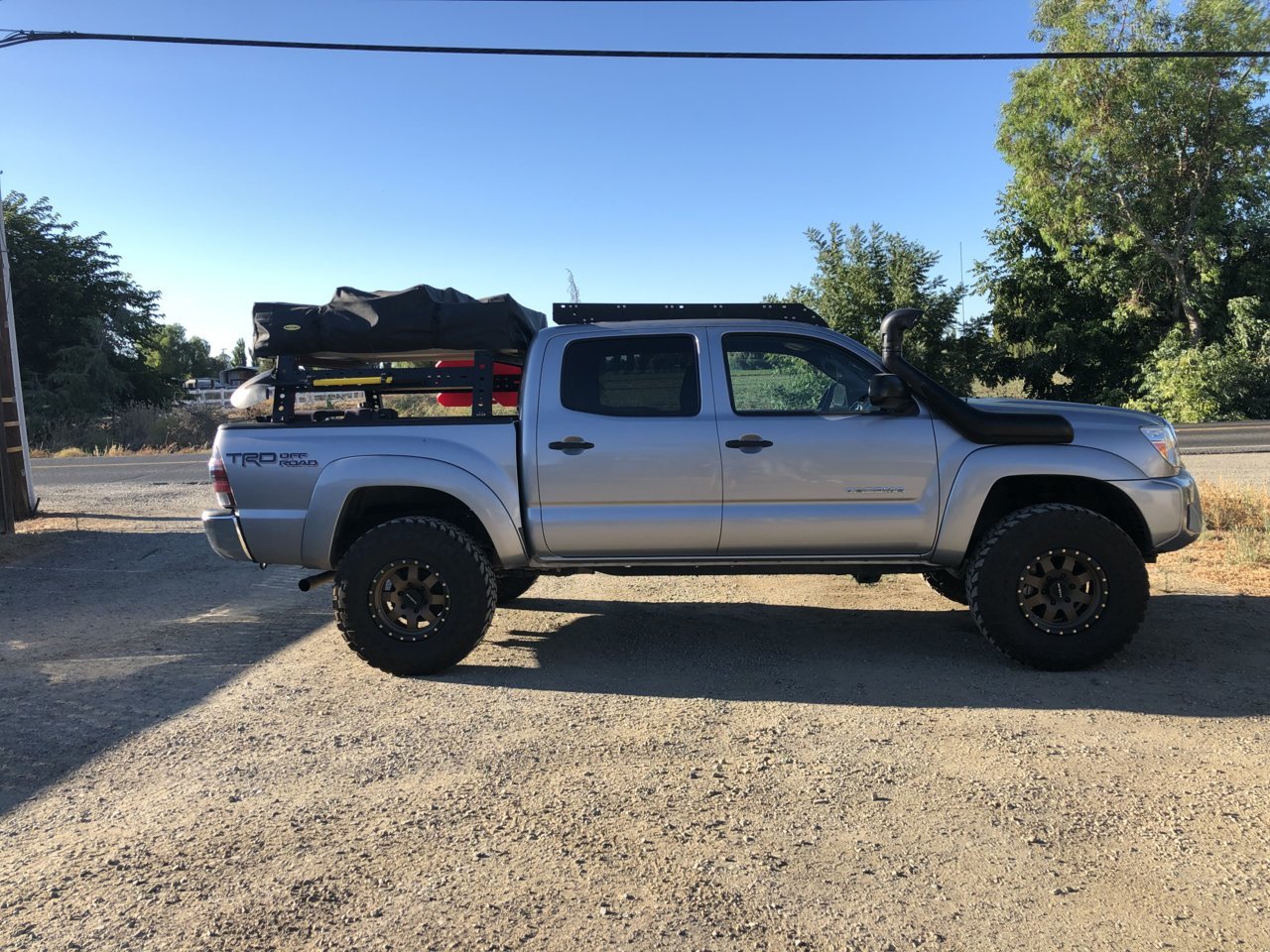

    Got mine all installed, had some issues with the stencil but I made it work.

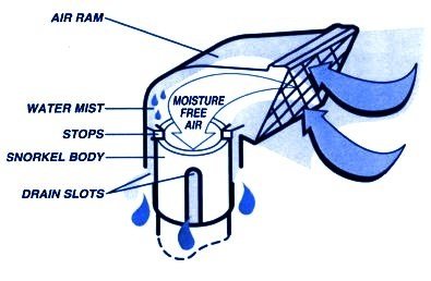

    How do you prevent water from going inside the snorkel like when it rains??

    There are drain holes in the factory airbox. I’ve had no issues with water sitting inside after a heavy rain.

    I’ve checked my air box after an hour of driving in the rain it was dry

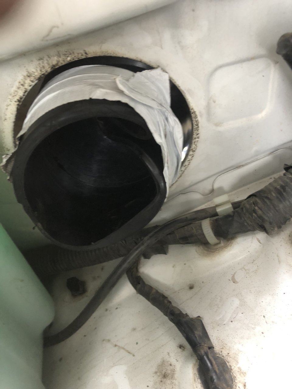

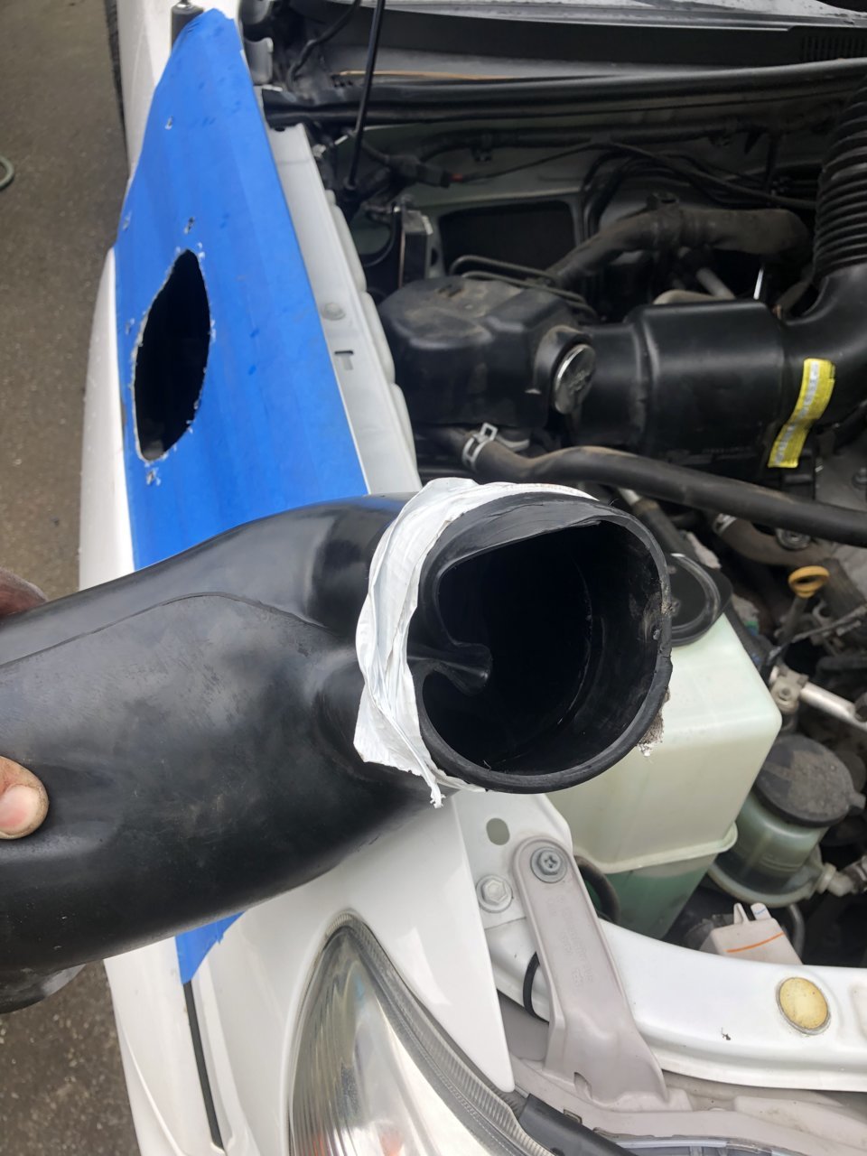

    Front and Rear Locked, 35’s, Chevy 63” swap, Fox Suspension and a bunch of other shit too long to list.
    EA04D9A8-C71B-4037-BEA4-29C0D1383DF4.jpg 3295D1EE-590D-4B5D-AB85-885CD382E7E4.jpg Taping the end all scrunched up and attaching it to the snorkel body first. Then finagling it through the large opening made that part of the install a breeze. Probably took two or three minutes to snake it through. I fought it for a half hour before going this route.

    * Semi pro tip, start the duct tape a little before the scrunching wrestling match.
