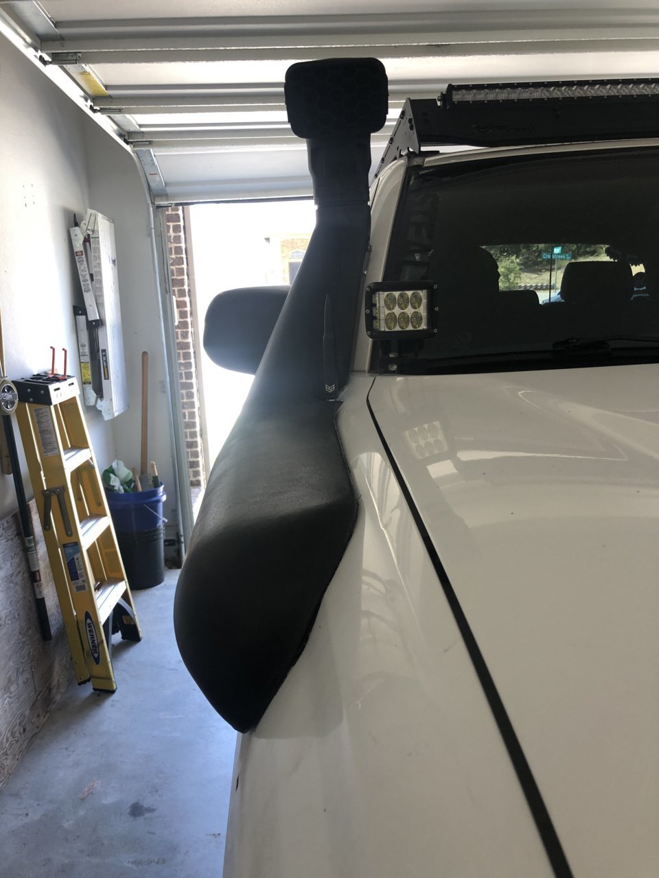

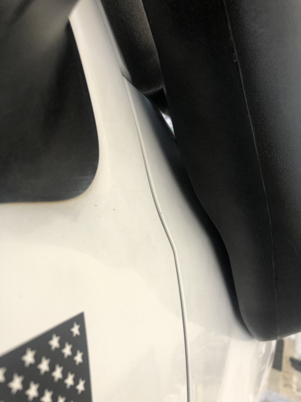

    Update:
    pulled the snorkel off today. Had to widen the holes a good bit but now the snorkel fits much better than before. Still have a slight gap in the back, but not like it used to be. The A pillar bracket sits flush on the A pillar. Holes are close to 1”, so I had to use bigger washers but overall im much happier now.
    CowboyTaco and JKU3000 like this.
  6. Oct 5, 2019 at 3:10 PM
    #306
    Matmo215
    Matmo215 Well-Known Member
    Sep 15, 2016
    #197333
    7,645
    Matthew
    Waco, TX
    2015 Sport DCSB
    Photos of said better fitment
    4F3C5108-0FCA-4A2B-8DAB-D055BE326593.jpg 8DE039F8-5C32-4337-94FB-CBE80C84737B.jpg
