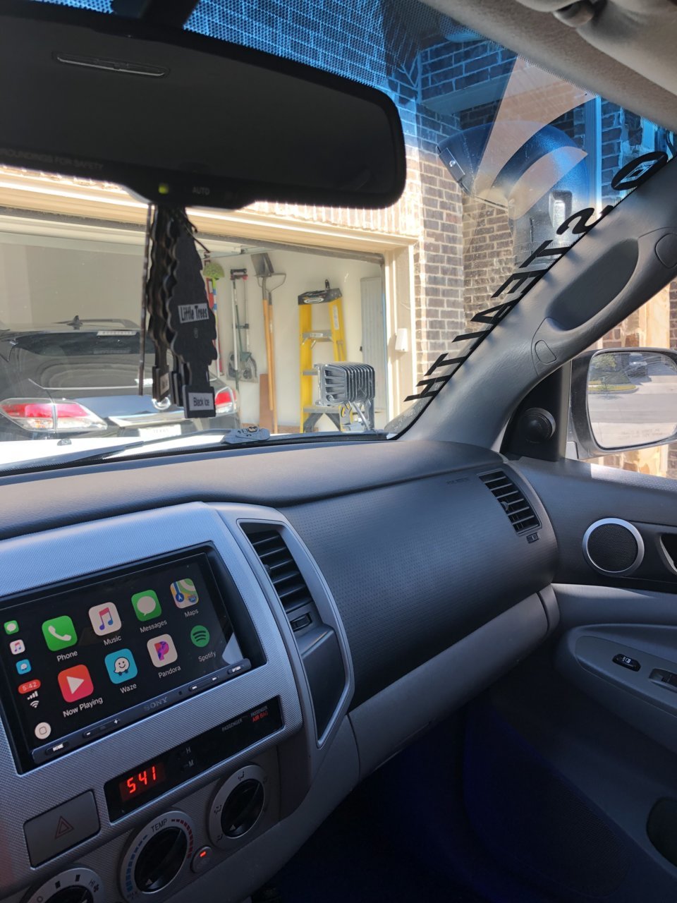

    Just curious, have any of ya’ll had any visibility issues on the passenger side when driving normally on roads?

    I have a photo of it somewhere. You can hardly see it from the driver's side

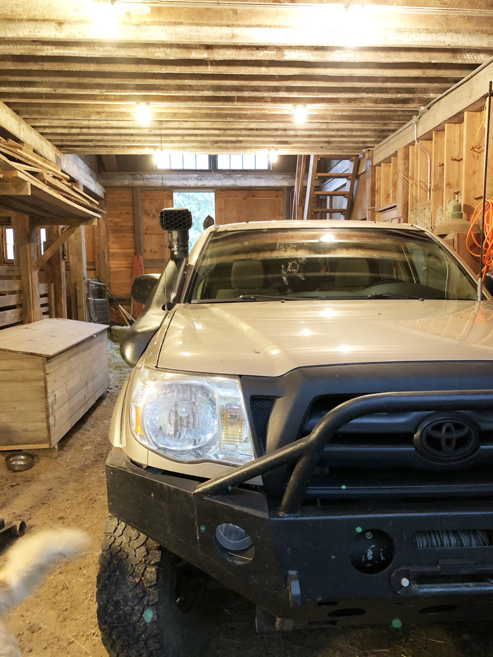

  10. Jan 11, 2020 at 9:26 PM
    #330
    Shadowhunter
    Shadowhunter Well-Known Member
    Mar 24, 2017
    #214241
    4,293
    Nate
    Birdsview Washington
    13’ DCSB MT Sport
    Front and Rear Locked, 35’s, Chevy 63” swap, Fox Suspension and a bunch of other shit too long to list.
    Honestly I forget it’s even there.

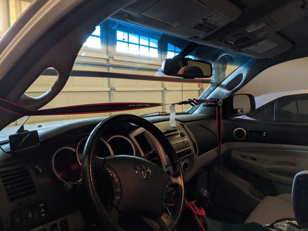

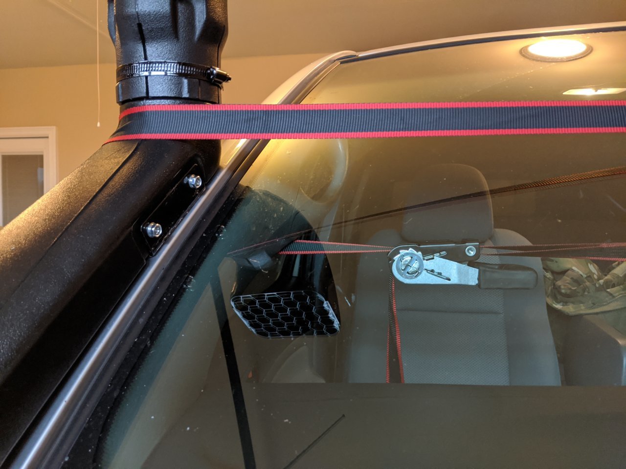

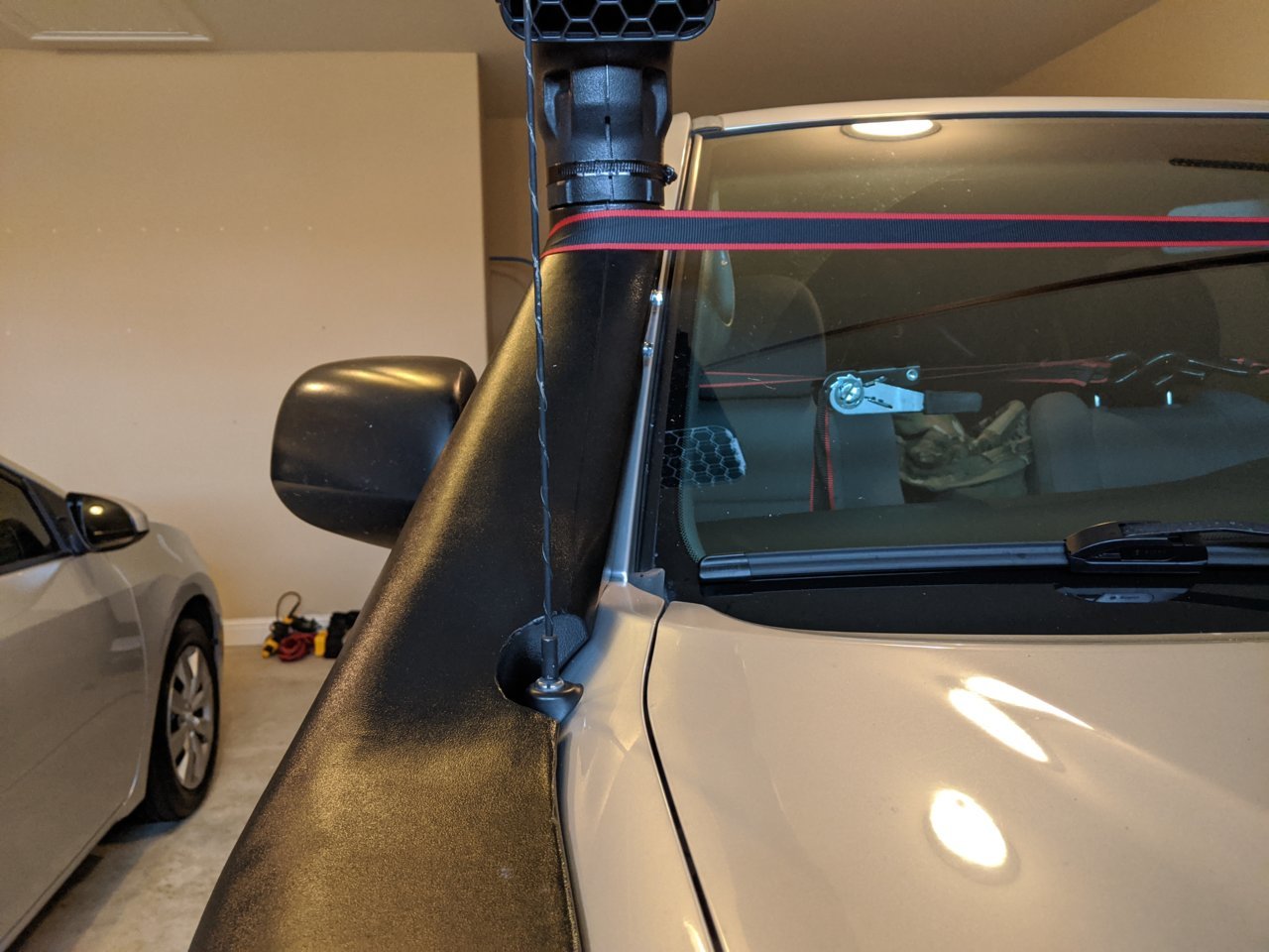

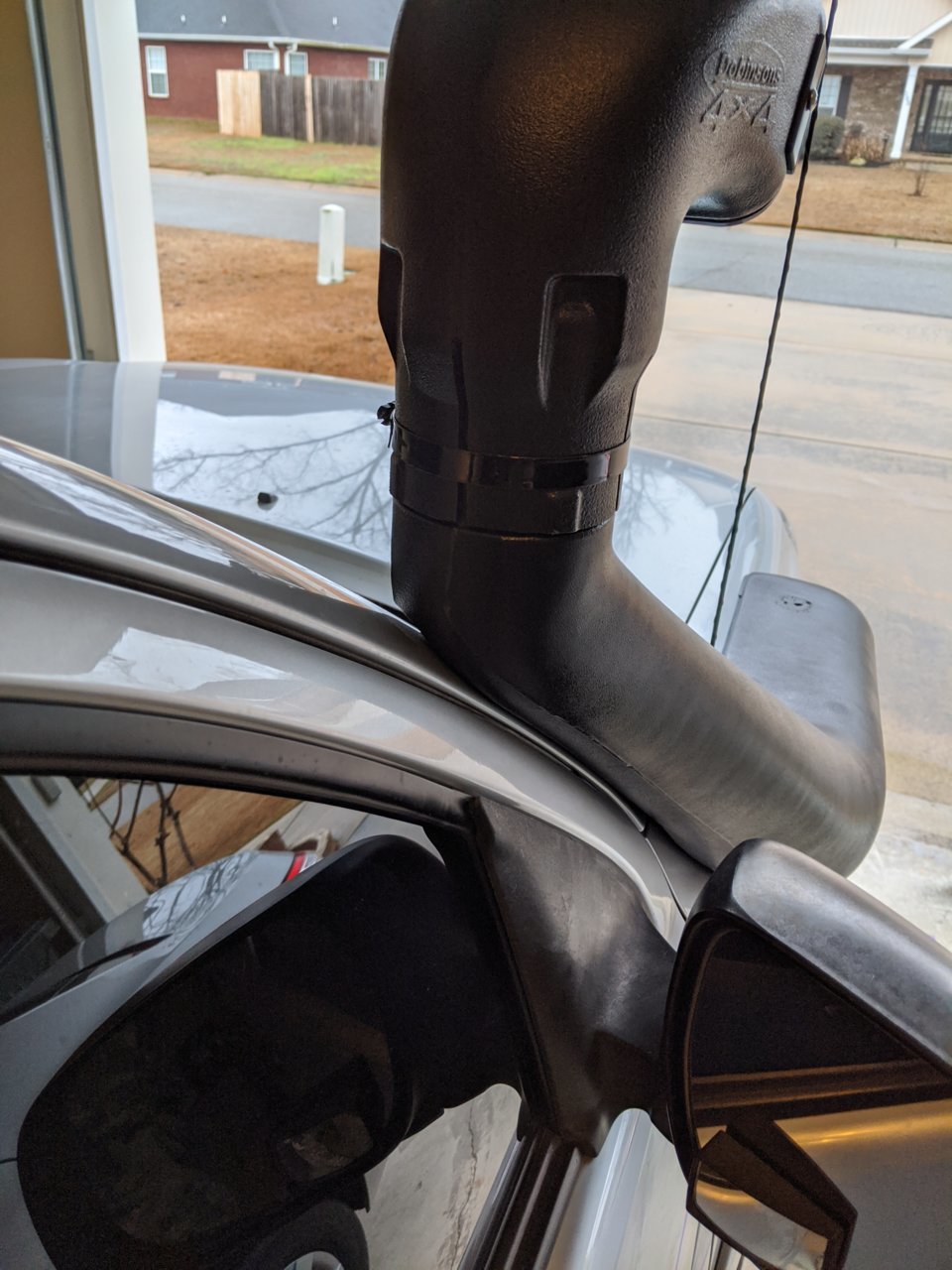

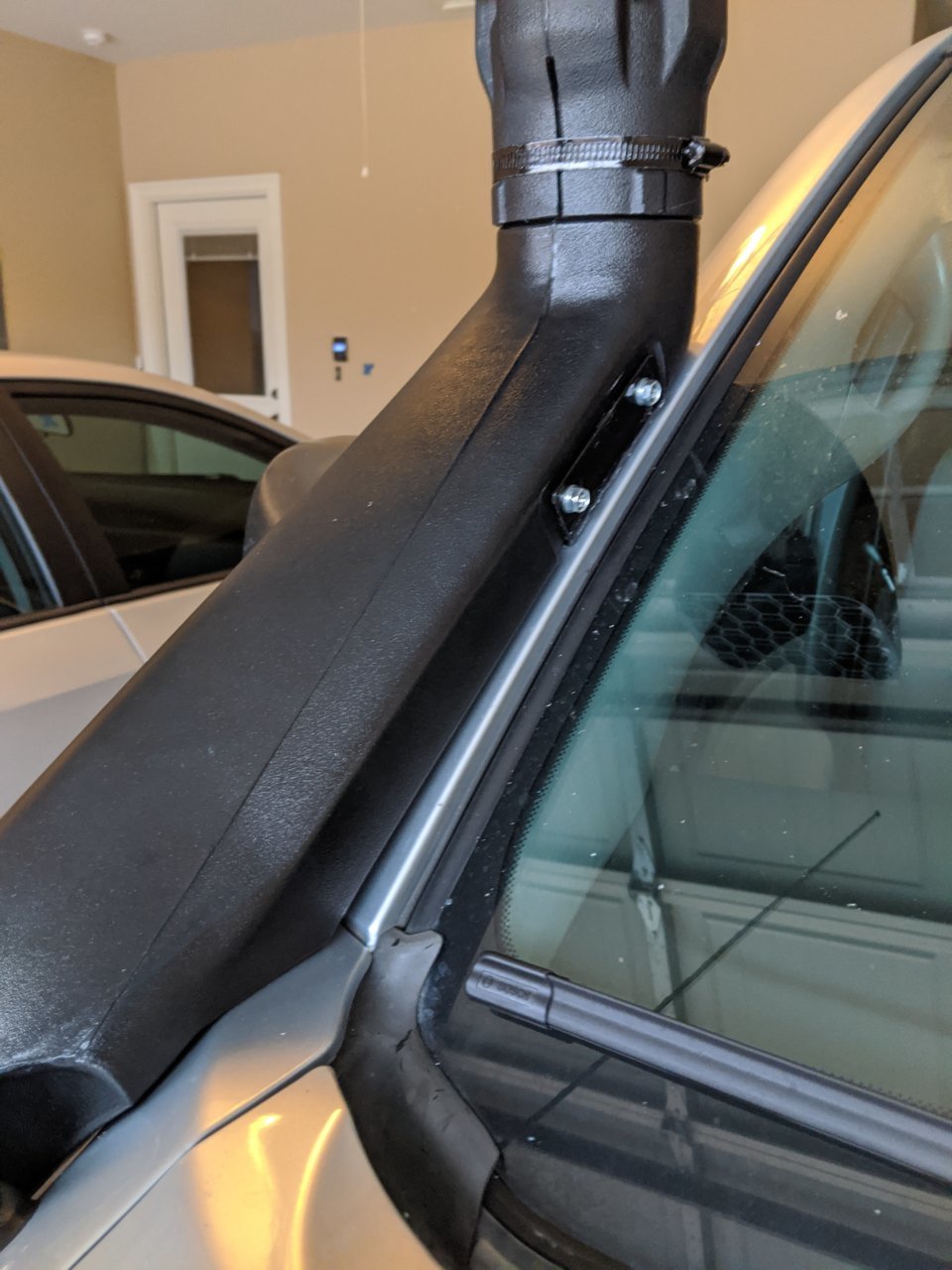

    Finished up my install. Like others have mentioned, my template didn't line up perfectly and I had to upsize all my bolts to varying degrees. I feel like the larger holes in the fender were a little too big, but all my bits skipped a bit before biting down...that may have been operator error. Make sure you get a brush for your paint/primer that has a long skinny handle so you can access the backside of all the holes you drill for touch-up. I'll probably go back in and put silicone over the bolt holes to prevent moisture intrusion/corrosion down the road. I also put silicone on the leading and upper edge of my snorkel to minimize water intrusion, but allow a drain path if water got in. I didn't drill into my a pillar, and instead used JB weld to adhere the upper bracket to the truck. I also put the bracket on backwards due to the way the snorkel fit. If you go the JB weld route, make sure you sand the bracket to bare metal, and rough up your a pillar well for maximum adhesion. The JB weld I used was rated for 5000 ish psi, so it should hold (I hope). I had to use ratchet straps to get the snorkel in place and let it sit for 19 hrs before removing the straps. The gap between the snorkel and truck was at least .75 inches before using the cargo strap/JB weld. Last thing, I have an ultra gauge and regularly monitor intake air temp. Sitting in my driveway at idle, I already see a big difference. I assume the same will hold true at City/highway speeds.IMG_20200112_115627.jpg IMG_20200112_115608.jpg IMG_20200112_115622.jpg IMG_20200113_082846.jpg IMG_20200113_082900.jpg Pics below, enjoy and good luck!

  16. Jan 13, 2020 at 8:52 AM
    #336
    Sirnick88
    Sirnick88 Well-Known Member
    Oct 9, 2017
    #232425
    66
    Nick
    2011 TX Pro, 6spd MT, boosted
    URD mk3 s/c, Dobinsons snorkel, Ultragauge, Stoptech rotors, TRD ceramic brake pads, softopper, anytime backup camera, anzo black headlights, oh, and vehicle OCD organizers!!!

    I thought that was how it was supposed to be? I mounted mine that way
  18. Jan 13, 2020 at 9:21 AM
    #338
    Crikeymike
    Crikeymike [OP] ExitOffroad.com Vendor
    Oct 17, 2016
    #199985
    2,079
    Jax Beach, Florida
    Yes, it's tucked under the snorkel so you can't see the bolts or rivets where it's attached to the a-pillar.

    Usually the bracket is reversed, but some bending is required to line it up properly. I would've gone that route, but my vice is packed up. Glad I went this route though
