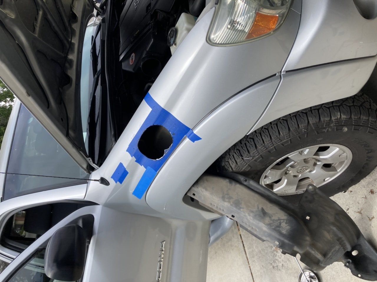

    Thanks! I’ll be mating this to my Volant intake box, so there may be a trip to Lowes to adapt the diameter of the Volant to the attachment hose.
    Ricardo13x[QUOTED] likes this.

    Looking at your pic, I’ll probably remove the wheel to make it less of a PITA!

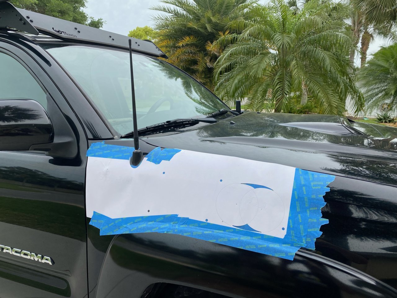

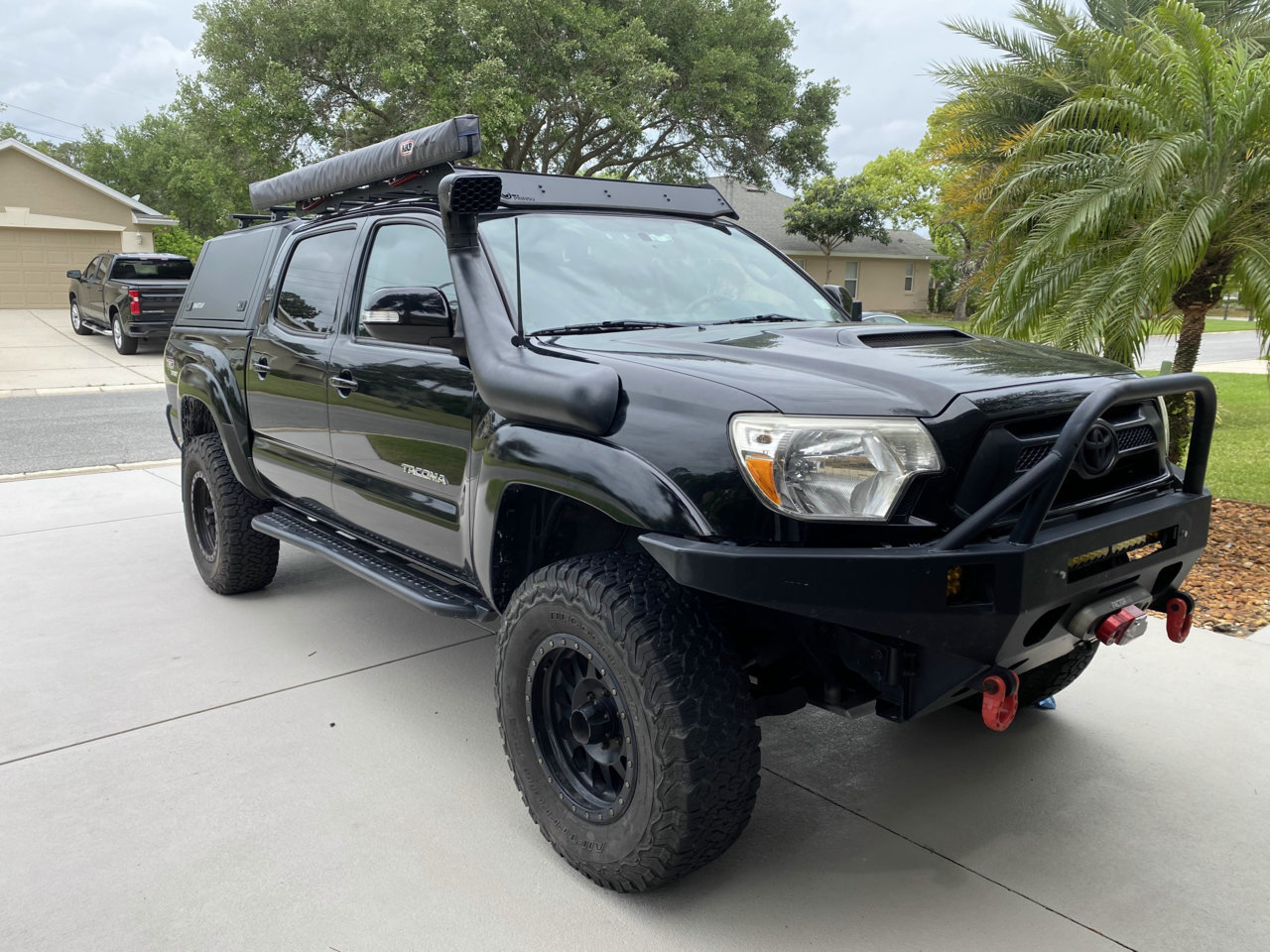

    5 holes on the template. 6 holes on the snorkel. Drilled a seventh in my skull to let out the demons. I had no issues mating the connection tube to my Volant. Didn't use the A pillar mounting bracket as the snorkel doesn't fit "exactly" flush. Doesn't seem to need that to support the body or trunk of the snorkel. Satisfied with it.

    Day late, dollar short. Should be my callsign! 270D25EF-2BC3-4503-88A9-C65E41DD4CAB67044018586__D1B49FC6-C23F-4E96-A6BF-4F478F353431.jpg
