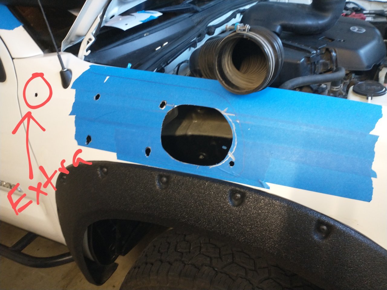

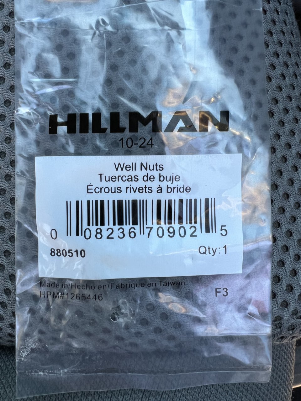

    Well, installed my snorkel today and what a pain!
    I guess there are still kits out there with the wrong template...mine being one of them :/
    I herd the template was fixed so I followed the instruction as is and the holes where about 3/4" off and I have an extra hole that isn't covered by the snorkel body. The template was also missing the holes for the two 114mm holes.

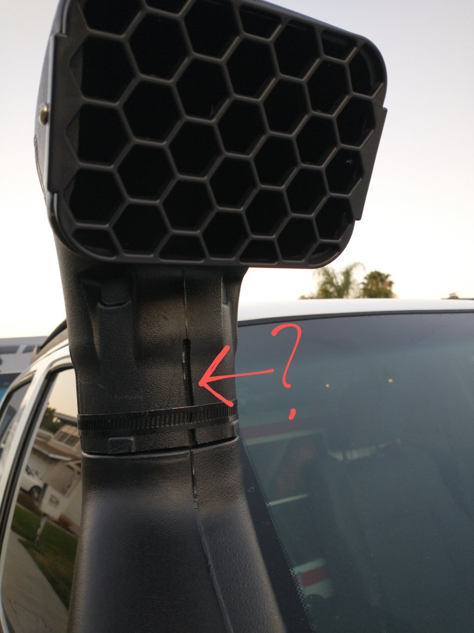

    Does anyone know exactly how water if separated at the snorkel head? The pictures show it leaving out the vertical slits but mine are completely closed. Wondering if mine is not completely cut or...?
    UPDATE November 19, 2022
    I have a few thousand miles on the snorkel now and it’s still looks like new after several muddy trips and being sand blasted on a very windy sand dune trip. No road noise at all.

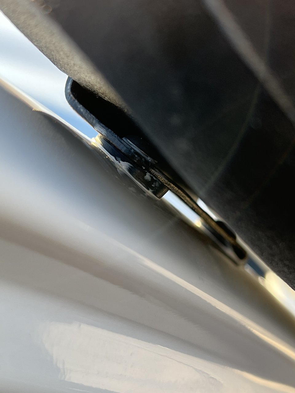

    The 3M tape I used to stick it to the pillar gave up in the hot socal sun. I have since drilled the pillar and used 2 brass well nuts and a little bit of white Flex Seal. This set up is rock solid and totally sealed. I highly recommend skipping the rivets and using the well nuts (see pic)

    The gap seems correct. I remember when I did my snorkel that I was not a big fan of the whole being that big, but at the end of the day it worked out. Something I did is to put in a slightly bigger stainless washers and that was just for peace of mind. Cheers!

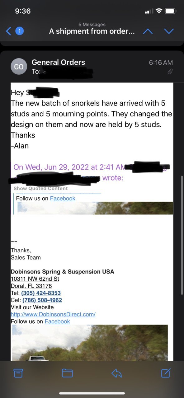

    Just installed mine from dobinsons too. Same exact issue…pretty disappointed. Should’ve just went with eBay to save myself the extra money, especially with the headache with the template being so off.
    Did you happend to receive 6 studs for your snorkel body? I have 6 mounting holes, but 5 studs to snorkel body only. I drilled 6 holes as well. But luckily I didn’t tap the hole by the antenna any bigger than the small pilot hole I started with. Was able to get mine to fit by filing some edges of the tapped holes.

    Emailed them about why my snorkel body has 6 mounting points, but only received 5 studs along 6 nuts and washers. This is their response back to me.

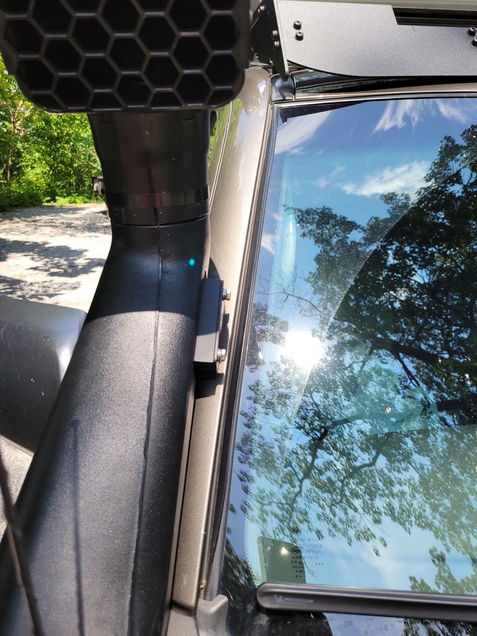

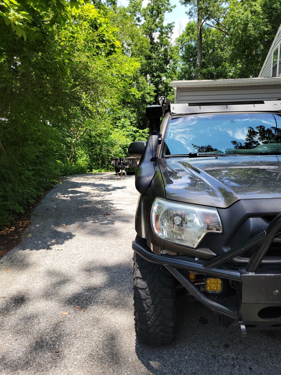

    Installed mine a few weeks ago and for what ever reason it sits about 1" to far from the A pillar for the bracket to make good contact. I had a few 3/4" plastic spacers on hand that I used for a few weeks but finally whipped up a better, more permanent spacer. Used a piece of 3/4 x 1" aluminum. Now it makes much better contact.
