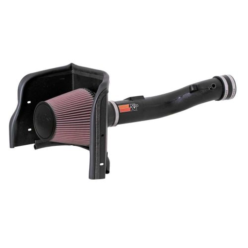

    So will these work with aftermarket cold air intakes since it's just a hose that connects snorkel to airbox?

    A cold air intake usually isn't a cold air intake. It's a hot under the hood air intake, by getting rid of the stock airbox.
    The snorkel requires the stock air box and filter setup to work.
    Edit, this won't work with a snorkel
    https://www.knfilters.com/63-9025-p...2ufARwMJ5txAcoasnc-L74KCjQCW6duxoCDpAQAvD_BwE

    Yes
    I had to do a little trial and error but I was able to plumb my Dobinsons to my aFe intake airtight with some adapters and trimming, etc.
    As @Crikeymike said tho it’s designed out of box for factory intake

    You're referring to the standard K&N or air raid intakes that just put an aluminum sheet around a filter next to the open hole... an actual cold air intake( what I was referring to) uses the stock air intake location and plumbing in larger filter and less restrictive tubing for smoother/ more air flow ( AFE state 2, S&B, Injen, Etc.)

    Incorrect, at least with my Volant intake housing. While I did have to remove the forward “cooler” air intake that was mounted above the width of the radiator and cap that intake hole, the snorkel elbow attached to the quarter panel air intake tube without issue.

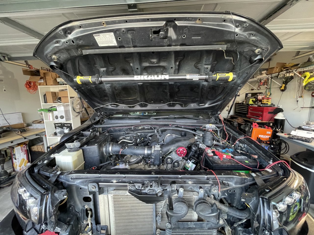

    https://www.tacomaworld.com/threads/cowl-induction-snorkel.525314/ :goingcrazy:
