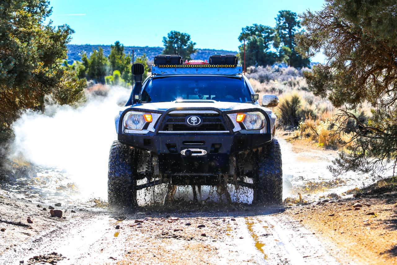

    Rig looks killer!

    Thank you!! Had a fun time wheeling in the snow yesterday

    I appreciate it. I feel weird taking up space with my airflow snorkel on a dobinsons snorkel thread lol. But was just trying to show how you can make fiberglass fenders and a snorkel play nicely with each other
