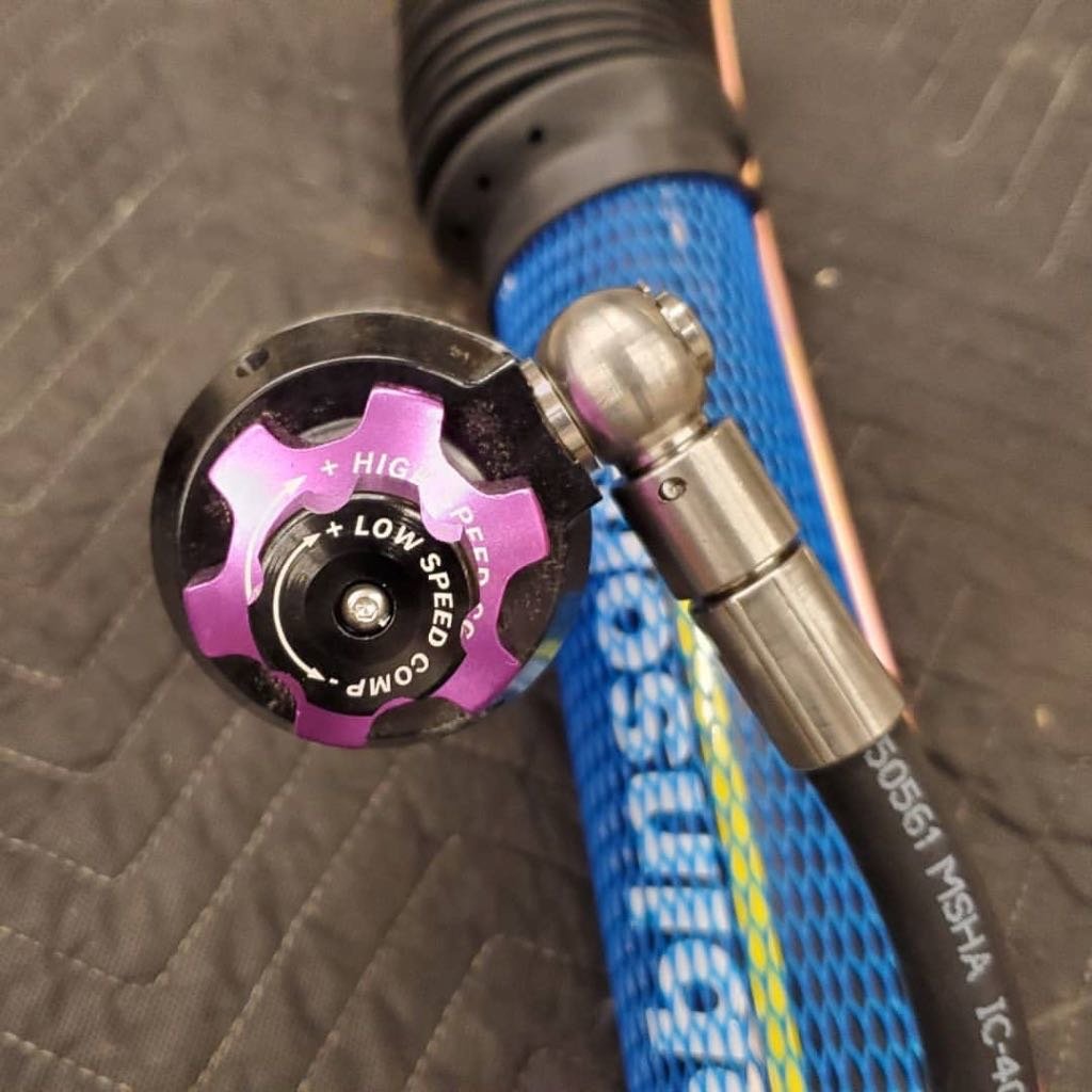

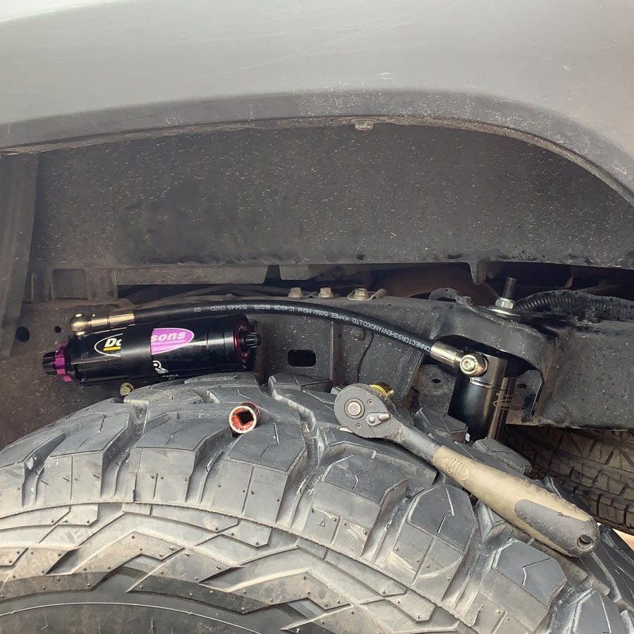

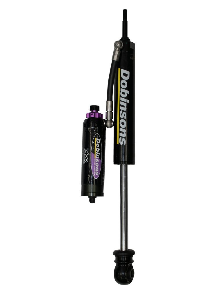

    NEW PRODUCT ALERT!!!
    DOBINSONS 3-WAY ADJUSTABLE MRR (MRA) LONG TRAVEL REAR SHOCKS FOR 2005-21 TACOMA
    • 3-way Adjustable shocks provide maximum adjustability to provide the perfect ride quality for you
    • 10 Stage High Speed Compression – For aggressive, high speed offroading through ruts and holes
    • 20 Stage Low Speed Compression – For creepy crawling and cornering
    • 15 Stage Rebound – Control your coils, prevent bucking
    • 50mm CNC Machined High Flow Billet Aluminum Race Piston
    • 3mm Thick Heavy Duty DOM Seamless 56mm (2.2″) O.D. shock Body Precision Honed to +/- 0.04mm
    • Upgraded 3 Stage FKM‐HNBR Sealing System
    • TSUGAMITM CNC machined components for precise tolerances
    • Parker Braided High Pressure Hoses
    • 5140 HV900 Hard Chrome Plated, Heat treated 18mm Micro-Polished high strength Shock Shaft with a minimum tensile strength exceeding 700MPA
    • Carbon-Fibre/PTFE/Disulphide composite wear band for the ultimate in low-friction, low‐wear performance
    • 60mm Full 6063 aluminum remote reservoir, Lightweight CNC Machined Low Friction floating piston
    • High Quality O.E.M. Grade Natural Rubber Bushings
    • Single Piece Lower Leg, CNC TIG Precision Welded Body End Mounts
    • EDP Surface Protection, Direct Bolt-On Design
    • Fully Rebuildable Design, Full 2 year limited warranty, no set rebuild time period
    • 16.5″ compressed length, 26.9″ extended length
    • These shocks require 24″ brake lines and 2″ bump stop extensions
    Part number MRA59-A941, in stock and shipping now. Current price is $900/pair
    https://exitoffroad.com/product/dobinsons-mra59-a941-long-travel-rear-tacoma-shocks/

    I just took delivery of a set of these and can't wait to get them on for testing. The workmanship is exceptional.

    I'm curious what the exact use case/setup is for these extended length shocks. Are these intended to work with the existing Dobinsons leaf packs and provide extra droop somehow? Would airbags count as extended bump stops?
  20. Dec 11, 2020 at 11:16 AM
    #220
    Crikeymike
    Crikeymike [OP] ExitOffroad.com Vendor
    Oct 17, 2016
    #199985
    2,078
    Jax Beach, Florida
    They're more intended to be sold separately to people wanting additional/different travel shocks than what is out there already.
    A lot of people had been asking for shocks with 2" more down travel and that's what the 941 shocks do, but they're not considered part of the full suspension kit that Dobinsons regularly sells.
