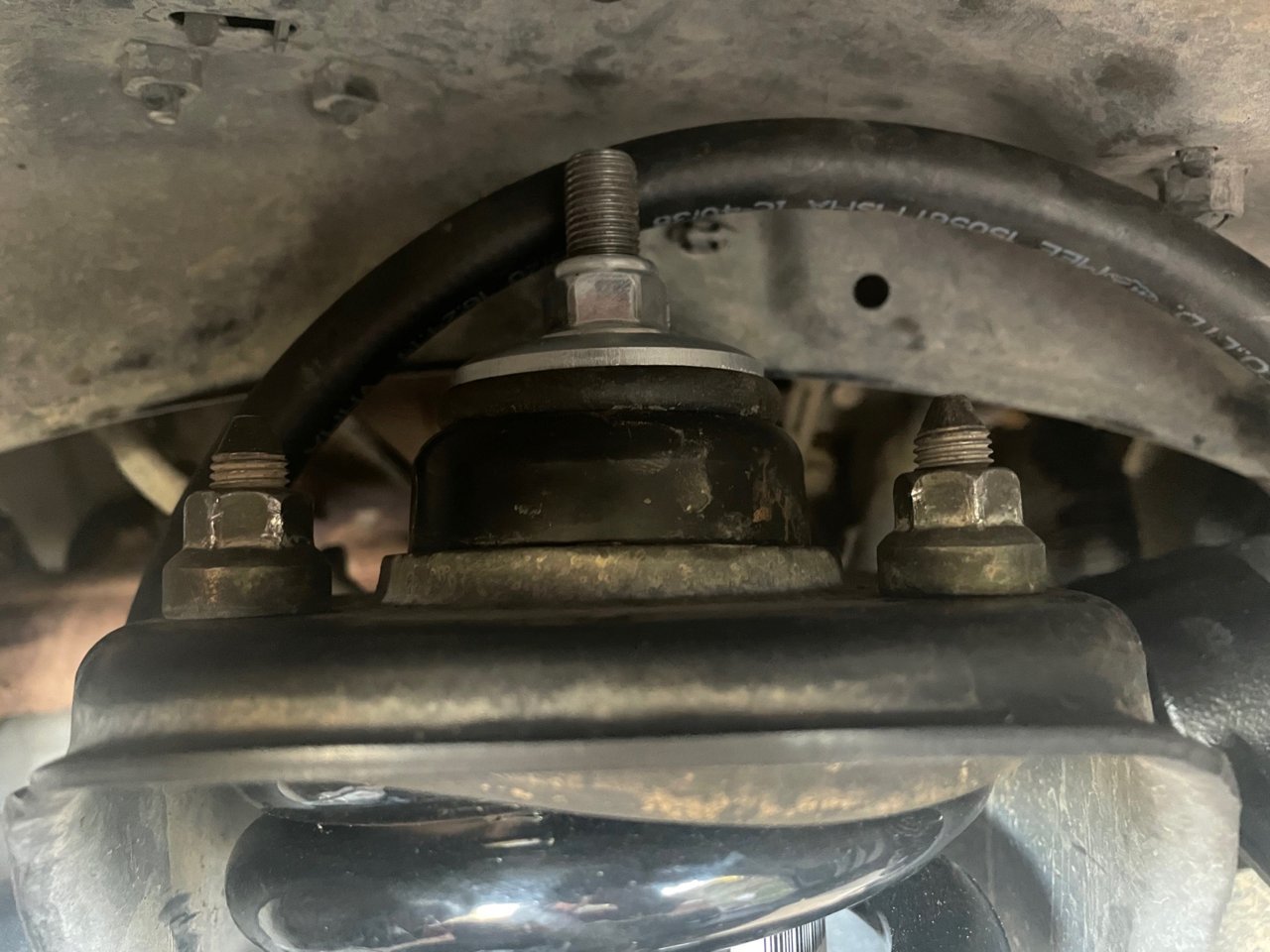

    Install questions: I read after assembling the coilover in the little bag with the adjuster cap that the shock should not be turned upside down during assembly. Handy place for that instruction as opposed to in the install instructions, btw. The other thing missing was that the reservoir hose should exit the shock body toward the engine bay and not toward the tire.
    1. So, I had to pull my coilovers out, compress the spring and rotate the shock body relative to the top mount. In doing so, I didn't realize I hadn't put the adjuster screw back in and I turned it upside down and a rod came out. It didn't come all the way out before I realized it. However, I flipped it back rightside up and removed the rod completely to wipe it down and make sure I wasn't letting any dirt in the shock shaft. Is this a concern?
    2. I noticed when I assembled the second coilover that the protruding thread above the but was significantly more on the passenger side than the driver side (before I did #1 above). The top bushing is also seemingly much more compressed on the passenger side. My understanding was that the nut should be tightened down all the way to the end of the threads and I thought I achieved that on both sides. So, the question is, did I overtighten the passenger side, under tighten the driver's side or screw it up some completely other way?[​IMG]
    Drivers side: (to me bushing compression looks good, the nut seemed to be tight against the end of the threads as I recall)
    Passenger side: (the nut kept turning and seemed to overcompress the bushing by the time it stopped)
    I also noticed that in the Toyota service manual the top nut has a torque value which seemed odd to me.

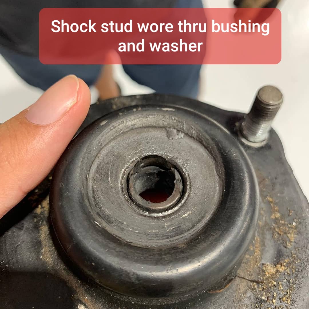

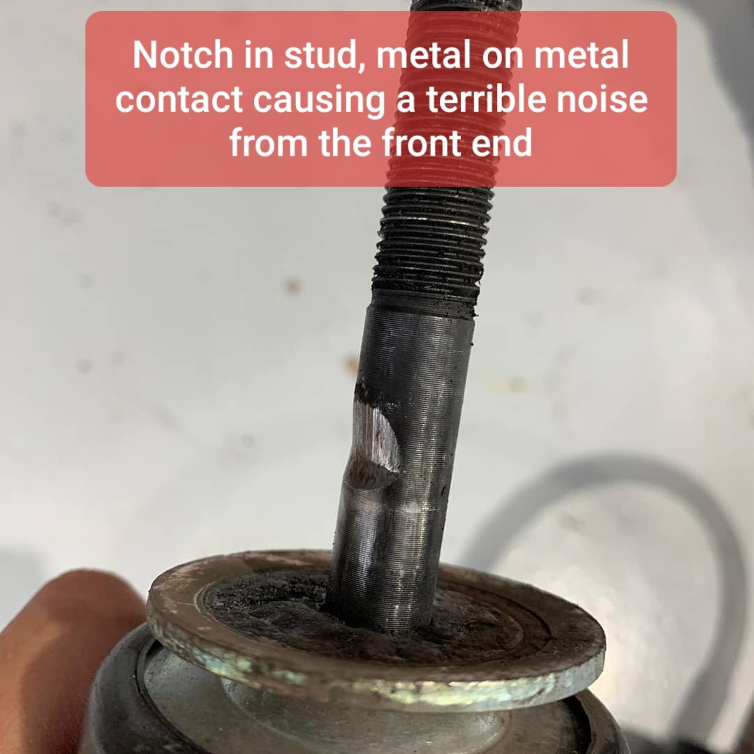

    That rod is the part that actually adjusts the rebound. As long as it went back in and the top parts were put in the same order, it should be fine. You'd know pretty quick if that rod wasn't adjusting up and down properly, or if the rebound wasn't being changed by going all the way in and all the way out.
    You could have swapped left and right strut assemblies to have the hose face inwards instead of outwards, without needing to compress and rotate the strut.
    The banjo fitting faces inwards just to restrict the chance of it hitting a moving object, like a sway bar or wheel perhaps. Many have installed it facing the wheel, but also routed the hose properly and it has never been an issue. Be cautious that the hose doesn't rub against the adjuster rings, as they're kind of sharp.
    Yes, the top nut bottoms out on the threads, so if one is longer than the other, it's not all the way tightened down. If it doesn't get done all the way, this can happen eventually (see attached). Or if a washer was missing from the underside, more threads would show up up top too.

    great, thanks! It was just the rod and the grub screw with detent ball, they went back in in the order that they came out.
    Haha, wish I'd thought of that...I was just so demoralized at that point realizing I had done something else wrong that I didn't even thing of that. That and it was the end of the day.
    Copy that, I didn't reinstall the swaybar with banjos out, because I think it would've rubbed. And I noticed that the adjuster rings are very sharp indeed.
    Ok looks like I get to try this again. What do you think about jacking from the lower control arm and tightening the top nut in place...good idea or bad idea?
