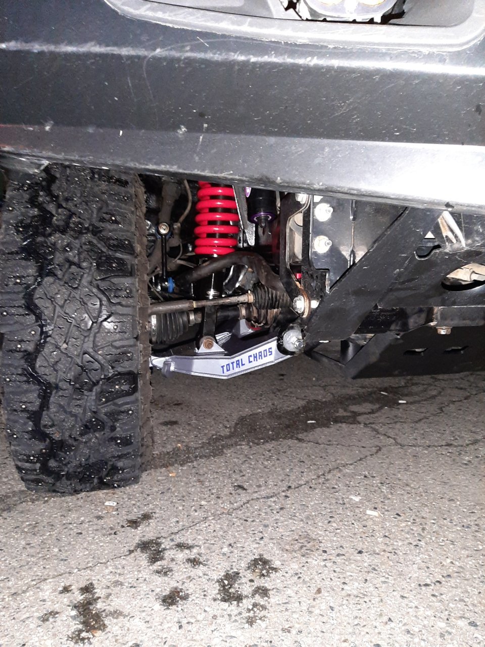

    Dobinson mrrs Deaver leafs archive garage hammer hangers.
    Looks sick. I'm installing my mrrs this weekend coming up stoked.

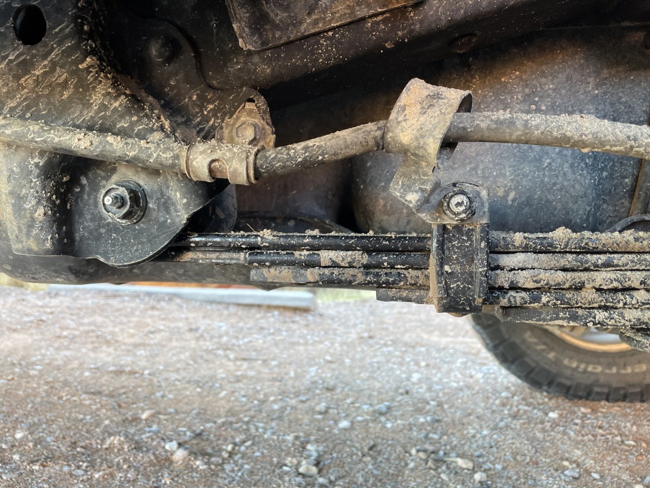

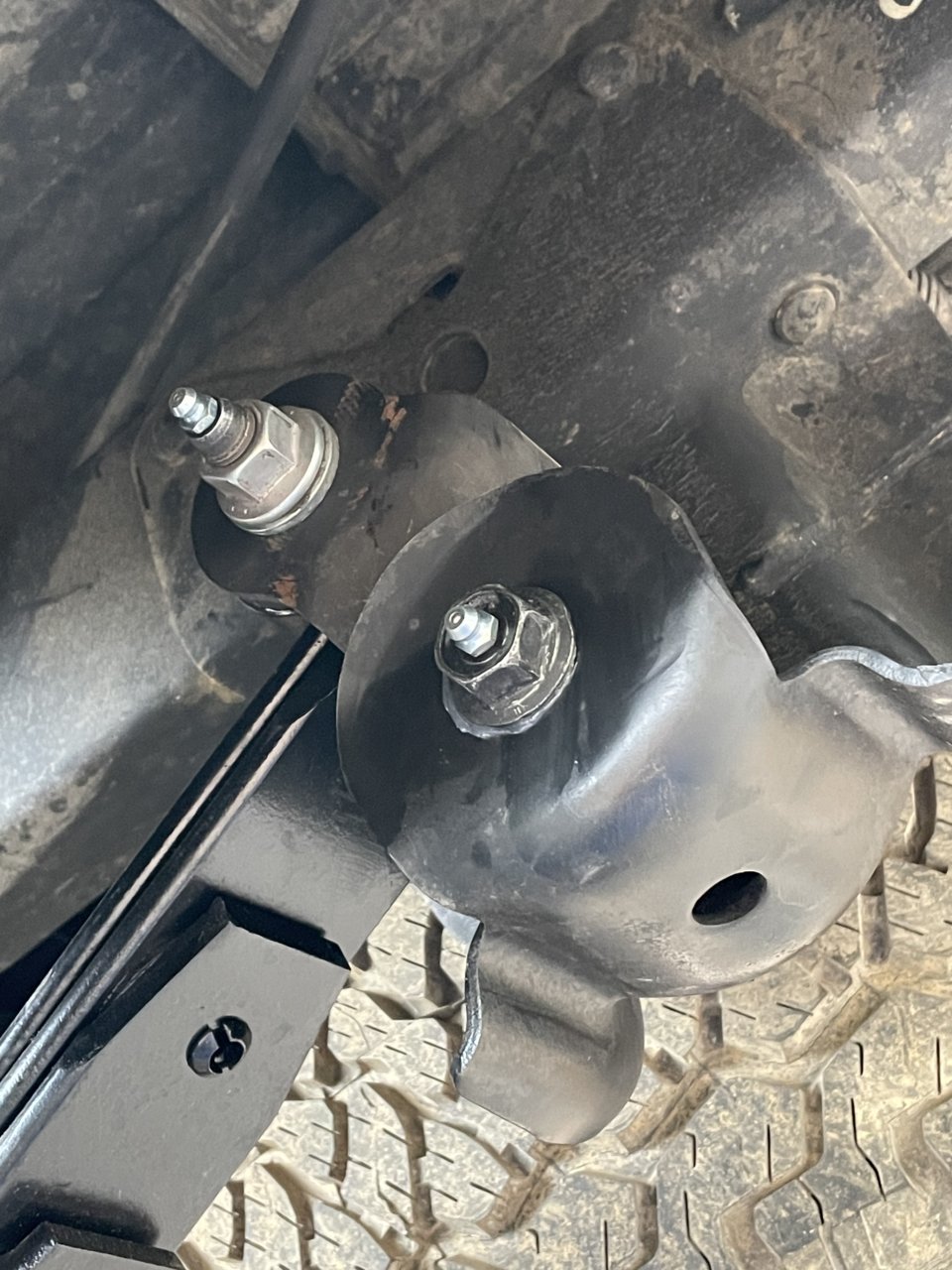

    Made my own greasable bolts so all three are greasable now.
    also, aligned last week in time to get em dirty this weekend:
    Also, if you’re doing springs make sure your e-brake cable doesn’t look like this. The existing bracket doesn’t reach the threaded hole in the spring retainer and if you do what I did, make sure you bend the bracket for a smoother transition. Honestly you can probably cut it off with some tin snips potentially. At the short distance from the adjacent restraint it’s mot really doing anything. Might also be able to ad a standoff and longer bolt to attach to the provided install point: upload_2021-2-1_19-1-55.jpg
