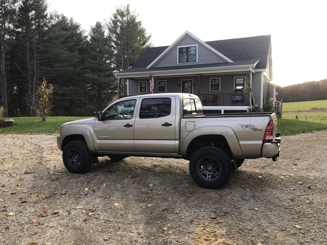

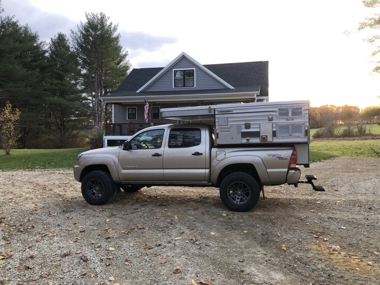

    So I finally installed my 112s. Handles the weight VERY well with my bags at zero. Before with just bags (at 42psi) my truck felt lumbering and unsteady at times. It also made me nervous having all that weight Supported by one point on the frame. Now, I truly could forget my camper is there Suspension-wise. You still know it’s there when it comes to braking though! :rofl:
    I ran the camper for the weekend hoping to see how it settles, but I am thinking I might remove a leaf, because if I don’t do that then I’m removing the bags, which means I’ll have to buy bump stops. So I’m inclined to continue running bags since I own them, and remove a leaf to improve the unloaded ride, reduce the unloaded rake, and also fix the new driveline angle issue. Ideally I’m looking for that happy medium where I’d be running 15ish psi in the bags when I’m loaded.
    Note, the truck weighs 6220 loaded, and 4640 without the camper. So that’s a 1600 lb camper loaded which includes about 30 gallons of water.
