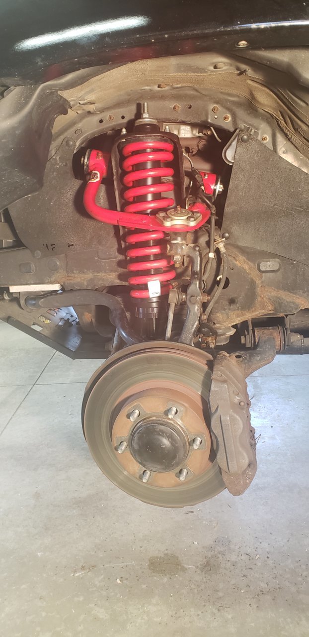

    Just wanted to say thanks. I installed my kit today after it was sitting in the garage since late January.
    I had the Bilstien TRD system on and the Dobinsons system rides so much better.
