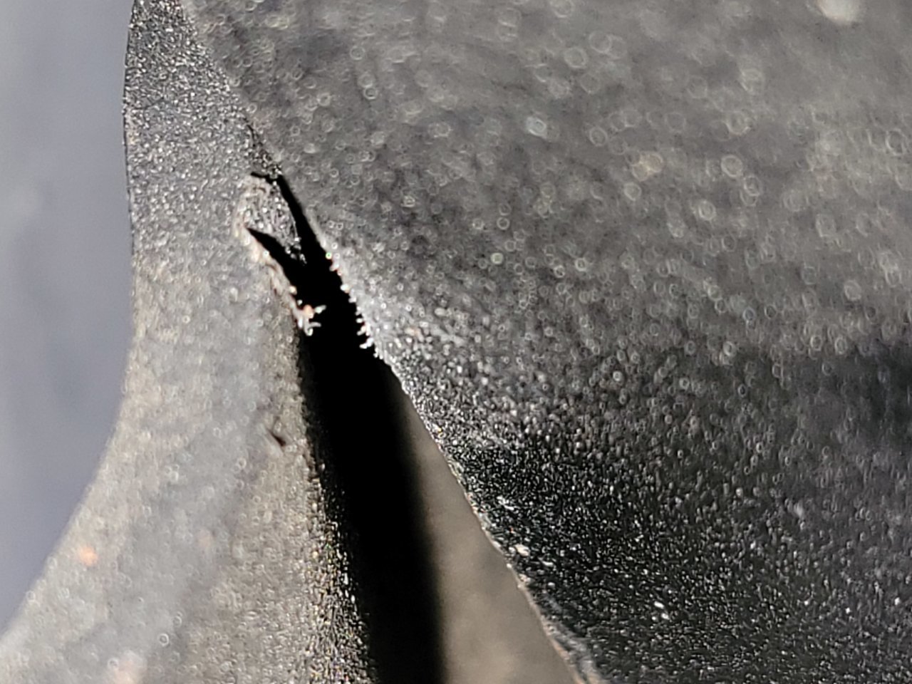

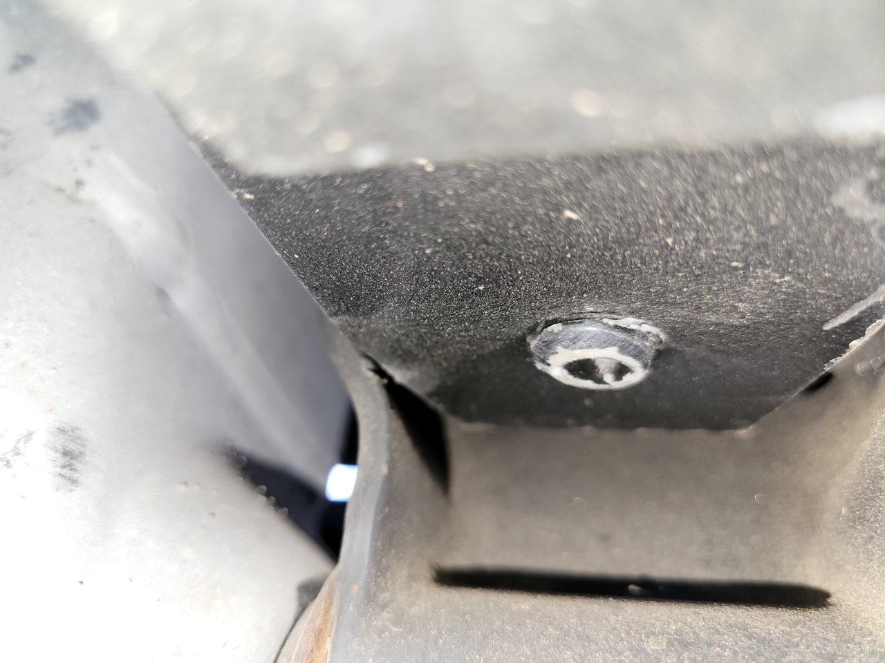

  17. Jul 29, 2022 at 8:00 AM
    #357
    JoshS
    JoshS Well-Known Member
    Aug 31, 2019
    #303869
    267
    Josh
    2014 Tacoma TRD Sport DCSB 4x4
  18. Jul 29, 2022 at 8:51 AM
    #358
    Windigo
    Windigo Well-Known Member
    Dec 21, 2019
    #313884
    4,209
    Farook
    Toronto Ontario Canada
    '14 Acess Cab
    The pictures are too close up for me to even make out what that is
    Sorry did not see it was fro someone else.
  19. Jul 29, 2022 at 1:37 PM
    #359
    JasonLee
    JasonLee Hello? I'm a truck.
    May 9, 2014
    #129454
    12,307
    Jason
    Q322+3C Denver, Colorado
    15 TRD OffRoad
    TRD Supercharger and more.
    This was claimed to be addressed with the “new” leaf packs, but is still an issue. I was bummed after waiting for the new fixed ones only to receive the same thing as you.
    Also, bought a full set of greasable bolts but they don’t fit into the frame mounts. Gave up after a half dozen calls and e-mails with Dobinsons and they sit on the shelf.
    The solution apparently is to cut off a few inches of the second leaf to keep it from entering the shackle. When flexing the axle high on one side and low on the i5er, the leaf springs splay out and dig into the shackle.
  20. Jul 29, 2022 at 3:06 PM
    #360
    Crikeymike
    Crikeymike [OP] ExitOffroad.com Vendor
    Oct 17, 2016
    #199985
    2,079
    Jax Beach, Florida
    Dobinsons is putting together a technical memo to address the leaf springs, as it hasn't been happening to everyone. I'll post it up once I get it from them, probably on Monday.
    In the meantime, adding more clearance from the 2nd leaf to the shackle is probably going to be the best action I can see. Increasing the diamond-shaped taper at the end, bringing the sides in about 1/4" each with a grinder (not a few inches) is all it looks like it would need.
