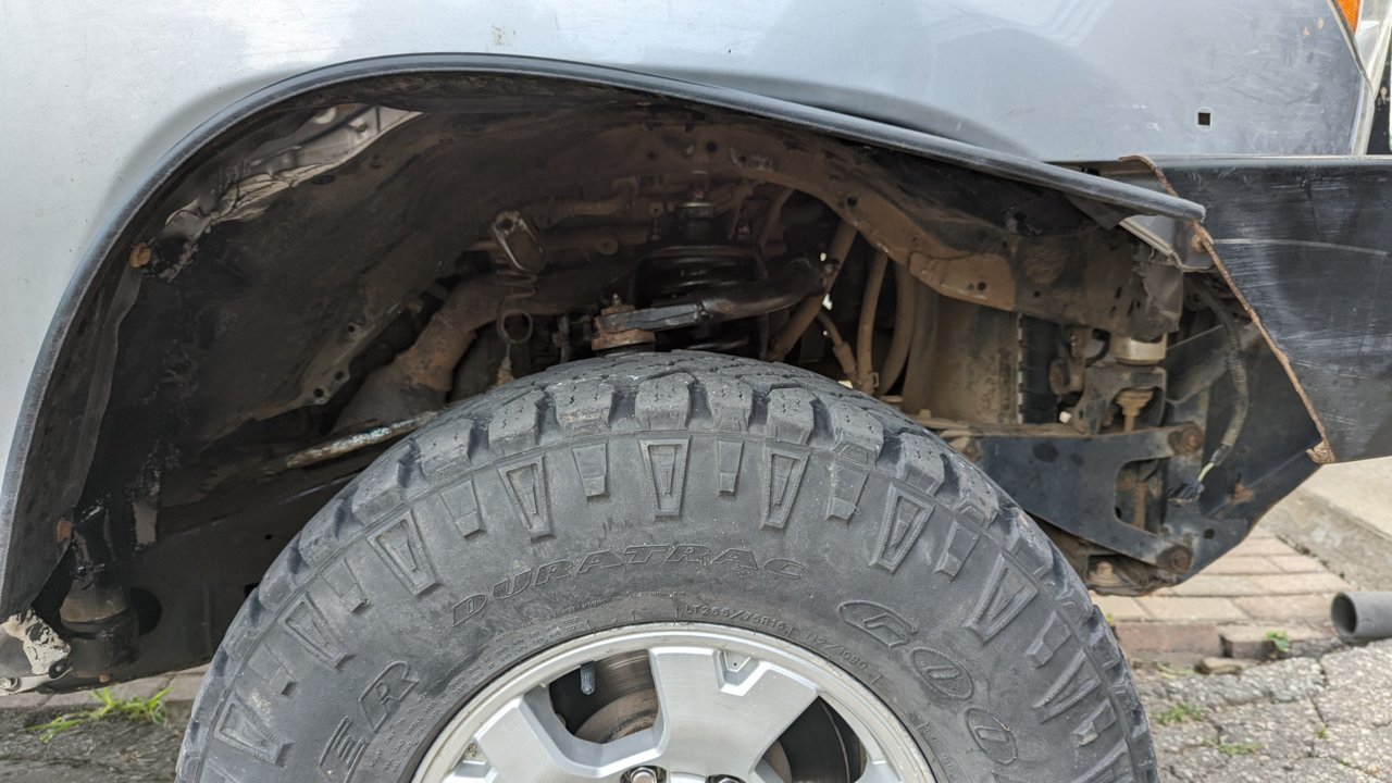

    Here it is. Could be as simple as a clip liner missing (available from Dobinsons), or something else loose.

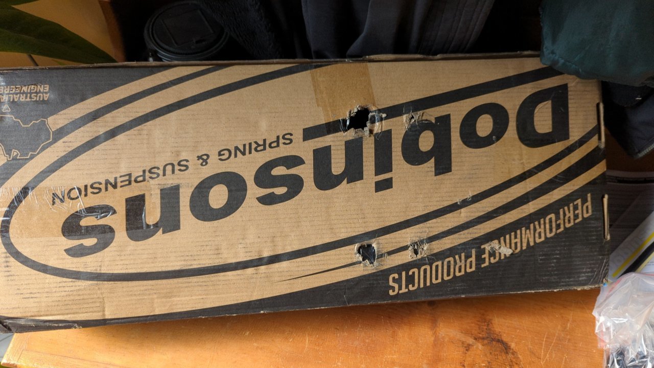

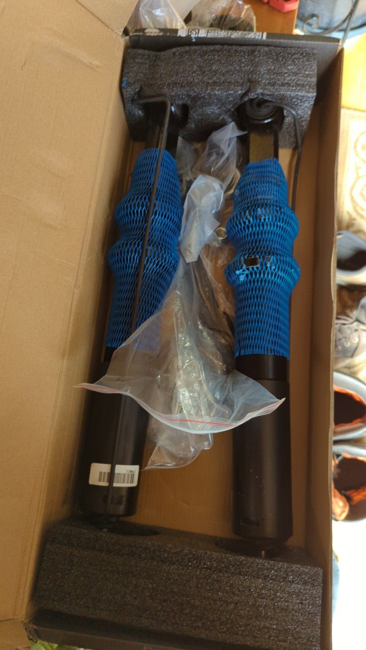

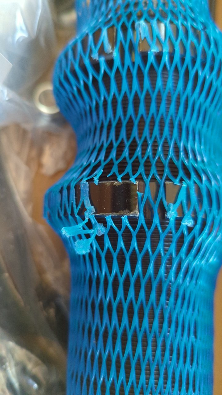

    Well this sucks.

    Could use some foam on top for shipping. But that’s just cosmetic.
    edit: not trying to take away from that sucking, because it does suck when something new is dinged up.

    yea not worried, whatever, its going to get more abuse than that so no problem. it happens.:)

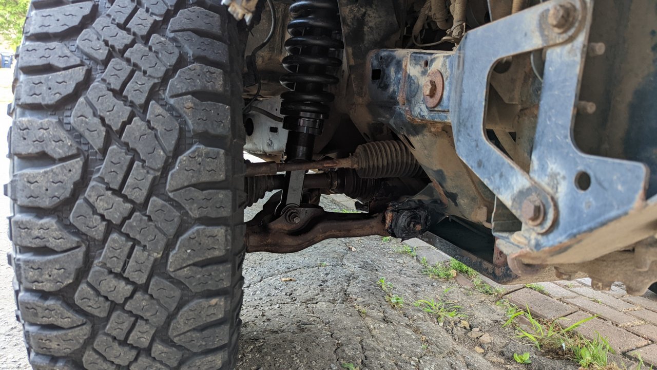

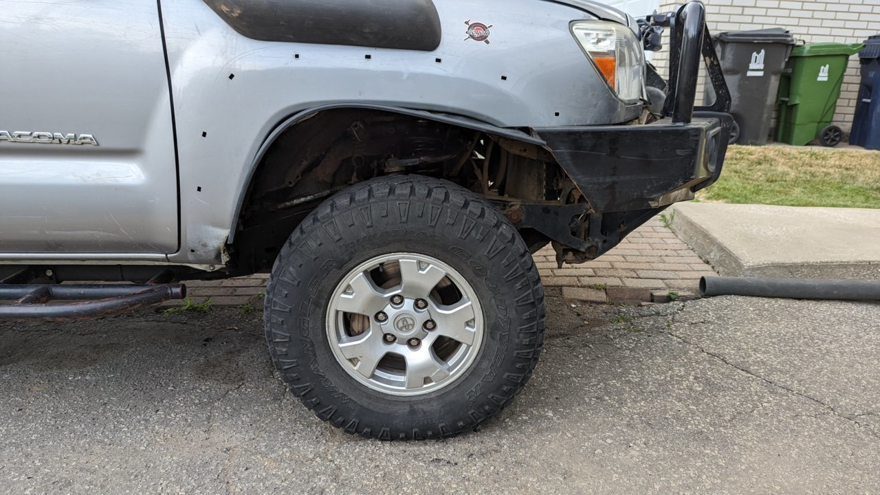

    just an fyi for this thread.
    with the ome 886 springs I set the seat height to 8".
    that gave my uca spc a perfect level position and my cv shaft perfect leval position
    of course it sacrificed lift but that is another topic.

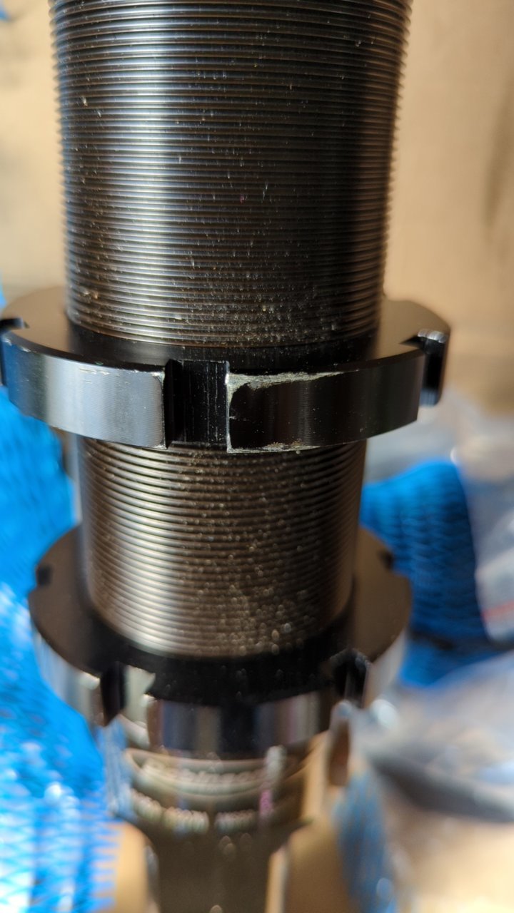

    Just a question I'm sure its hear but could not find it.
    for every turn of the adjuster, how much lift increased of decreased.
    so if I turn the adjuster up 1 full turn how much more lift dose that equal?
    thank you. I thing I heard somewhere or read that its 1/16th of an inch just want to confirm.

    I've never measured it and it's not something I'd use. I would just add height, and it's a 1:2 ratio, so 1/4" added gives 1/2" of lift

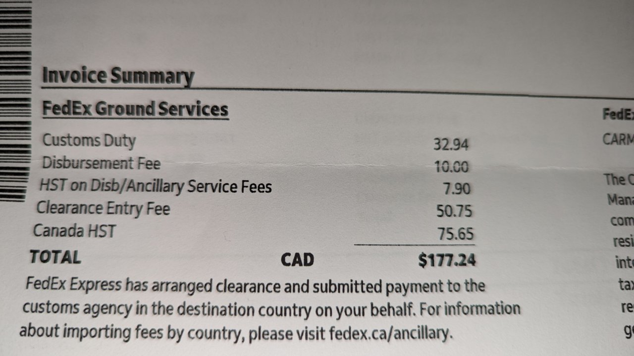

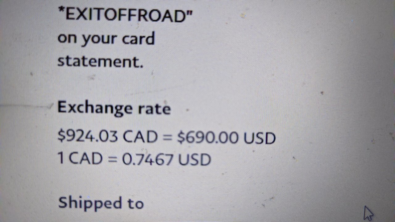

    Just an FYI for any Canadians ordering IMS shocks.
    Nothing bad just what to expect in dollars.
    Around 1100 Canadian dollars to your door.
