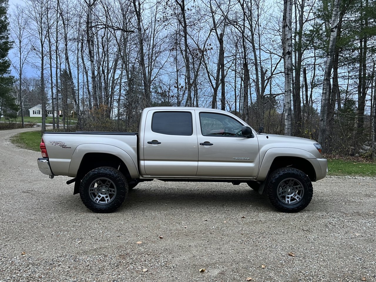

    Anyone with the 314 springs have hub to fender measurements?
    I am ready to do my front suspension now. Looking at the IMS coilovers. Currently running a 112 pack in the rear to support my camper. However Unloaded, with 5100s + stock springs on tallest setting (isn't this a 2" lift?) there is a bit too much forward rake (see post #318) which I think I could hone in with the 314s? I feel like 302s would be selling myself a little short. I have no added front weight and don't plan to.
    I am also considering that spacer on the driver side to fix the tacoma lean, haven't seen anyone else on here mention that. Website says 1/2", seems a bit much at first but I suppose a 314 2.5" unloaded lift, is really a 2" lift on the driver side when accounting for tacoma lean?

    Just to update this...I installed my pre-assembled IMS+coils, ordered as a 2.5" lift on stock weight. My previous bilstein 5100s on stock coils had me at 22.5" fender height. Based on our previous comments I was inclined to think i'd end up with 22.5 to 23" hub to fender height, but I ended up with 24.5" A lot more than I was hoping for. I know I can adjust this down, but did I screw up somewhere lol? I can't imagine this would settle more than 1/2" right? I mean, the truck looks good! But my CV joint angles don't.

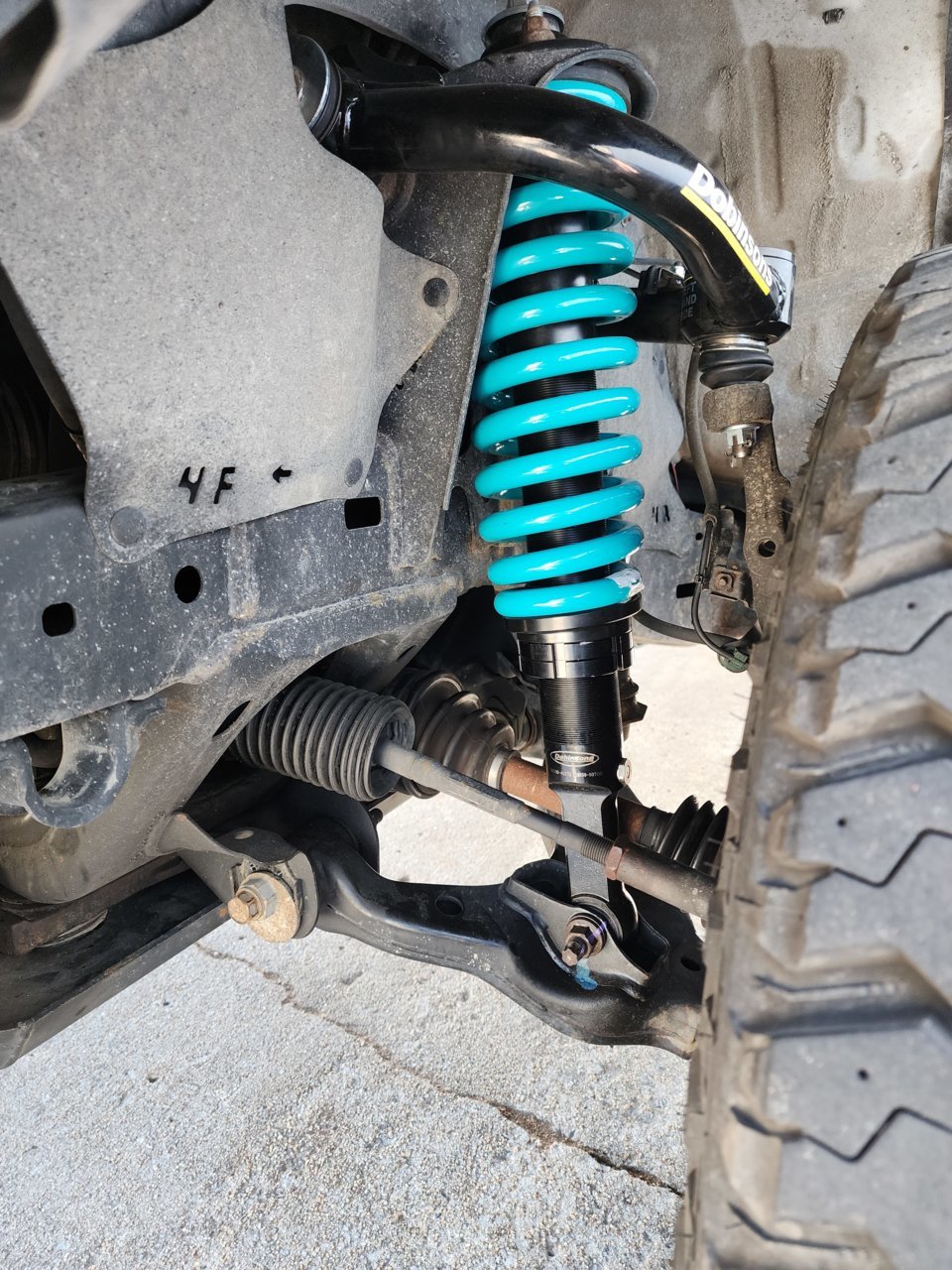

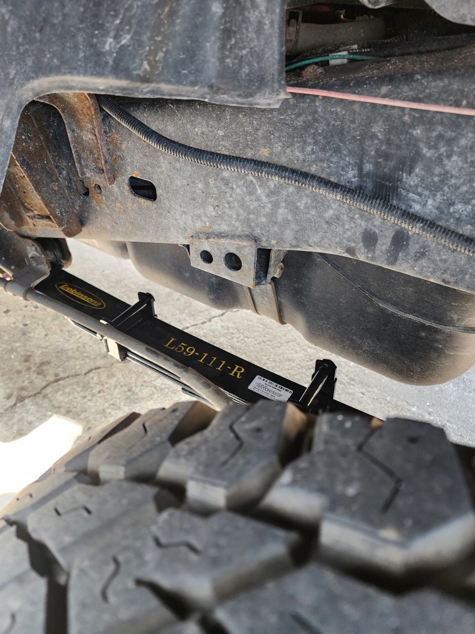

    Got my 3" lift in.

    Which springs did you use in the front?

    C59-354

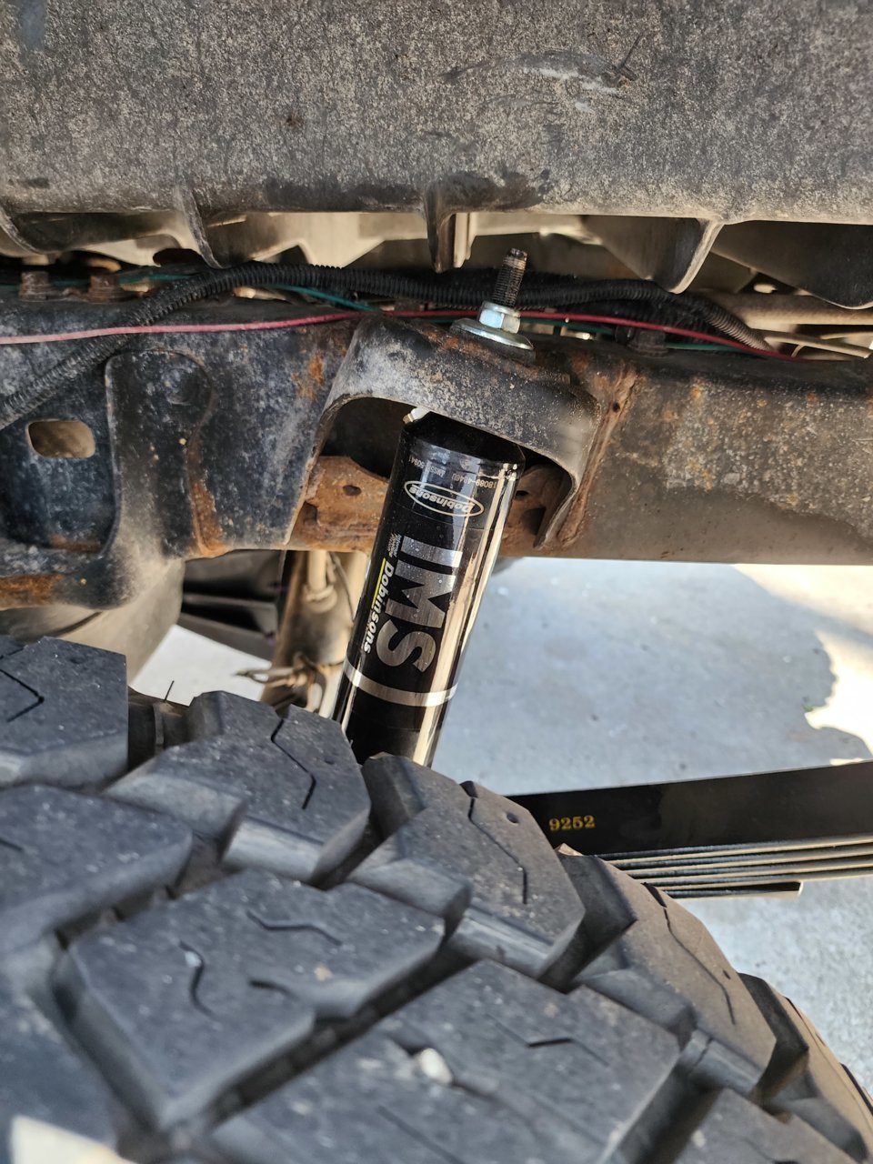

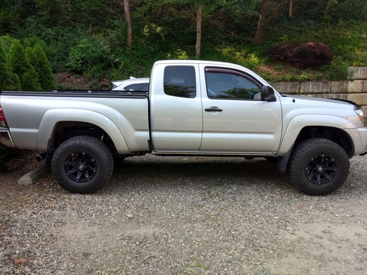

    @Crikeymike got Dobinsons lift installed today. Night and Day, before settling both front 23.5" and both rear 25" all went well but didn't use the extended brake lines.
    Rides great can only get better.
    Thanks for the help.
    Before on slight incline
