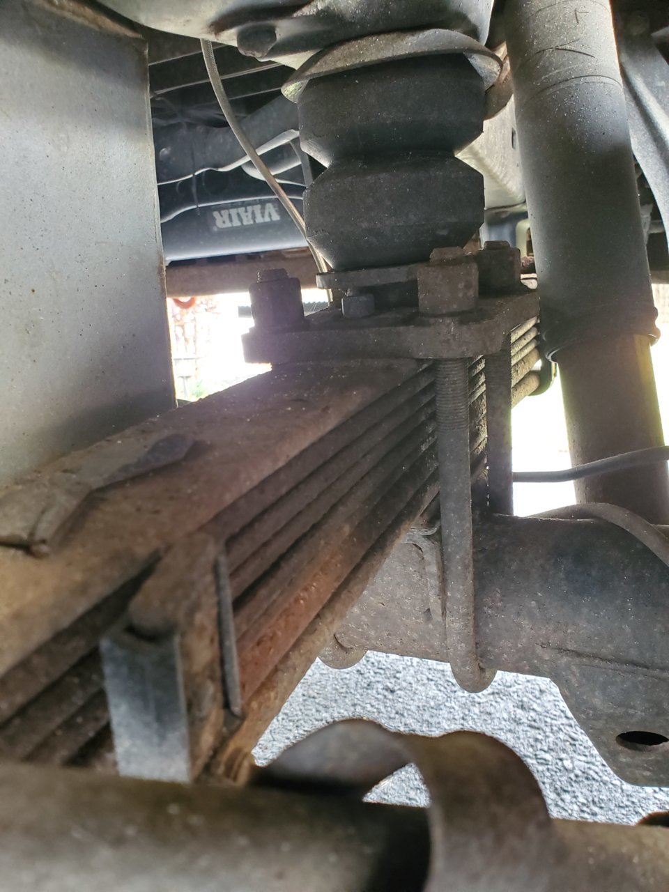

    @Crikeymike - Looking for some input for suspension replacement if you could - 2012 Tacoma, DCLB, it's my DD and camping vehicle.
    Heavy. Steel bumpers, skids, sliders, winch, aux batteries, rear swingouts, 34gal fuel tank, alucab canopy camper with built out interior, fridge, etc. Overall scales at 6,750lb, 3,100lb on the front axle and 3,650lb on the rear in DD trim. Estimate that when on a trip the weight increases roughly 300lb depending on if I have the kayaks. Most of that weight rides on the rear. Attached is a picture for reference.
    I do tow on occasion to bring along the motorcycles and for projects around the house. In general, trailer weight is roughly 2,000lb, tongue weight around 200lb to 300lb.
    I’m currently running OME 886x’s up front and Dakar HD in the rear, with an additional added leaf (7 leaves total) and ¼” spacers/shims. All are high miles, sagging and worn out. The fronts run Wheelers Superbumps, SPC adjustable UCA’s and I am running a swaybar and relocation brackets since putting on the canopy camper. Static ride height now is ~21.5" hub center to fender and CV's are pretty much horizontal.
    The rears have Timbren active bumpstops on a modified axle flip setup. The additional weight added over the years means they become part of my “suspension” pretty regularly. Attached is a picture showing static ride at the rear height in DD weight, 23” in the rear from hub center to the fender.
    What I’m looking for – Springs and shocks that can manage the load while providing a mild lift, roughly 2” to 2.5” over stock, about an 1" to 1.5” more than where I’m riding now. Due to the weight and physical size of the truck, it is not a serious offroader and sees easy offroad at best – usually corrugated forest service roads. Truck spends a lot of miles on the road getting to and from destinations but needs to be able to handle washboard roads once I pull off the pavement.
    A was leaning towards the IMS range - Based on load, I’m figuring I need stuff from the heaviest end of the spectrum. Planned the IMS59-50220 struts and C59-354 coils and hoping that I’ll be able to adjust preload to level ride height. Rear would be the L59-112-R leaves paired with the IMS59-50940 shocks.
    My concerns are the C59-354 coils could be “light” for my setup. I do not want to over coil or bandaid via preload either – when I first did the 886x’s on the OMEs I was lighter but found them unable to manage the spring rate on rebound. For quite a while they would top out over bumps which was unpleasant at best – this eventually went away though I don’t know if it’s because I added weight or the coils sagged, or both. I recognize that heavy weight, heavy coil setups that are not mid-travel or more are likely to face this issue when trying to get 2+” of front lift as there is only so much down travel to be had in the shock.
    - Any input/advice on a product combination that may fit my scenario?
    - I saw the MRA front’s are available with the C59-318 coils but didn’t see them for the IMS – how do the 318 and 354 coils compare weight handling wise? For my setup?
    - How do the AllPro Expedition 2.0’s compare to the Dobinson leaf springs?
    - If I do find the leaves lacking, the L59-112-R KIT would be an option for the Dobinson from what I could tell – right?
    - In consideration of the MRA’s having free shipping, the equivalent optioned MRA kit is about $900 more than the IMS setup – might I benefit from the MRA based on being able to adjust shocks for load/non-loaded/towing? (I firmly subscribe to the buy once cry once mentality)
    Thanks!

    354 coils are stronger than what you have now. By no means are they light.
    318 coils are listed for both, but you don't want 3" of lift, so you don't need those.
    IMS59-50220 with C59-354 and your super heavy load should be right at 2" with standard coil seat height. Then you can go up from there if needed.
    The All Pro's are new for us, I haven't yet sold them to someone as heavy as you so I can't give you first hand feedback. They are all made at 3" of lift though, so more than what you're looking for. The L59-112-R should be ideal for you.

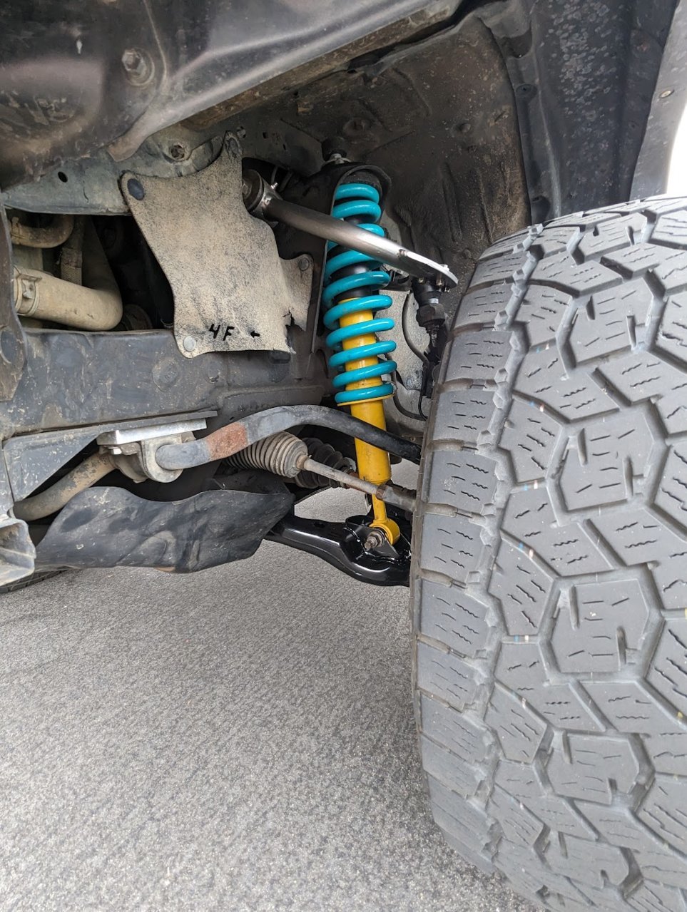

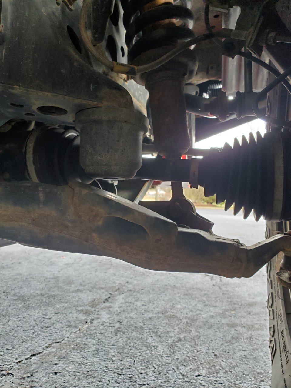

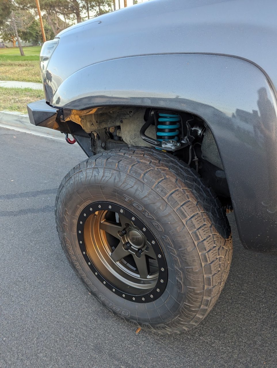

    After 11 months and 5K miles with my new Dobinsons setup, I want to share my experience because i) the truck drives so poorly and ii) maybe you can help
    2012 Tacoma DCSB with Pelfreybilt steel bumper and 285 tires
    Current setup: Dobinsons GS59-220 struts + C59-352 springs + 1/4" spacer on each side
    I installed Sept 2022 and first impressions were that it drove marginally better than my 50k worn out OME setup. I lost ride height so I added the spacers.
    It continues to drive badly, so last weekend I installed new LCAs + bushings + ball joints and upgraded to JBA UCAs.
    Got it aligned by a reputable shop and I can't believe it still drives this bad. The plastic road reflectors that sit between lanes jar the cabin. Speed bumps and dips create more shaking than dampening.
    Exit Offroad helped me choose the parts and gave me a nice Tacomaworld discount but the post-mortem was tough luck.
    With the front suspension components that contribute to ride quality being all new, I am still no better off than I was before with my OME 90000 struts + 2886 springs.
    I cannot recommend Dobinsons for these reasons, but would love to know how you all made it work. Maybe it's the curse of the steel bumper, maybe my Dobbys are a lemon, but wow I am disappointed.
    What am I missing here?
