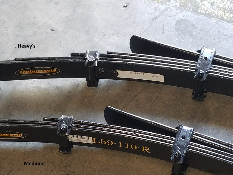

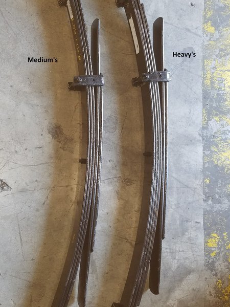

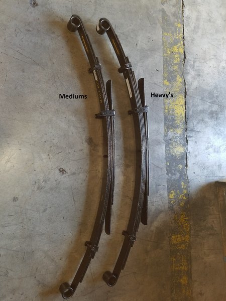

    Leaf springs are here in stock now. Here are some photos showing the medium vs heavy load springs side by side (1 extra leaf installed).

    So, when you say the medium springs give roughly 2" of lift in the rear, is that amount of lift assuming there is roughly 100kg of extra load in the rear?

    They're technically to give 55mm (2.16") of lift with up to 100KG (220LBS) of weight in the back, so if the rear end is empty, you will end up with more lift.
    We ran them empty on our truck for a month and found that without any weight, the ride was definitely firmer than stock, but when we added some deliveries and weight, it was awesome. We removed them and added our quick ride kit (2" blocks) and OE springs and the ride was better. So I don't really suggest these if you run an empty bed all the time, the back of the truck is so light. We're still running the blocks and OE springs, but now with a bed rack, RTT and awning, and the rear end has dropped. We need to swap in the medium's now.
    If you load up your truck often and need to support that load and maintain lift, or if you run a RTT or camper shell or some permanent weight back there, these are for you. If you're fully loaded always, then use the heavy loads. If you're empty, the parabolic springs will be the best option for comfortable ride plus lift.
