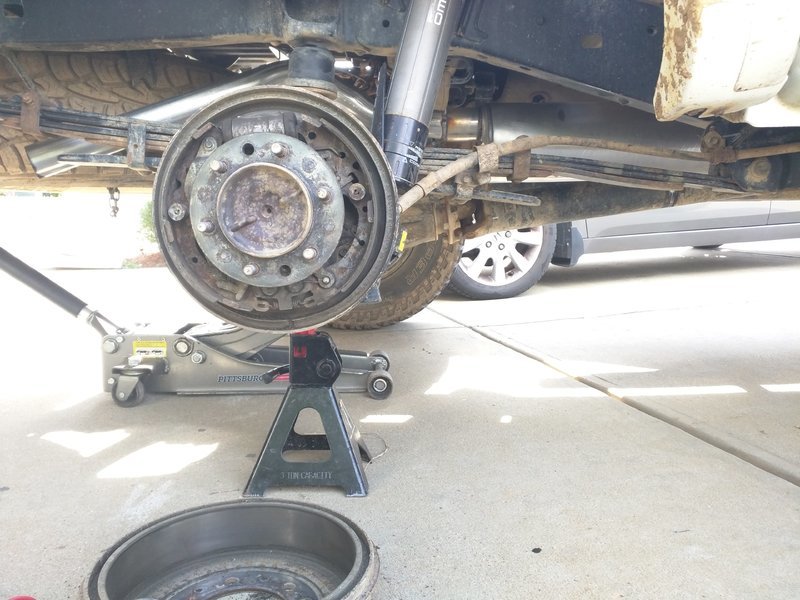

    Hmm, may need new leafs.. Any thoughts on what happened here? That's a set of Toyota 3+1 (new frame springs) with the 3rd leaf swapped for a Chevy leaf and the wheelers 3 leaf aal. Don't mind the brake job.

    jezus... that AAL bent that chevy spring all to hell!
    Also.... you got the bottom of your shock in backwards. spin it 180 so the dirt shield is on the front side of the shock!

    AAL is NOT LONG ENOUGH for the amount of support that it provides.
