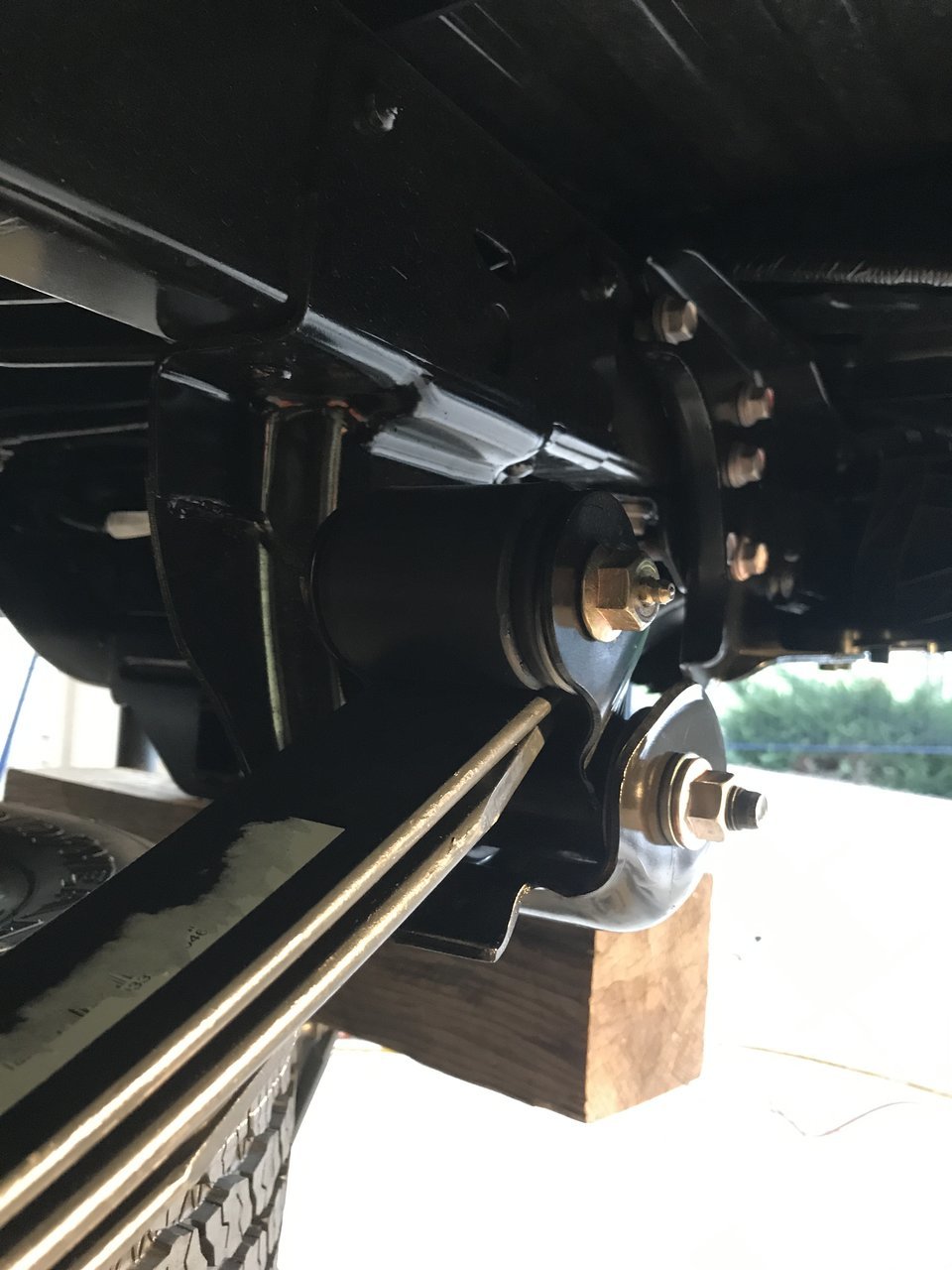

    Here’s a pic of the rear mount. I wish I would have taken pictures of how I modified the bushings, but basically I just drilled 4 holes where the holes in the bolt would line up. If that makes sense.
