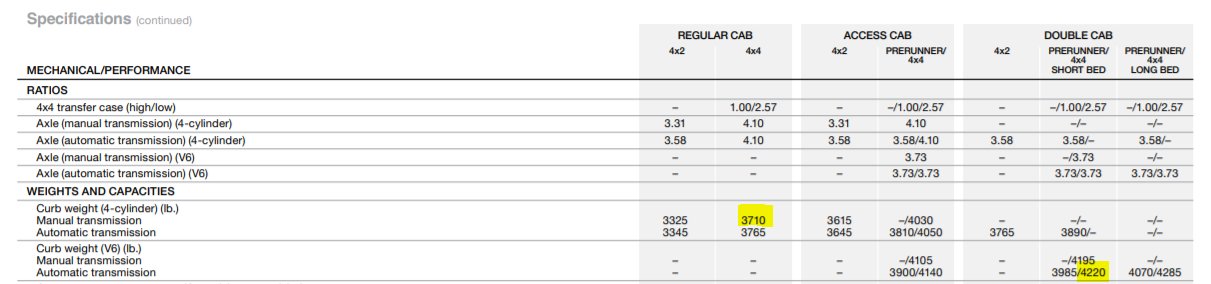

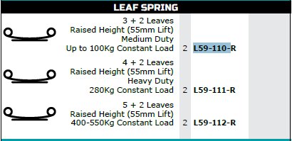

    @Crikeymike
    L59-110-R is rated for ~2.25" lift up to 220 lbs. My question is, did Dobinson's design that leaf based on the 2nd Gen Double Cab Short Bed V6 4x4 Configuration? The Curb Weight difference between that and a (my) Regular Cab 4cyl 4x4 is ~500 lbs. If that's the case, I would assume to gain load capacity over the stated 220lbs before seeing the springs squat.

    Crikeymike
    Crikeymike [OP] ExitOffroad.com Vendor
    Oct 17, 2016
    #199985
    2,079
    Jax Beach, Florida
    Yes, it was designed and the specs are based on a dual cab short bed, so yeah, yours will be taller with less weight from having less cab weight.
