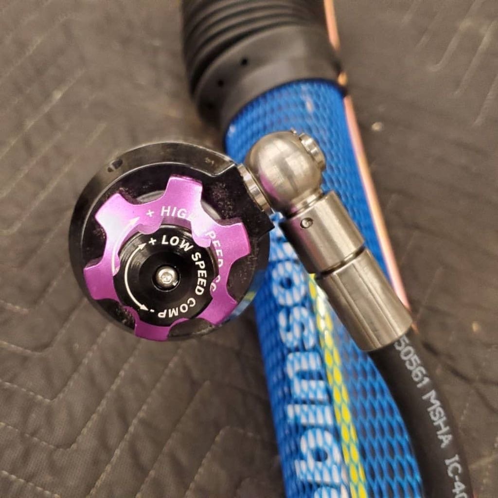

    NEW PRODUCT ALERT!!!
    DOBINSONS 3-WAY ADJUSTABLE MRR (MRA) LONG TRAVEL REAR SHOCKS FOR 2005-23 TACOMA
    • 3-way Adjustable shocks provide maximum adjustability to provide the perfect ride quality for you
    • 10 Stage High Speed Compression – For aggressive, high speed offroading through ruts and holes
    • 20 Stage Low Speed Compression – For creepy crawling and cornering
    • 15 Stage Rebound – Control your coils, prevent bucking
    • 50mm CNC Machined High Flow Billet Aluminum Race Piston
    • 3mm Thick Heavy Duty DOM Seamless 56mm (2.2″) O.D. shock Body Precision Honed to +/- 0.04mm
    • Upgraded 3 Stage FKM‐HNBR Sealing System
    • TSUGAMITM CNC machined components for precise tolerances
    • Parker Braided High Pressure Hoses
    • 5140 HV900 Hard Chrome Plated, Heat treated 18mm Micro-Polished high strength Shock Shaft with a minimum tensile strength exceeding 700MPA
    • Carbon-Fibre/PTFE/Disulphide composite wear band for the ultimate in low-friction, low‐wear performance
    • 60mm Full 6063 aluminum remote reservoir, Lightweight CNC Machined Low Friction floating piston
    • High Quality O.E.M. Grade Natural Rubber Bushings
    • Single Piece Lower Leg, CNC TIG Precision Welded Body End Mounts
    • EDP Surface Protection, Direct Bolt-On Design
    • Fully Rebuildable Design, Full 2 year limited warranty, no set rebuild time period
    • 16.5″ compressed length, 26.9″ extended length
    • These shocks require +4" Brake Lines and 2″ bump stop extensions
    Part number MRA59-A941, in stock and shipping now. Current price is $1090/pair
    https://exitoffroad.com/product/dobinsons-mra59-a941-long-travel-rear-tacoma-shocks/

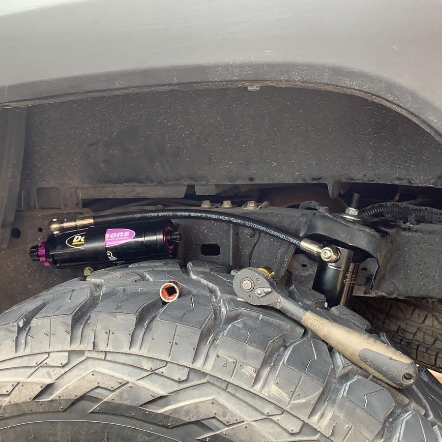

    @Crikeymike, does this reservoir mounting look correct on passenger side?
    Crikeymike[OP] likes this.
  3. Jul 19, 2021 at 11:10 AM
    Crikeymike
    Crikeymike [OP] ExitOffroad.com Vendor
    Oct 17, 2016
    #199985
    2,068
    Jax Beach, Florida
    Glad you love them!!
    Just need to make sure that the hose coming off the side of the shock can't contact the frame mount there (where the metal crimp of the hose is), as it's hard to tell from the photo if there's clearance or not. Otherwise it looks good!!

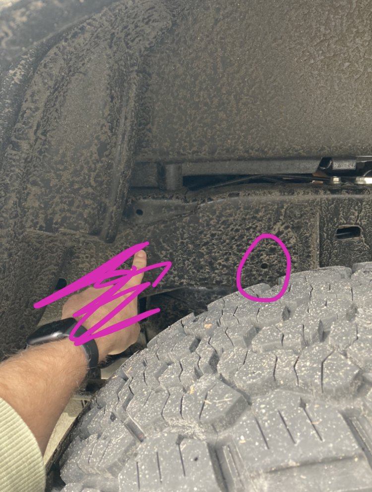

    Thanks for the rear shock mounting instructions they had some great info. Do you have any tips for mounting the driver's reservoir in the location shown in those instructions? There couldn't be more stuff in the way when trying to drill and install for the bracket. Was the fuel tank dropped to achieve this location? Passenger was no problem. Below is photo of completed passenger. IMG_5589.jpg

    For what its worth driver side rear shock was installed today. Using the existing hole in frame (circled in pink) to mount resi. Worked out half decent not as clean as the instructions but one less hole to drill b.jpg a.jpg

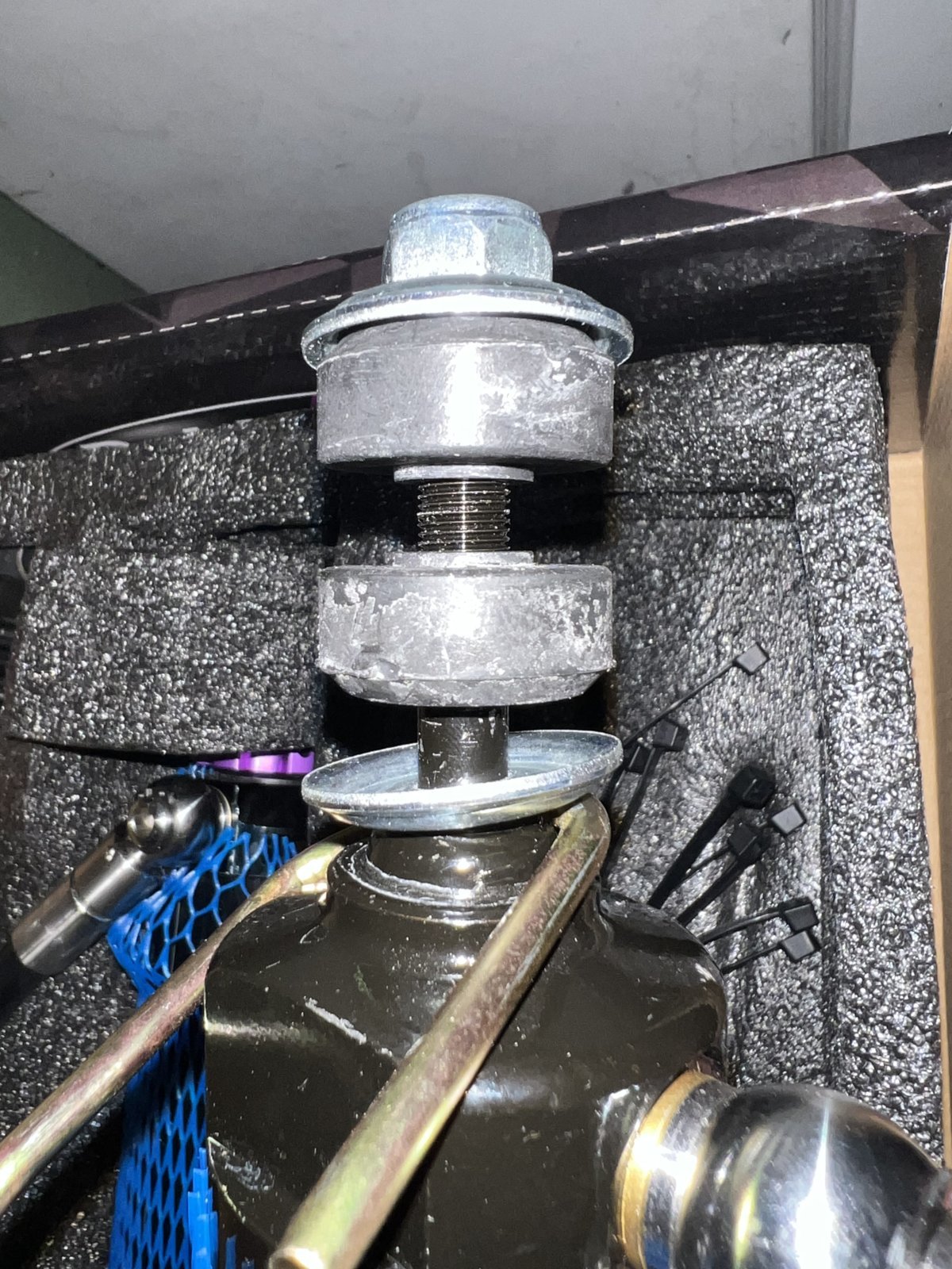

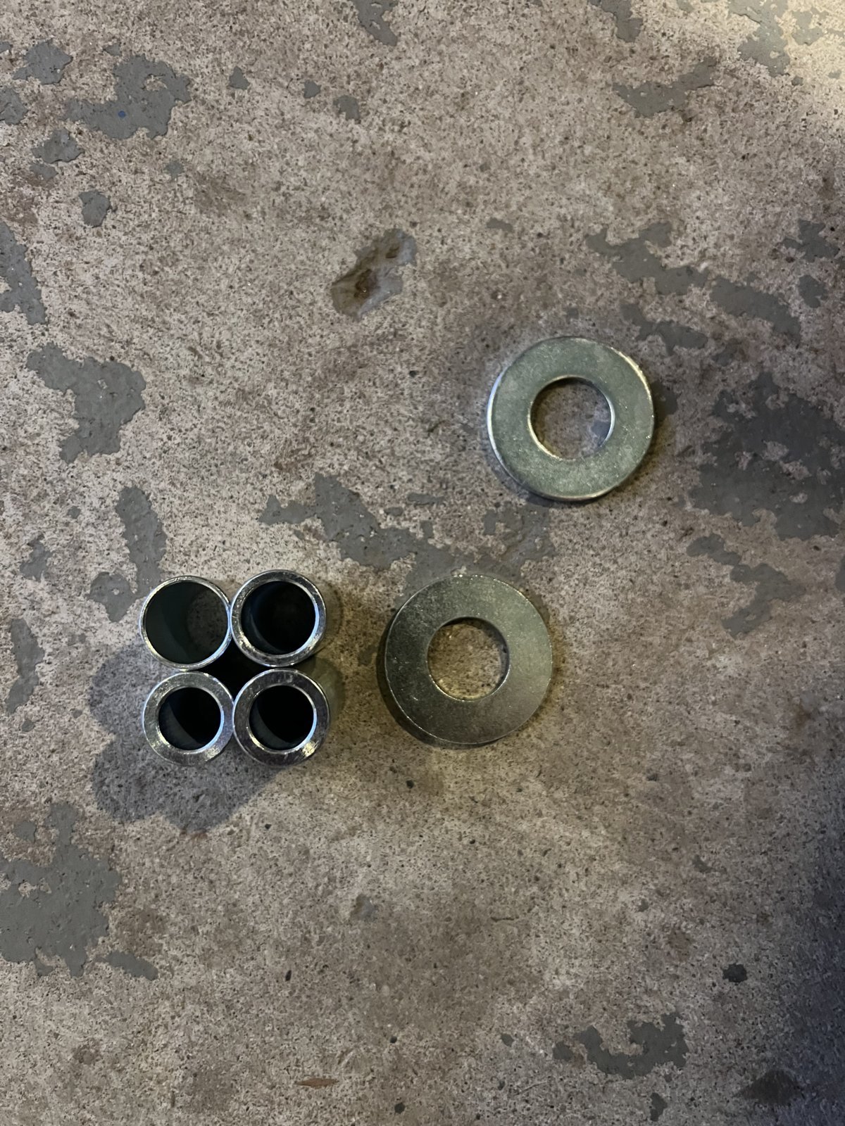

    I understand the bolt sleeves are for the lower shock bolt on the rear. What about the big washers? The sleeves fit right in them.
  15. Jan 22, 2024 at 6:17 PM
    JFriday1
    JFriday1 Well-Known Member
    Jan 14, 2019
    #279318
    704
    Jesse
    Lakewood, CO
    19 Taco TRD-Sport, 16 4Runner
    Mobile Mechanic in Denver Instagram - "Jfriday123"
    Correct me if im wrong, but I think the rear shocks work for a tacoma and a 4runner. One size sleeve is for the tacoma (smaller inside diameter) and the other sleeve is for the 4runner. The big metal washer goes on the post for the 4runner before you install the shock on the bottom mount.

    Does this seem right? For both upper and lower shock mount.
  17. Jan 22, 2024 at 8:02 PM
    #17
    JFriday1
    Jan 14, 2019
    #279318
    704
    Jesse
    Lakewood, CO
    Yes that looks correct to me.

    Yeah, that's correct.
    The large washers are to go on either side of the lower shock bushing if needed.
  20. Jan 23, 2024 at 12:07 PM
    #20
    White2018g
    White2018g Well-Known Member
    Aug 1, 2018
    #261305
    59
    White 18 sport
    Stock
    That would be to isolate the shock mount from the strut body? If needed to fill in that gap?
