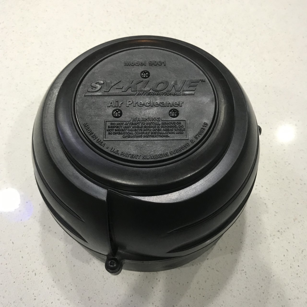

    @BlakeM what brand/model is that “mushroom top”

    Sy-Klone 9001
