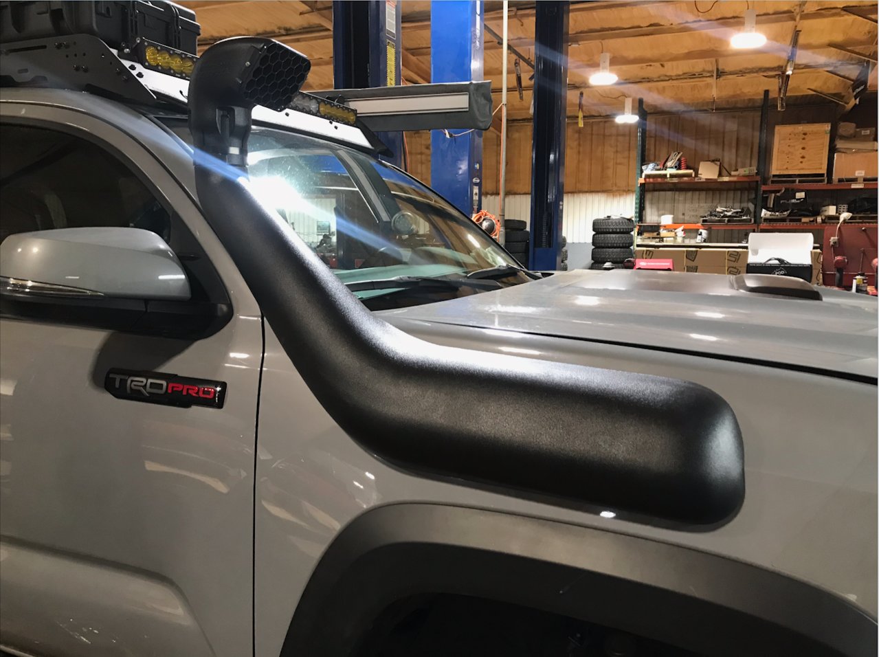

    So that took a almost a year lol, but it’s on there now.
