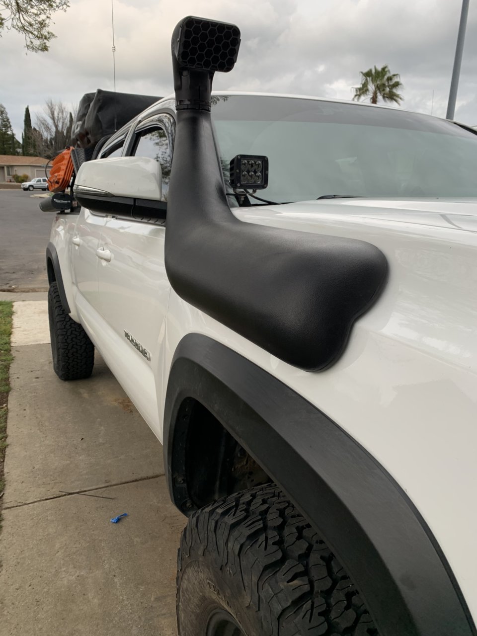

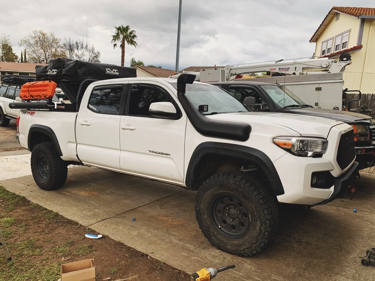

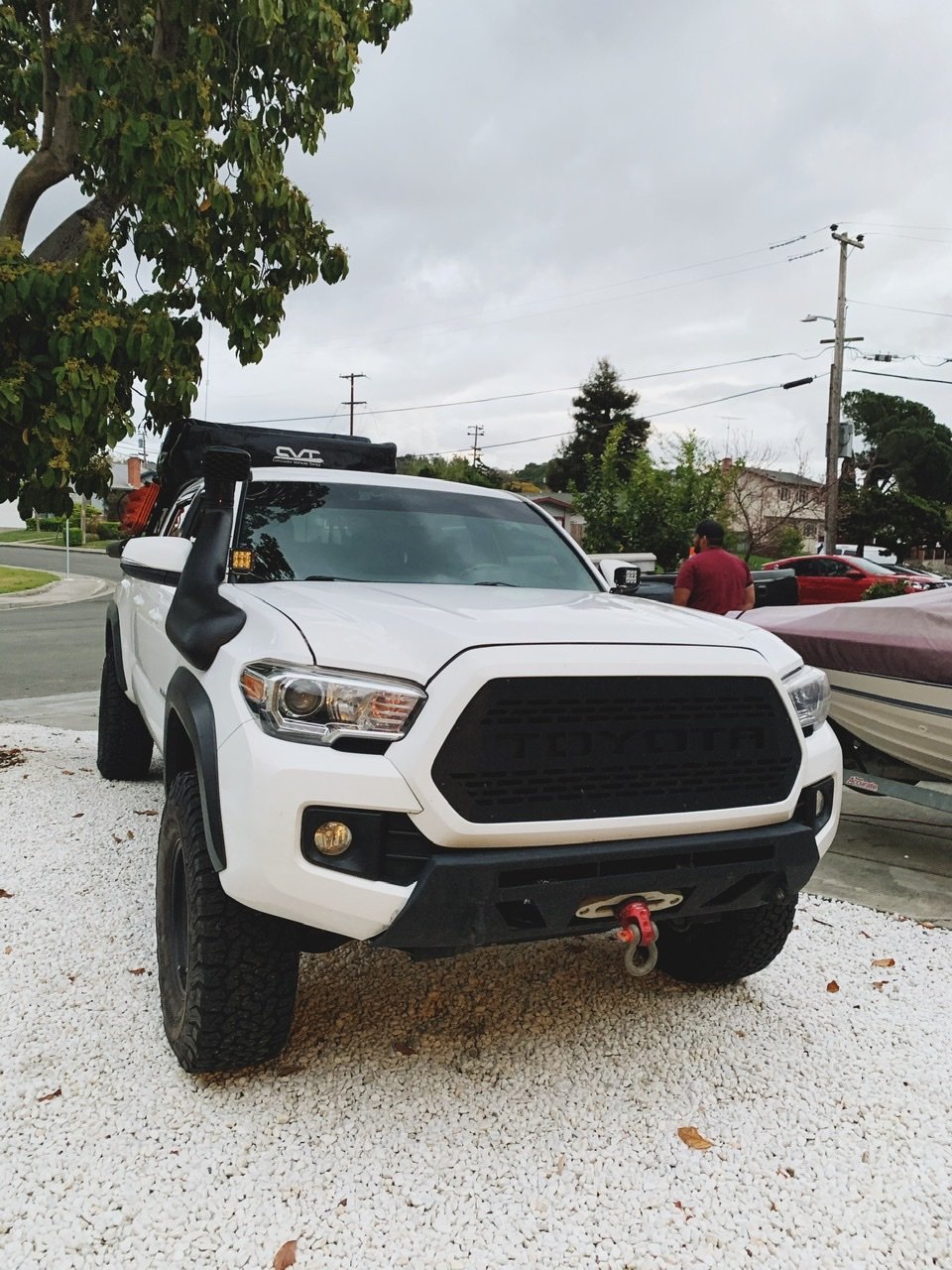

    Installed mine yesterday... Um, it took a little over 1.5hrs.... I was shocked at how quickly we were able to put this thing on.
    And people 16mm is 5/8 of an inch! That’s how big Dobinson wants you to make the mounting holes.... that gives you so much room for play....
    The template holes were okay, with the bottom left hole slightly off... You find out when you put the template up to the snorkel before install... still made it without opening up the holes more than the required 16mm...
    For those that were curious, like I was, my rago fab ditch light mounts cleared the snorkel. The Rigid light just needed to be loosened and moved over max in adjustment...
    Oh and the elbow wasn’t as bad as people made it seem to be.... awkward to make up to the snorkel but nothing to cry about... I feel the most frustrating part of the WHOLE ordeal was taking the stupid clips that hold the wheel liner on.... fuck those things
    I was planning on taking all kinds of photos.... thing went in so fast, that didn’t happen LOL
    here are a few after pics (shitty cell pics

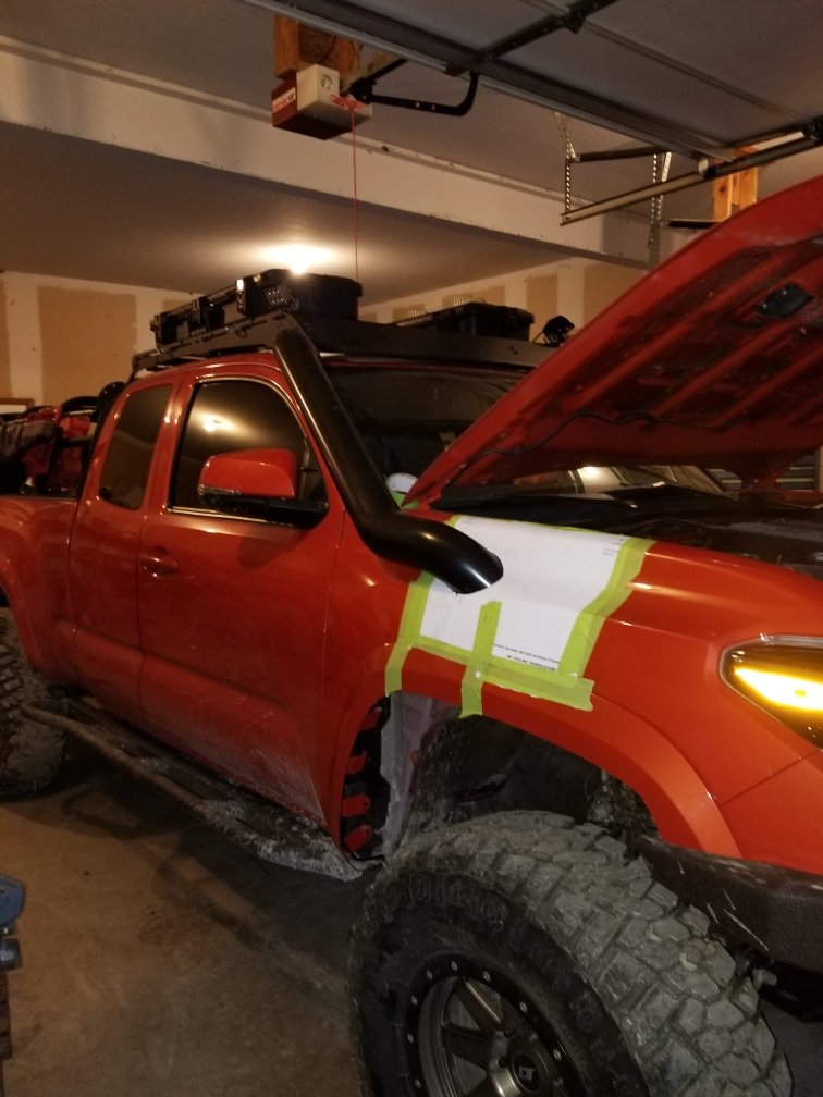

    Had this thing setting in the garage for a long while. Finally got around to getting it installed. Like everyone has suggested, you gotta measure 20 and cut once....ish. The template was a clam chowder hoagie. Followed step #6 three times, but only two holes were even close. Ended up boring out the holes. Dobinsons should really take a strong look at this thing and get a new template out there if they haven’t already.19E07DAD-B22D-4D1C-A9A7-468F44BC32B2.jpg A54AB7EC-360F-4A3A-8974-44624EFFCCEB.jpg

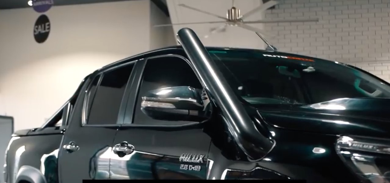

    Why are there no stainless steel snorkel kits available for the Taco in the States? There seems to be a few stainless steel snorkel kits available for the Aussie's including the Hilux and Ranger Down-under (not to mention they get the diesels too). Would prefer a stainless steel version since it looks way cooler than the plastic kits available, not to mention more durable. Some of our smaller fabricator companies in the US might want to prototype one since I bet they would be a hot sell for this community.
