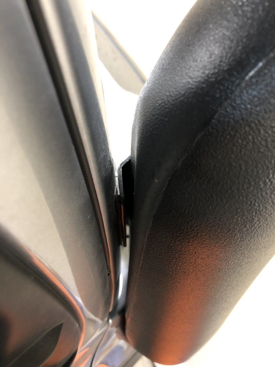

    Truck is home and im at work... Its about a 3/8" gap between A-pillar and A-pillar mounting bracket bolted to the snorkel. I stuffed camper foam tape between the two surfaces... Need to go with a 3M product... I was running it bare at first, but the snorkel would vibrate a bit in high winds... nothing crazy, but noticeable.

    As you can see, the mounting tab sits canted, and doesn’t plane properly with the c-pillar.... the angle sits a dog hair over 1/4” away from the c-pillar when bolted up... the snorkel itself is about 5/8” -3/4” away from the c-pillar depending an where you measure... you really can’t tell there’s a gap from inside the truck or outside unless you see it from the bottom, looking up, or cheek on the windshield to look in there.... Gorilla 30lb tape stacked up to make up for the 1/4” surface gap took care of the vibes...
    To be fair, I could care less what it looks like... I’ve had water over the hood for brief instances and I never want that *gulp* worry again...
    There are people on this very thread that have asked if they could just 3M the snorkel on because they want the “look”... to each their own...
    Hope this helps, man

    Thanks bro! Exactly what I was looking for, mine looks exactly the same, the template left a lot to be disired for when I installed, so glad to see I didn't go too far off the a pillar. FYI bro, your truck looks sick! Thanks again for providing input I needed.

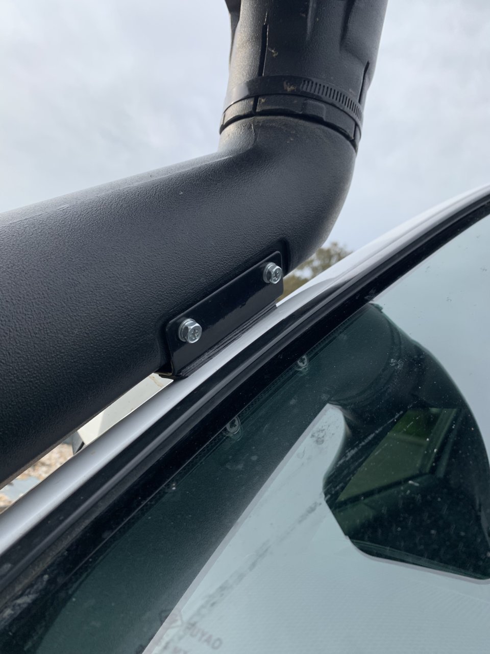

    Got mine installed today. Didn’t take long.
    my template was like 90% correct, I ended up drilling the holes to 7/16” and it fixed the alignment problem.
    I didn’t drill into my a-pillar, instead used 3M VHT double sided tape. I also had to bend the bracket slightly to get it flush with the pillar.

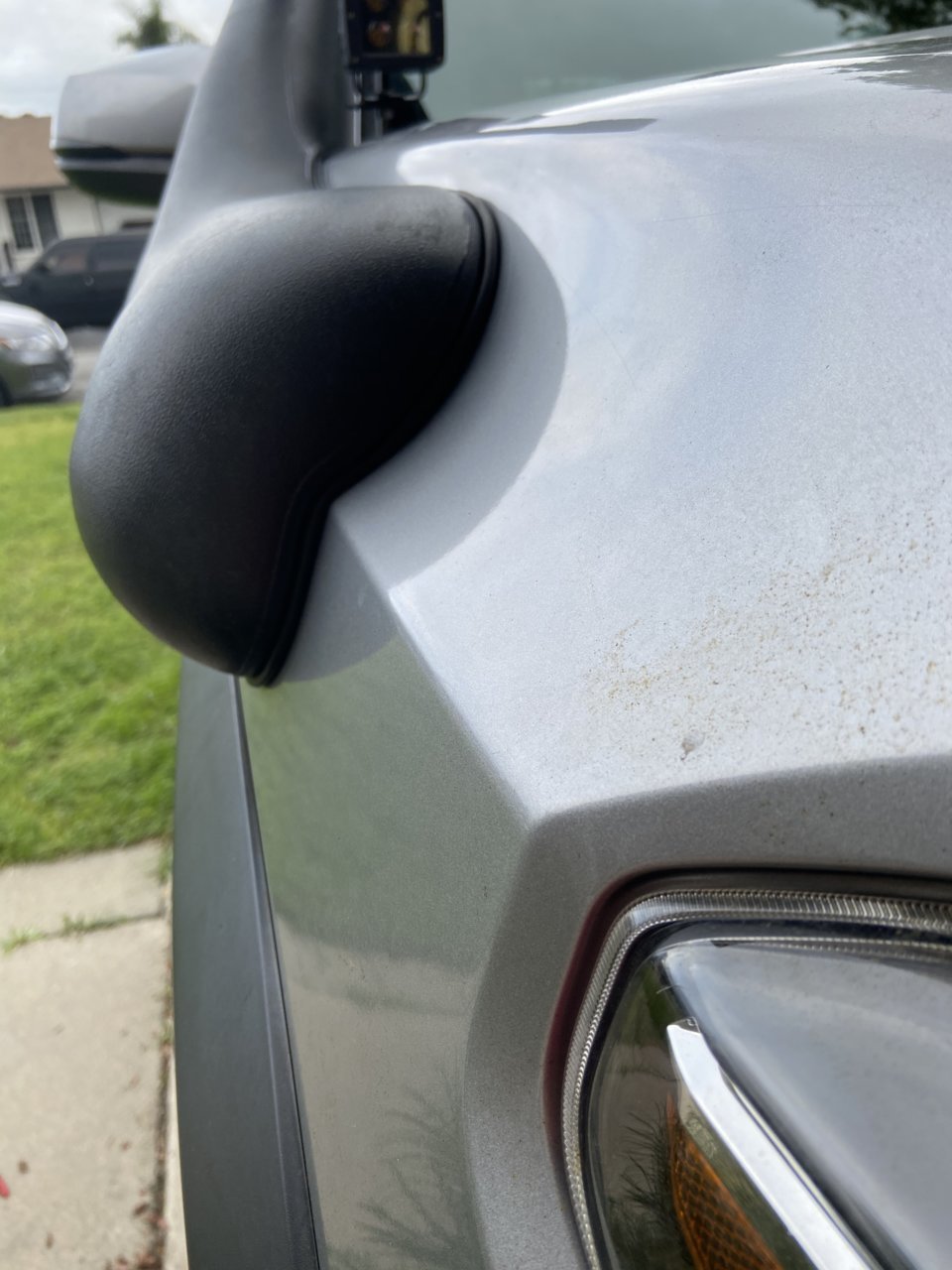

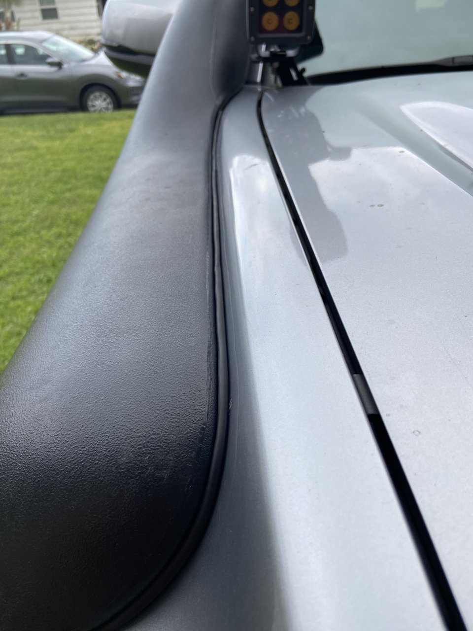

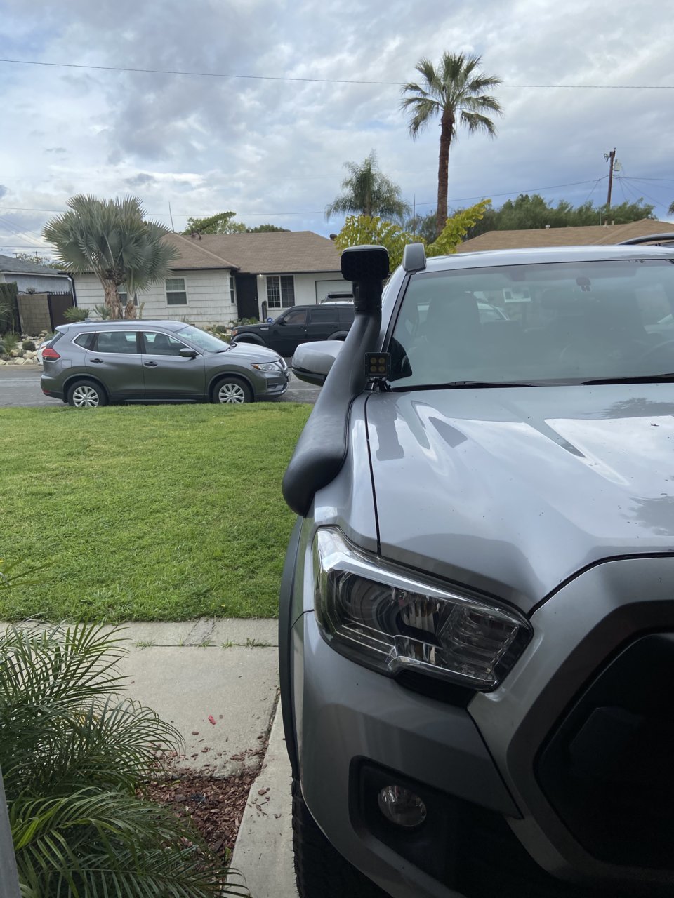

    Anyone else run these rubber trim for the snorkel. I think it came out well, mainly for off roading and felt those gaps would have issues with dirt and rocks getting in there.

    looks nice, where did you pick that rubber trim up at?

    Trim-Lok Rubber Tubing Seal – .276” Outside Diameter, .206” Inside Diameter, 25’ Length – Closed Cell EPDM Foam Tubing – Ideal Door and Window Weather Seal for Cars, Trucks, RVs, Boats, and the Home https://www.amazon.com/dp/B00NL4DI2E/ref=cm_sw_r_cp_api_i_87OKEb3727Y08
    Here you go

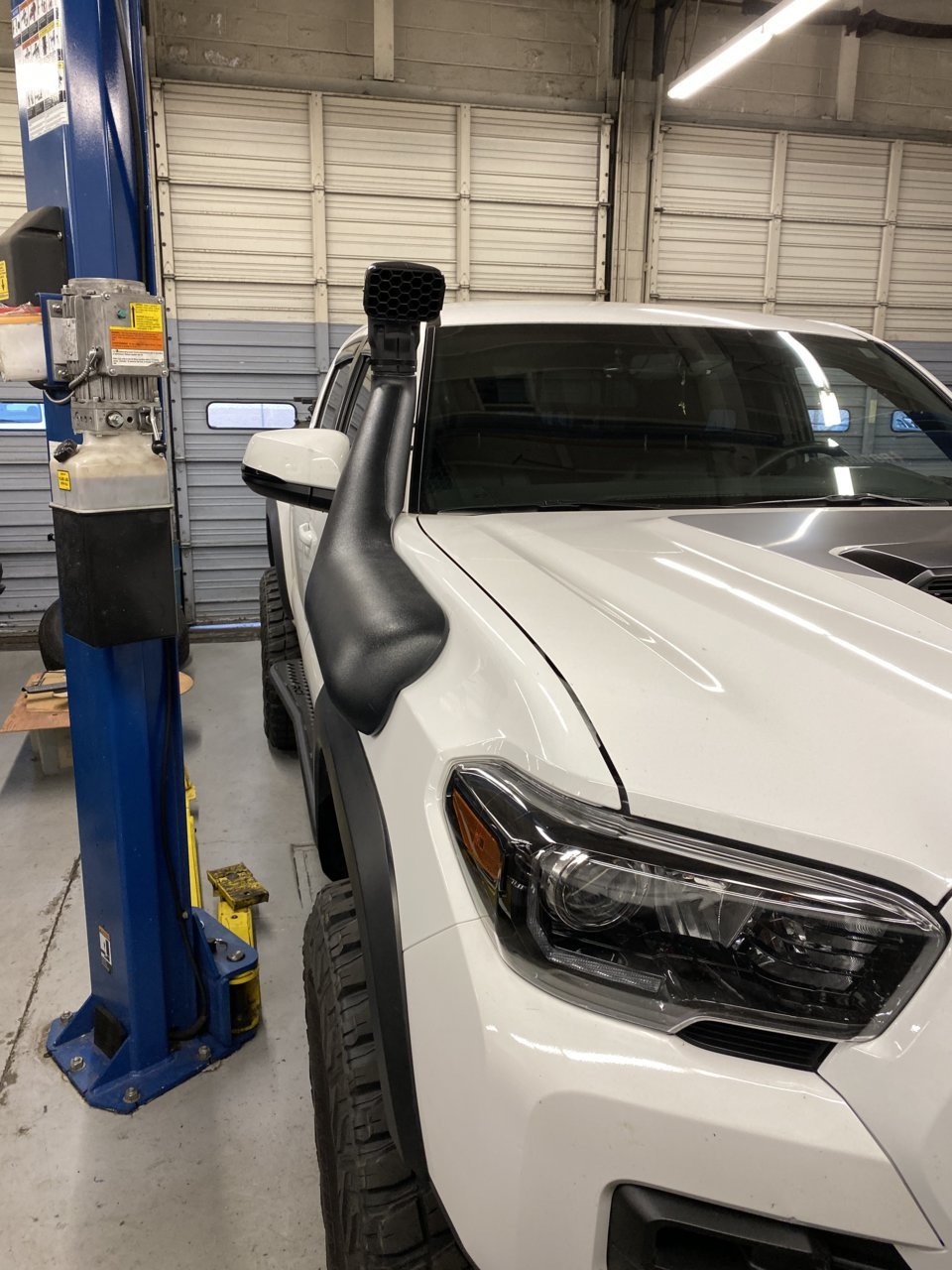

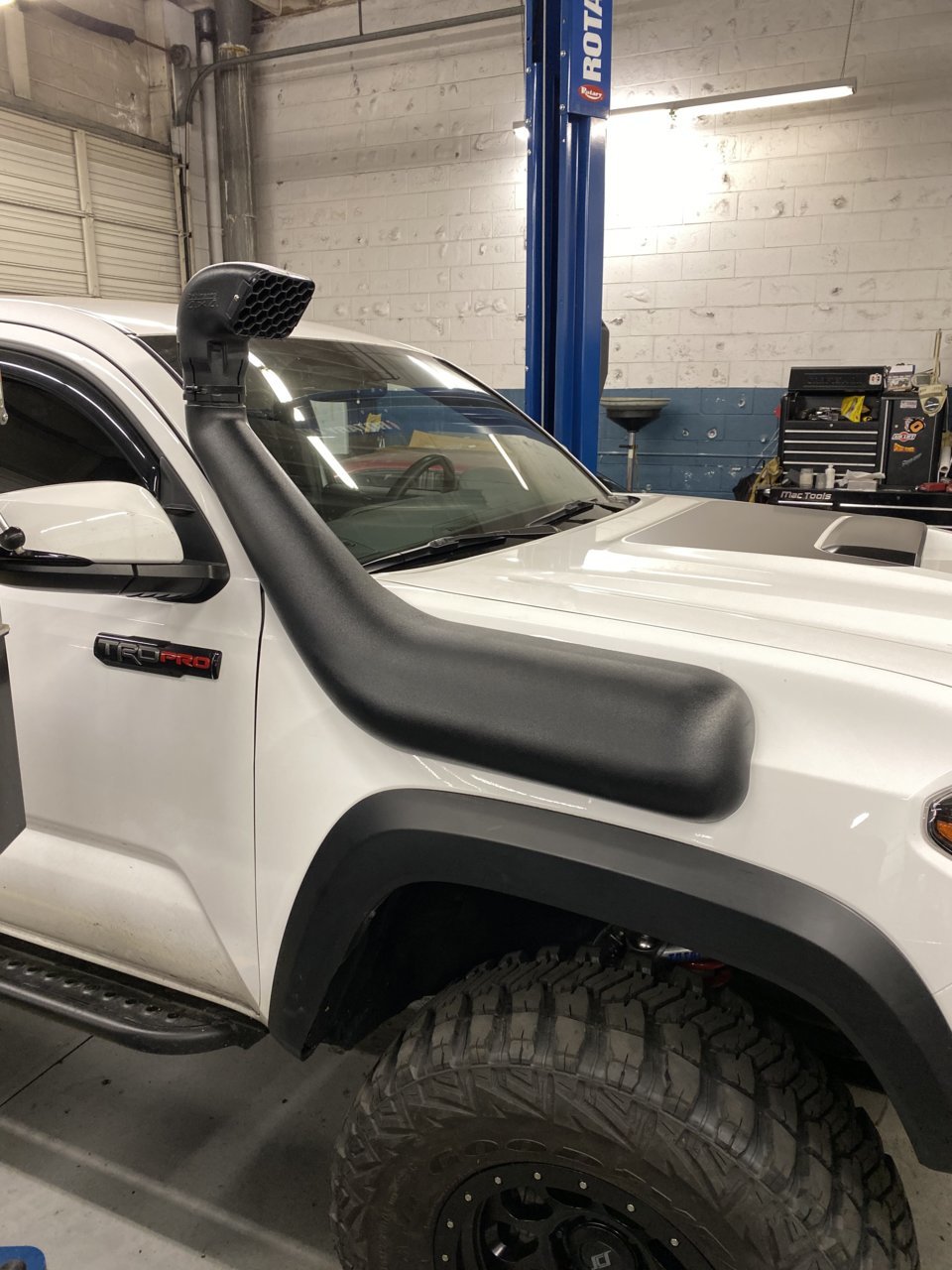

    mine fit fine the template lined up as long as you follow the instructions. IMG_2665.jpg IMG_2666.jpg IMG_2667.jpg IMG_2668.jpg

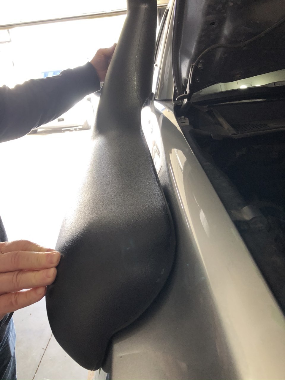

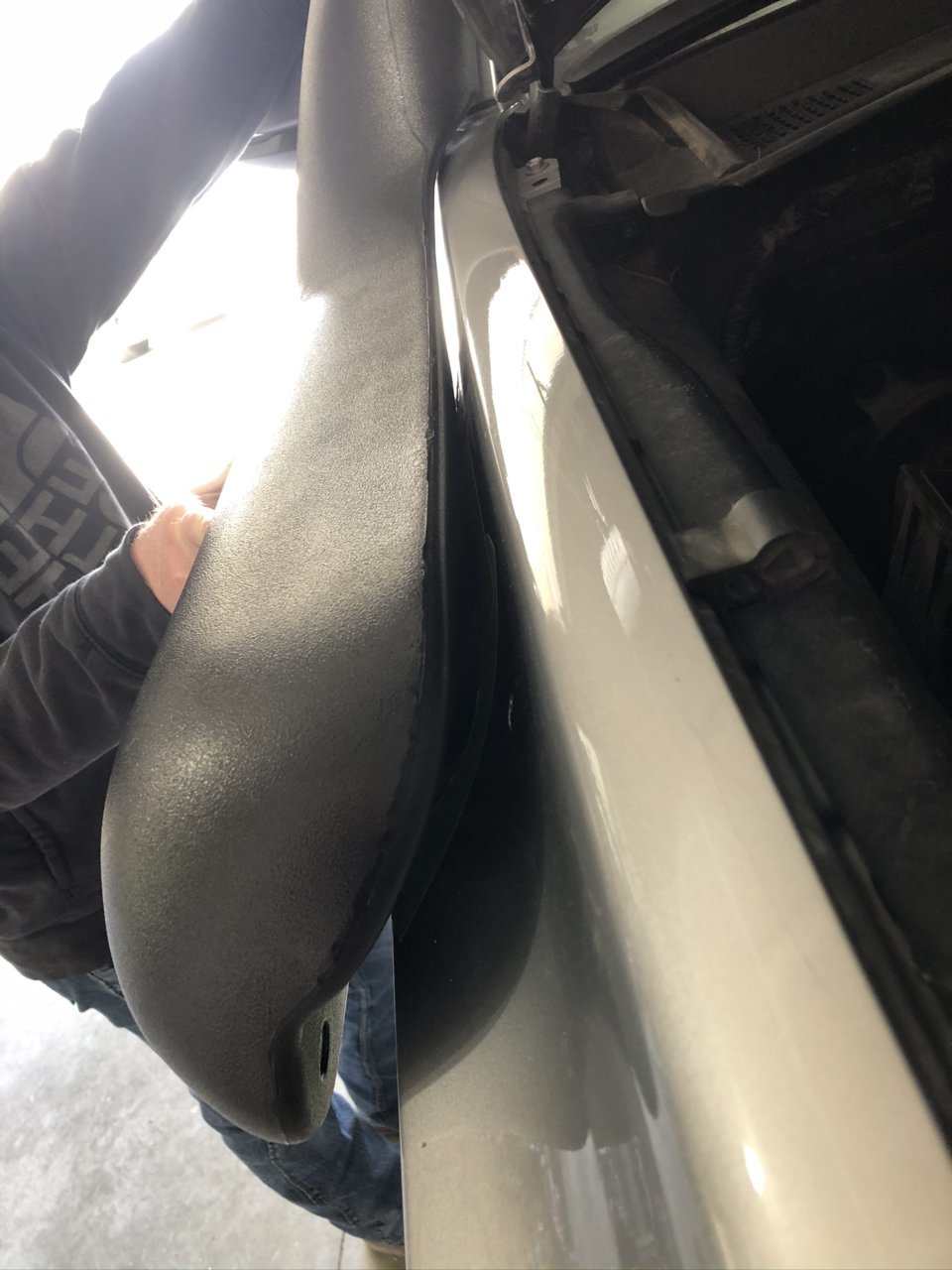

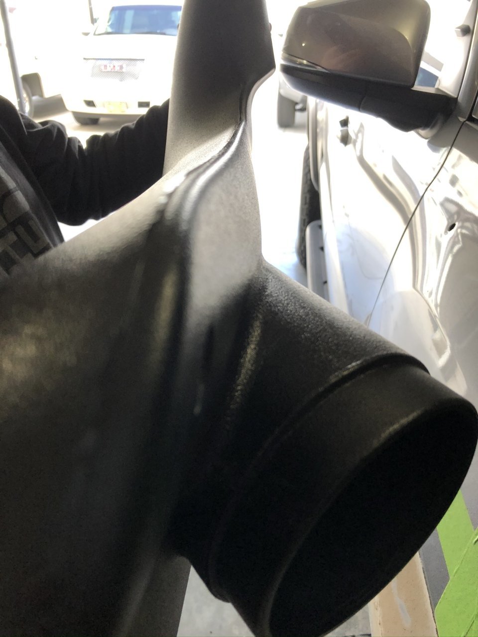

    I’m not so sure about mine. The whole snorkel is rounded and can pivot from how out of shape it seems. It’s made out of pretty hard plastic so I can’t see it flexing the amount it would need to. When I hold it up to the truck and make it sit where it should with the a pillar the front of the snorkel is about 1.5-2” away from the fender. If I make the front of the snorkel fit where it should there’s no chance I could even start the nut on the bolt towards the rear of the fender

    Here’s some pics of it

    looks a little warped. I'd do two things 1st contact the seller and see if they'd replace it. or 2 get out a heat gun and heat the high spot on the back then push it in with a wet rag try to get it flatter and try to get it to fit better .

    I contacted the seller, hopefully have an idea of what they will do Monday. Inner fender out, big hole on the side of the truck. Feels like I can look straight into the intake. I’m not really game to get a heat gun out and attempt to fix it all. Afraid I’ll run into more problems fitting the sleeve for the air box that way. Didn’t post this to scare people away from the snorkel or Dobinsons. Curiosity got the best of me to see how it went for other Tacoma installers.
