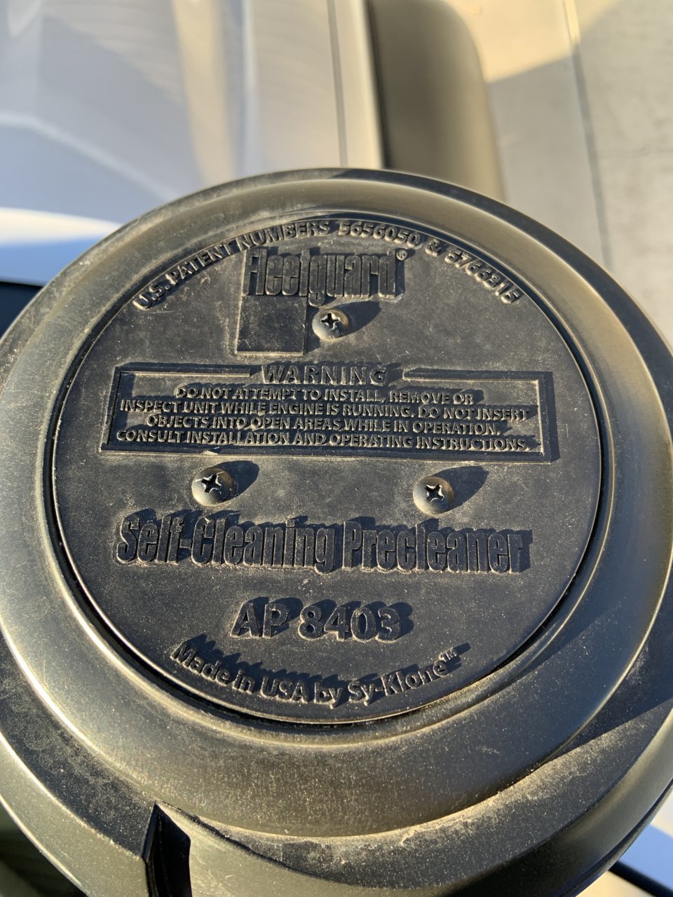

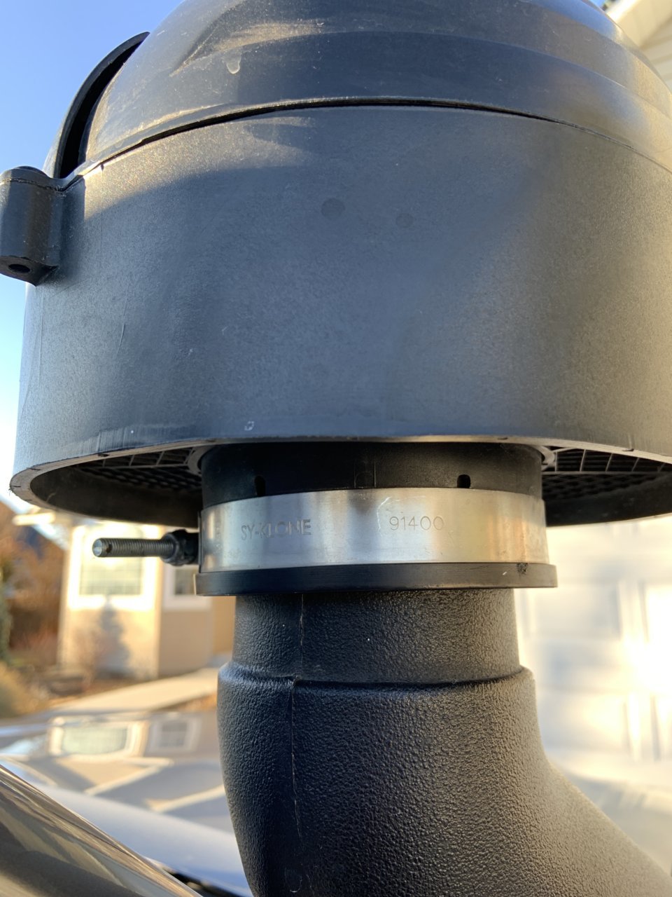

    I used the syklone 9001. I had troubles sourcing a syklone so I ended up using this model number AP8403 Fleetguard. It is the syklone, stamped with syklone but rebranded for fleetguard. You will also need a reducer 4.0x3.5 in size. Try model number 40R35 to find the right one.
    There is debate on 9001 vs 9001r. I felt like the 9001 fits our engine size the most appropriate. I don’t feel like it restricts the engine at all or has any effect in high or low rpm ranges. It’s been on the vehicle since I got the snorkel and I have done 80mph interstates with no problem. The thing stays put. I did get some vibrations when I only had 3m tape on the pillar but the pop rivets fixed that.

    I talked to the guy who runs Syklone's Instagram, per his recommendation I bought the 9001 and reducer, as well as some rubber insulation tape to fully seal as the reducer brings it it to 3.5" and the inlet on the snorkel is 3.36".
