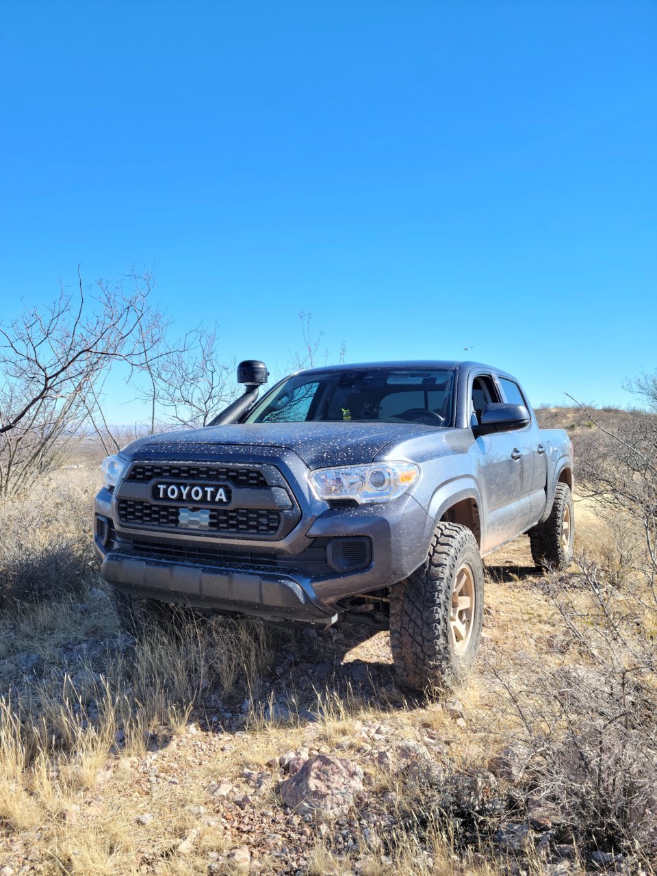

    I don't have any closer pictures but I used rubber tubing to seal the edges and keep debris out, also looks extremely clean.
    Paired with the precleaner, my filter stays so clean I was actually comfortable enough getting a performance filter. I use the AFE Power Dry filter.
    Since October, I have put 18K miles on the truck with this set up. That includes SEVERAL thousand miles of dusty dirt road driving, as I am a hunting guide in Arizona. I haven't had a single bug or drop of water in the air box (we've had a few good rains since install). I've pulled the filter out to whack on the tire and not once have I been engulfed in a cloud of dust, as I'm accustomed to with the factory intake.
    Overall, very pleased with the function. As far as comparing this snorkel to any of the others, my preference is here with Dobinsons because there's not a huge logo on the side, buying from @Crikeymike is a breeze with great customer support, and they're extremely affordable.
    If you're looking into a snorkel: do it, and buy from these guys. You won't regret it.

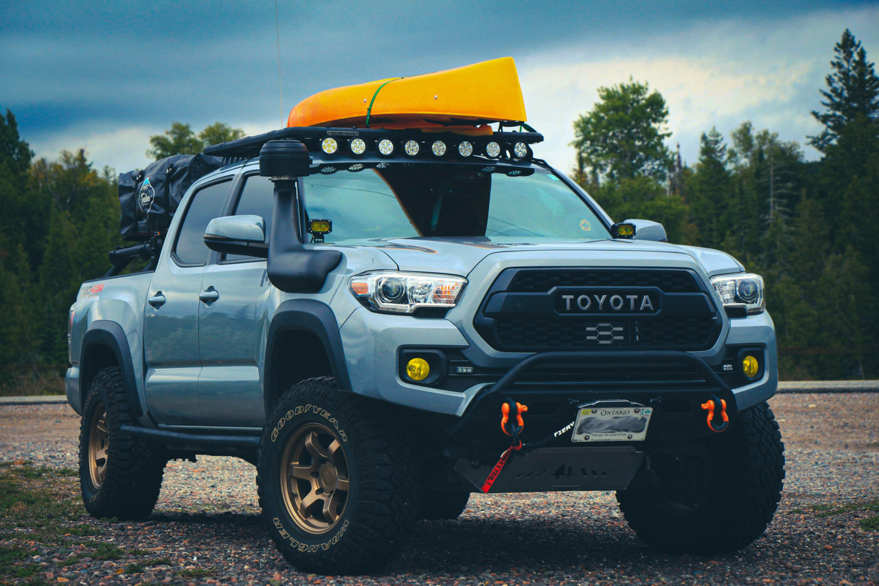

    I’ll play. September 2021 journey around Lake Superior
