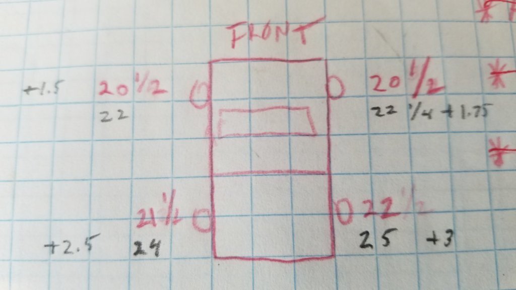

  6. Feb 13, 2025 at 11:30 PM
    #26
    RyanDCLB
    RyanDCLB Well-Known Member
    Jun 13, 2019
    #296235
    3,541
    4/19 DCLBOR
    Here are my numbers with the 111 leaf springs and 352 coils (with winch bumper; I ended up with the1/4 top out spacer). Red is stock. Grey is with the suspension installed. Full tank of gas and no air in the airbags. Level ground.
    Please let me know what you think. Sorry, but I'll need to look for post 110 measurements, but they solved the stink bug and stiff ride problems. :thumbsup:

  11. Feb 14, 2025 at 12:21 AM
    #31
    hoodwinked
    hoodwinked [OP] Well-Known Member
    Feb 20, 2021
    #356787
    174
    Cool. Thank you for that. Looks like I gained even a little more than you with the 111 leafs. If you have time, a measurement of where you sit with the 110s would be awesome. I am dead set on taking out a leaf.....just curious if it looses 1" to end up around 2" lift, or if it looses 2"and end up at 1" of lift.
    You went with the 352 springs?

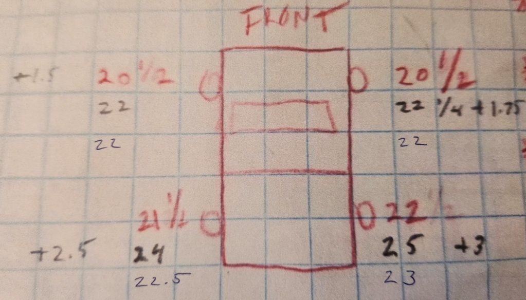

  12. Feb 14, 2025 at 3:20 PM
    #32
    RyanDCLB
    Jun 13, 2019
    #296235
    3,541
    4/19 DCLBOR
    Here's how the truck sits now (in blue) with 110's, a full tank of gas, and 5 years of hard abuse:
    RED = stock
    Black = 111 leaf pack, 352 coils
    Blue = 110 leaf pack, 352 coils (broken-in) w/ 1/4" top spacer
    Yes on the 352 coils with 1/4 top out spacer :thumbsup: Edit: I have 354 coils waiting to go in...
    Bonus pic:

  14. Feb 14, 2025 at 6:31 PM
    #34
    RyanDCLB
    Jun 13, 2019
    #296235
    3,541
    4/19 DCLBOR

  18. Feb 18, 2025 at 11:00 AM
    #38
    Crikeymike
    Crikeymike ExitOffroad.com Vendor
    Oct 17, 2016
    #199985
    2,064
    Jax Beach, Florida
    With 22" being the average OEM rear height, you're at 1/2" on one side and 1" on the other side. This is where we get the info that L59-110-R's lift only 1" on a long bed.
    RyanDCLB[QUOTED] likes this.
