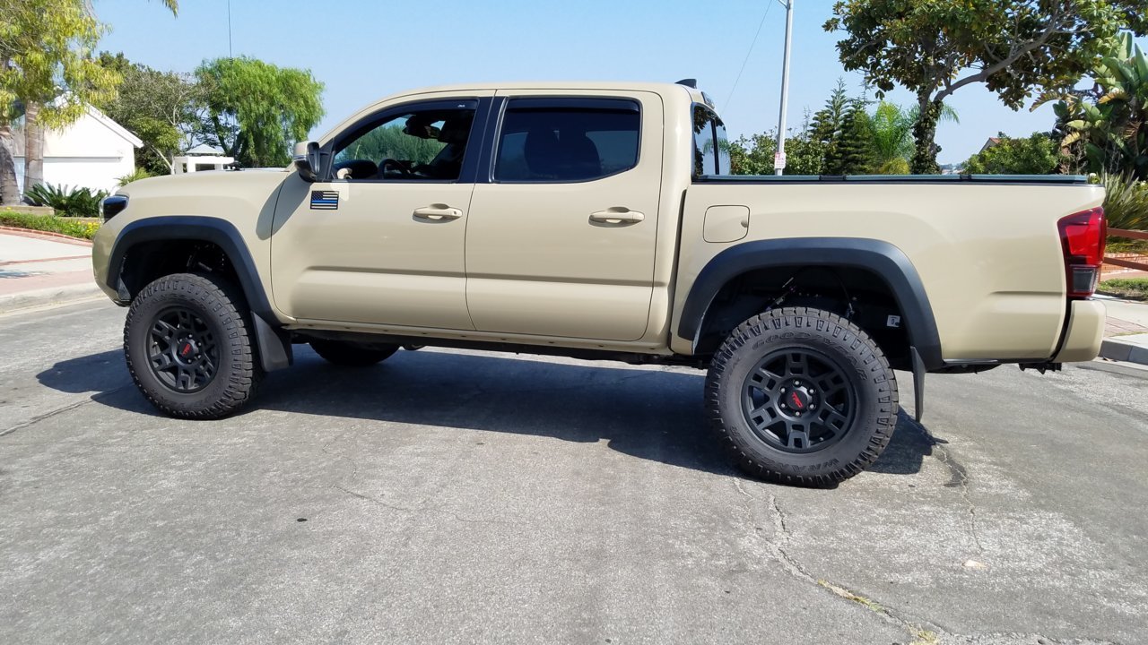

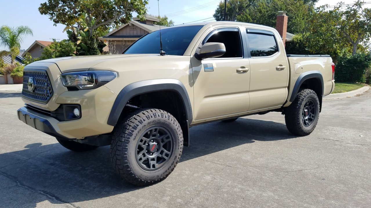

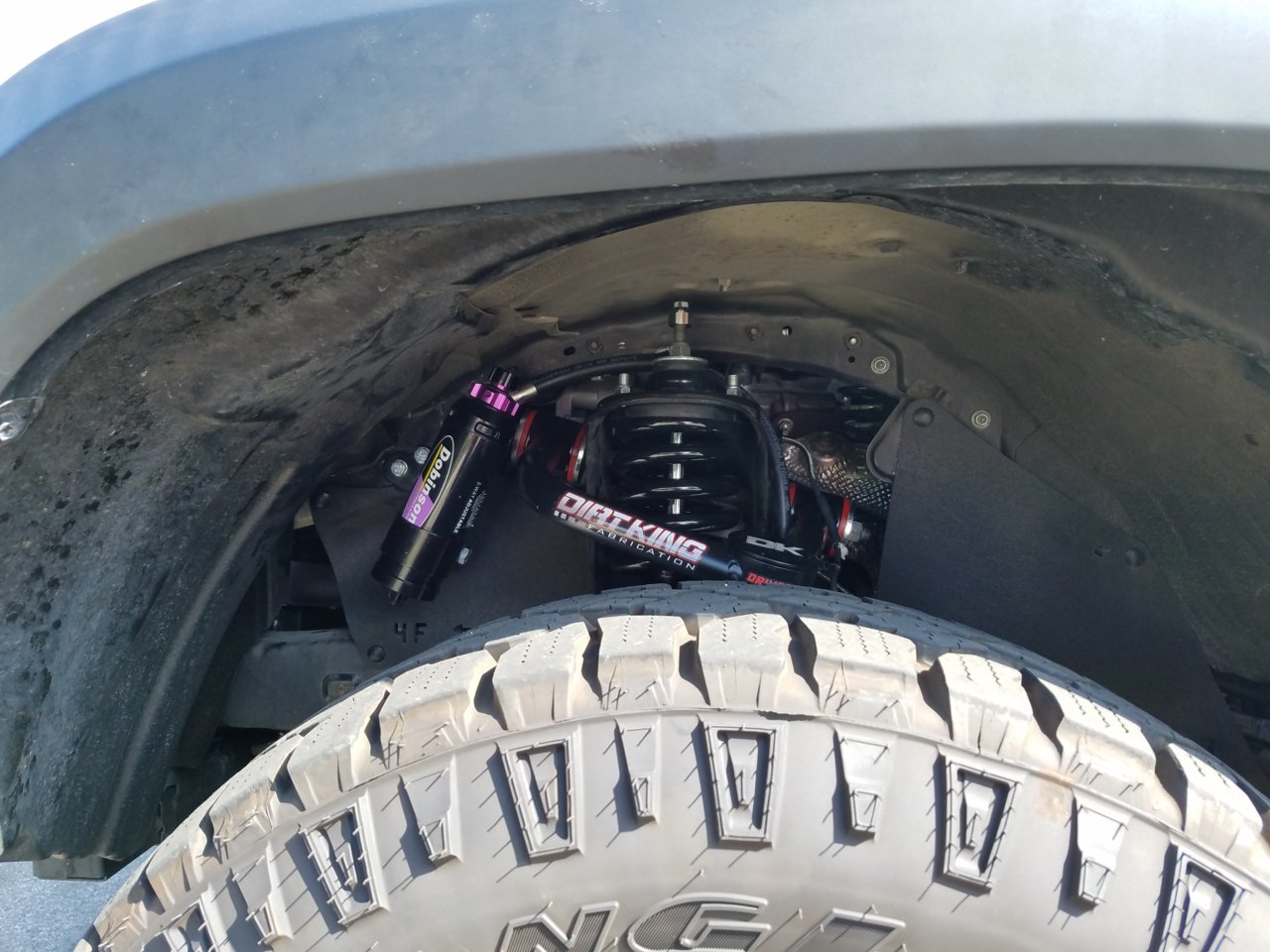

    So, here are some pics. I will keep the thread updated with how this thing settles in, and post more pics when I get the topper installed next week, but all in all I am super pumped with my purchase and the experience I had going with Jason at Ozark Overland Outfitters.

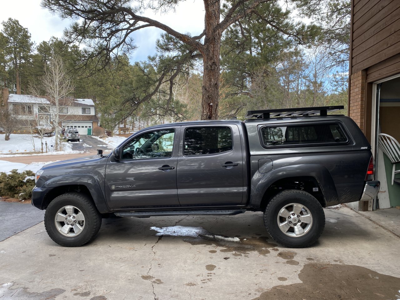

    So far so good. I have had the topper on for about a week now and there is no appreciable settling that I can notice or see. It might have actually settled a little because it was ever so slightly stink buggin when I did not have the topper on, but now it appears to be a little less to the eye, but since I never measured anything before or after the suspension install, I have no idea what the actual numbers are.
    Here is a pic with the topper a couple days after I got it installed, and YES, I have removed the gawdy Leer emblems from the rear glass....

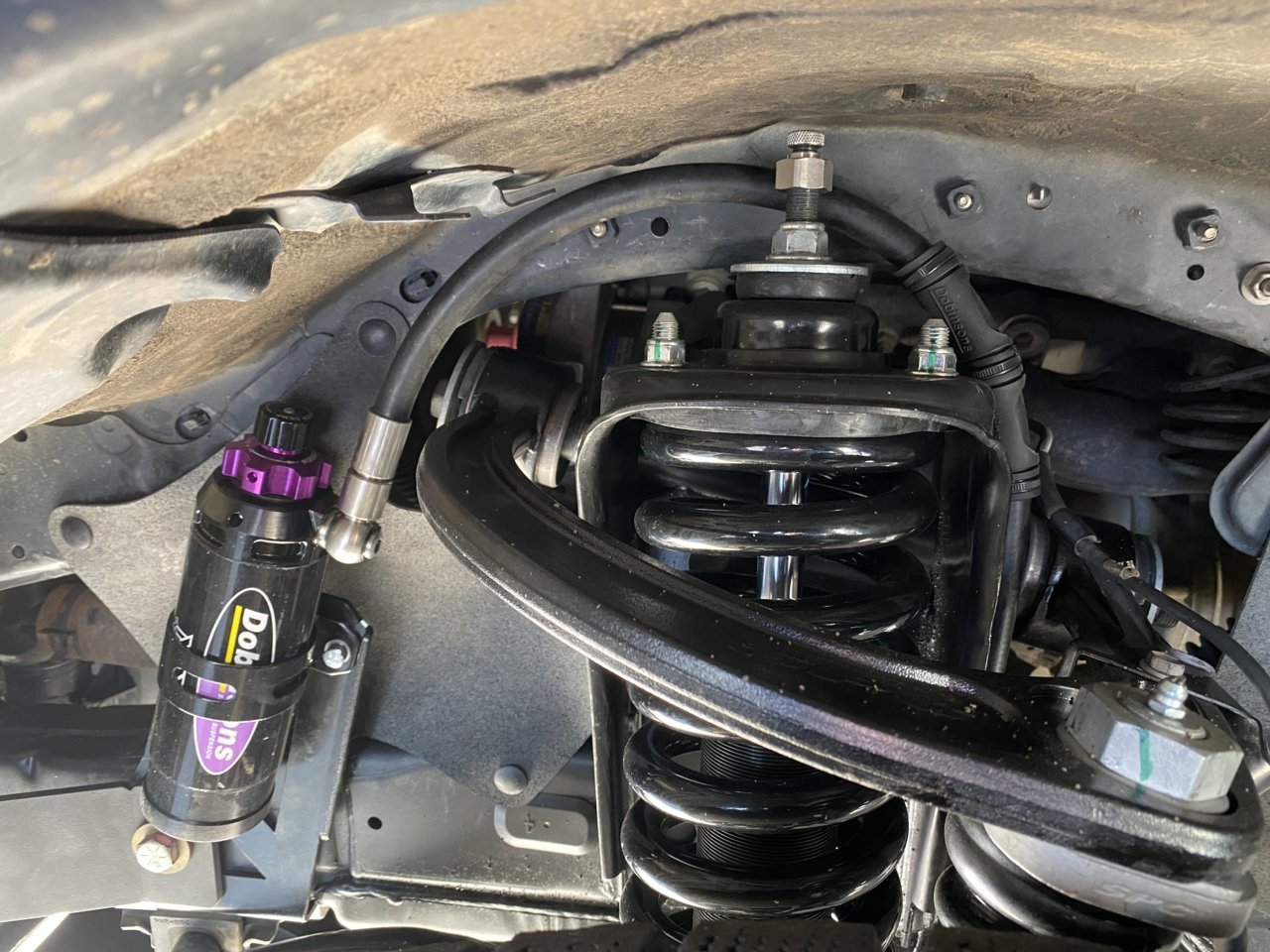

    Great Post. I ordered a similar setup, for my Gen2, in November (still waiting on some parts so I have not done the install yet.) Hopefully this isn't too much of a Hi-jack of your original post, but I am super excited to get my set-up installed and moving forward too... with that said, I did the same thing in November:
    I looked at Icon (since I have a stage 3 and liked them), OME BP-51 setup, The Dobinson's, and a few mixed combos Fox Rear + Icon Front, etc.
    But bang for the buck Dobinson's seemed to check all my boxes. I also had 3 people highly recommend a local shop (Armorology) and like supporting local folks so I purchased through them and decided to have them do a BMC for me. Jed has been awesome so far and it sounds like Mike from Exit Off-road helped get him set up as Dobinson's reseller so far quality folks all around which excites me more about the products from Dobinson's. In general I asked many people a bunch of questions, watched as many YouTube videos about the products as I could find, pulled everything out of my rig and weighed everything to get an accurate assessment of all my gear and how I run empty and full. (I am pretty confident I made a good decision)
    So What more did I want that I didn't have...
    1. Full adjustability on all 4 corners, and I wanted it to be simple)
    2. More OEM style bushings and joints.
    3. Longevity in the rebuild lifespan.
    4. More load capacity.
    What did I order?
    • Black Coil Springs (just could not do the turquoise)
    • Shooting for 2 - 2.5" Lift Selected the following:
      • 110-240LBS Front Coils (C59-352) (considered the MRA59-A220 but didn't want to end up pushing 3")
      • MRA59-A221 Front adjustable Struts
      • 213MM SEAT HEIGHT (Stock Seat Hight)
      • SC59-001 DOBINSONS STRUT TOP PLATES
      • BS59-560 DOBINSONS ADJUSTABLE FRONT BUMP-STOP KIT
      • MRA59-A940 Rear Shocks
      • L59-111-R DOBINSONS 2.1" LIFT 600LB CONSTANT LOAD HD
      • PB59-110K Bushing kit bundle
      • Greaseable Bolts for leaf bushings
    • SPC UPPER CONTROL ARMS (Considered the JBAs and almost went with Red Coils but the deal on SPC was too good)
    • Timbren Flipkit with new U-bolts and bumpstops
    • I'm also going to do a BMC along with the install (no more rubbing!)
    I also run 255/80/17 Cooper ST Maxx, (skinny is the new sexy) ;P
    *Last, a quick Note about my Icons... The Icons are great, but with the weight I am carrying now and traveling I am starting to do (last year even with covid and travel restrictions, I put 8k miles on in backroads) I figured I'd pull the Icons and see about getting them in the hands of someone who will appreciate/use them more effectively. Between that, rear springs not cutting it, and November pricing it was time to make the change.
    (Fyi - Icon Kit will be for sale soon 23K miles on it, working from home so I'm putting almost no miles on them currently)
    Things I didn't like about the Icons:
    1. I didn't like the idea of having to rebuild every 30k ish miles
    2. Ihe Icon UCAs were noisy and I was meticulious about trying to keep them clean and I even tried the caps on them. This is not Icon's fault, I should have chosen better.( I will never use uniballs again, I should have went with Deltas, but they were not super common at the time )
    3. I did not plan for the weight I am carrying now when I purchased them and I was doing some trips about one weekend a month to wheel and some camping on the off weekends. That is far different than where
    I am now. (up to 2 weeks at a time on the back roads and exploring, I am going to shoot for 40 nights this summer and now that I can work remote I may be able to try some remote work from the road.) I don't use the truck for much daily driving.
    In short all this just means I did not plan well when I was struck with the TW upgrade sickness and I had to do a fairly spendy re-purchase. (hopefully I will make up a little in the resale of my low mileage Icon Stage 3 setup) [which will need new Uniballs or Deltas].

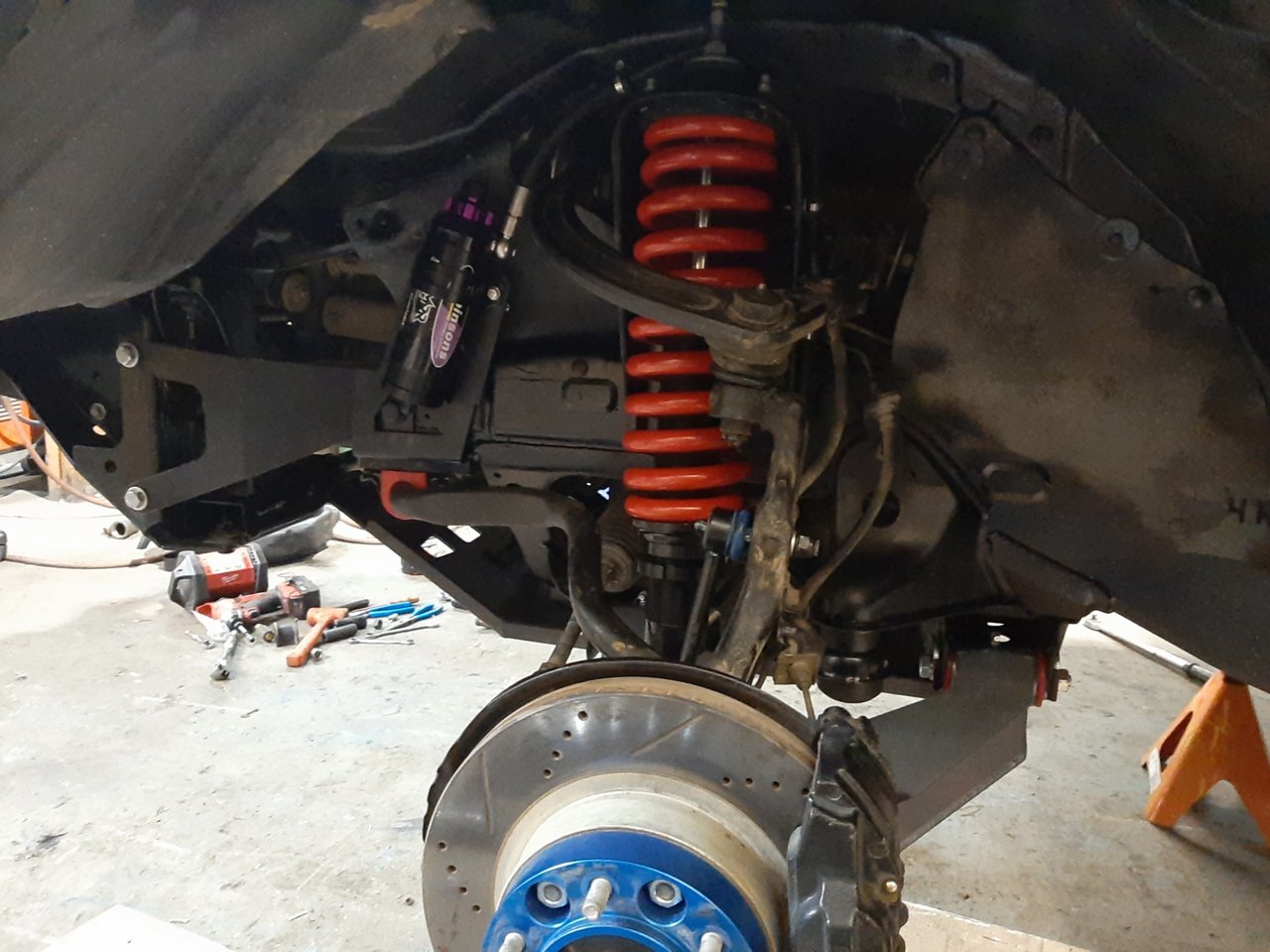

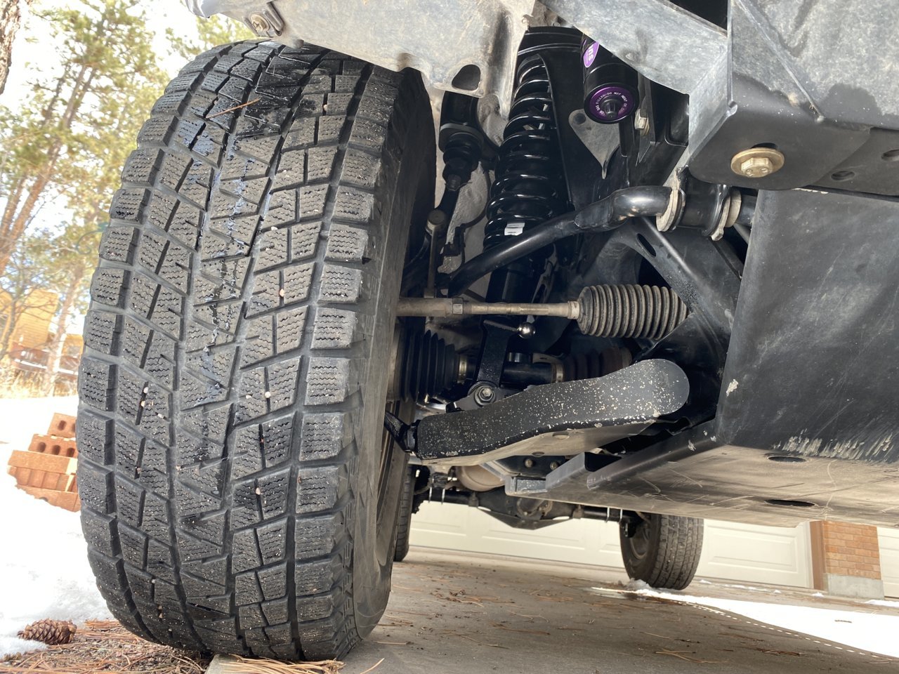

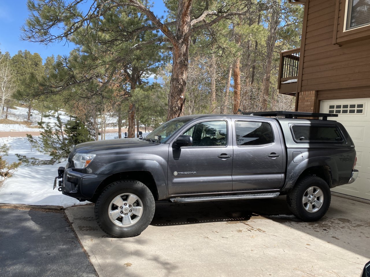

    Some photos of the finished work. I have just started reading up on adjustments so I’ll be figuring out what I like soon. It already rides better. I would expect nothing less from brand new UCA + LCA + Full suspension and springs. I decided to not use the greasable bolts and instead just used anti seize on a new set of bolts.

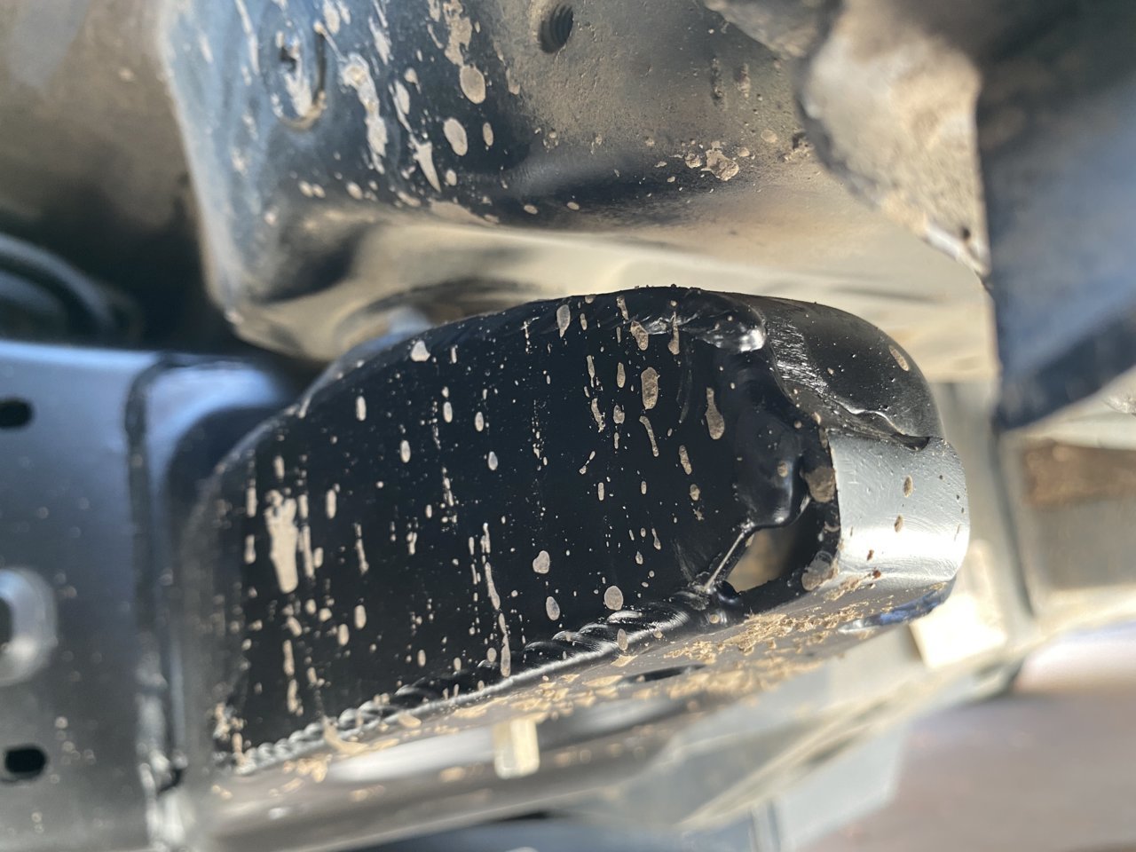

    while I was at it I had a flip kit and cab mount chop done as well. The chop turned out super clean.

    Cab / body mount chop...

    Right on! @000doodie000 Looks good! I stsrted with the 252 front coils, but maxed out on the thread adjustment to get the highest lift. Going back, I wish I had gone with the 354s with my winch up front. I ended up adding the 1/4" top spacer to get that extra 1/2" up front.
    It looks like you have a slight rake in the rear, even with the shell, so you might consider the easy 1/4" spacer route like I did (as recommend by @Crikeymike :thumbsup:)

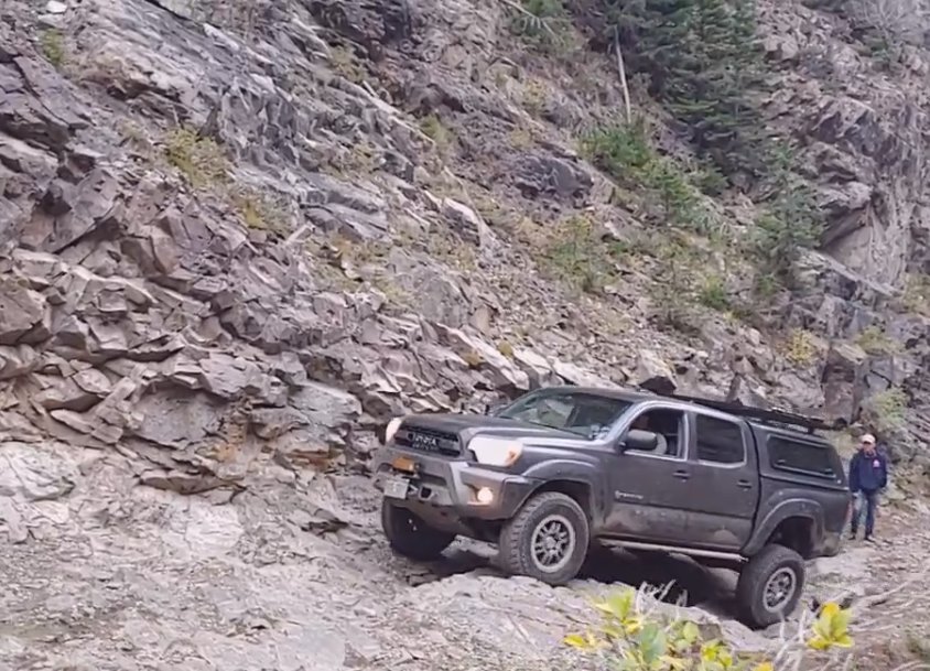

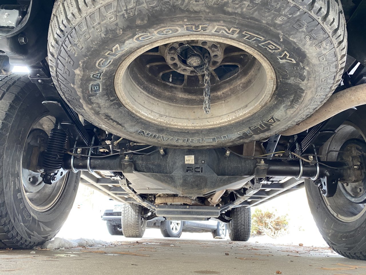

    Here is a shot of it loaded just under 600lbs. I have a few roof boxes that go on and then food and it sits full at just over 600 lbs. As you can see she is pretty level when loaded up.
    Here is a shot of it "articulating" last year on one of our day outings.
