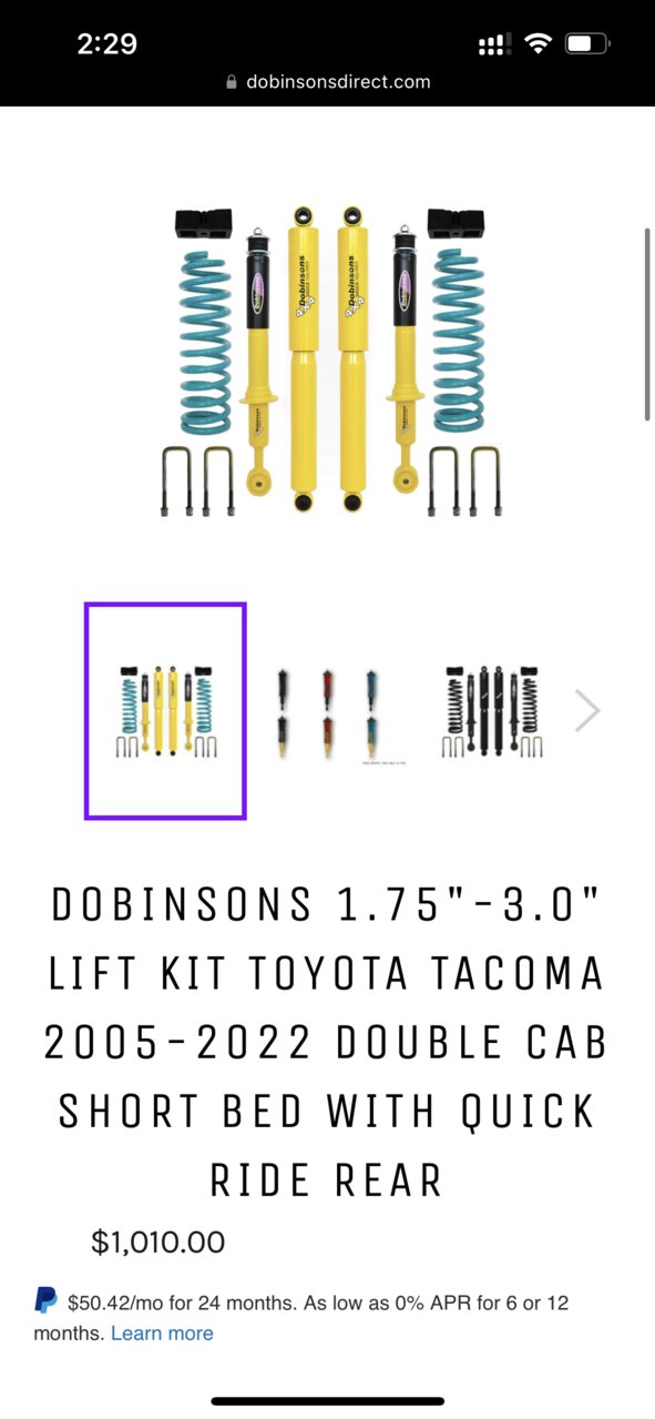

    Yeah, either way. The way I have the kit builder on my page gives you heaps of options to replace pretty much everything, and to lift the rear with either blocks or an add-a-leaf kit.
    https://exitoffroad.com/product/dobinsons-lift-kit-toyota-tacoma-2016-2020-with-quick-ride-rear/
    Doing a low lift, like 2" front and 1" rear won't affect driving quality or geometry much at all, and also doesn't require UCA's and other parts that a taller lift needs
