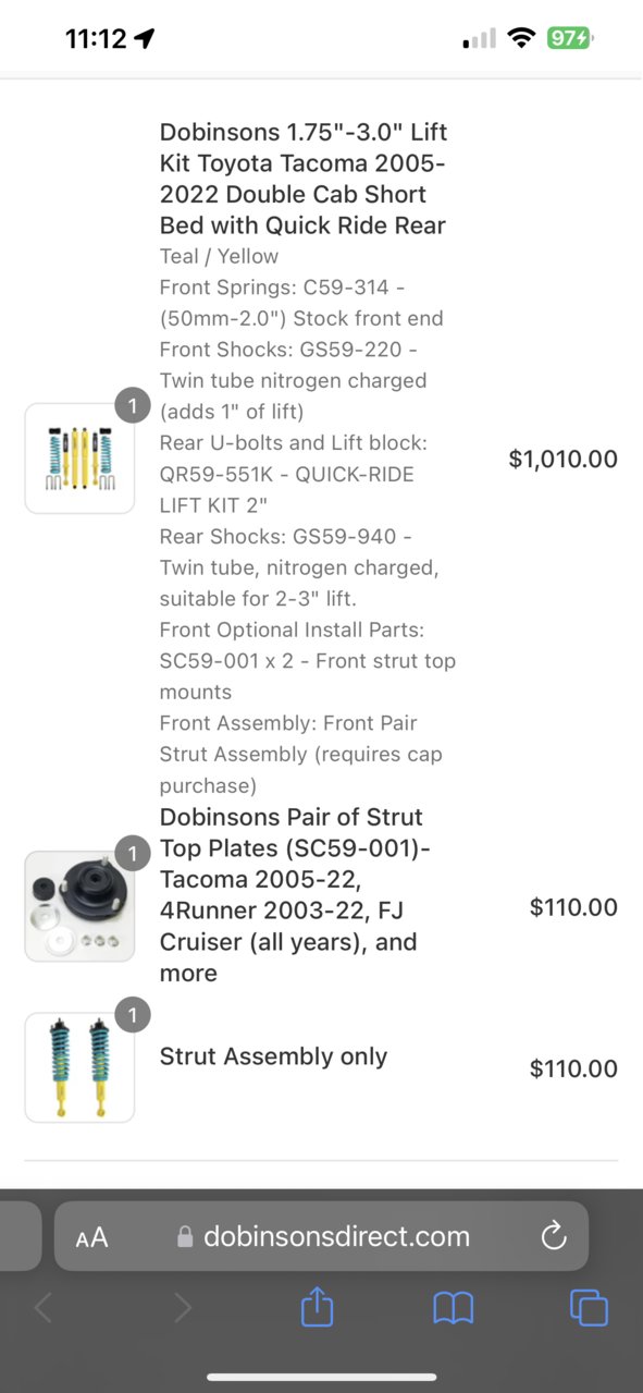

    Hey guys need input on the lift I’m thinking of getting to pair with 33” tires. Would 3” front and 2” back work for my purpose? Do I need a diff drop kit? See attached image. TIA

    That's a very common setup. 33's are the most common size to fit, however there's always a chance of trimming or chopping needed depending on how much those tires contact the front inner fenders and body mount.
    A diff drop kit isn't required, but it's recommended.
    New UCA's are also needed at that height.
    Our website breaks down the options much more clearly: https://exitoffroad.com/product/dobinsons-lift-kit-toyota-tacoma-2016-2020-with-quick-ride-rear/

    Thank you @Crikeymike, I did check your website but went to dobinsons direct since it was a tad cheaper with the fronts assembled. Do you a coupon code by chance? Lol trying to save as much as possible.
