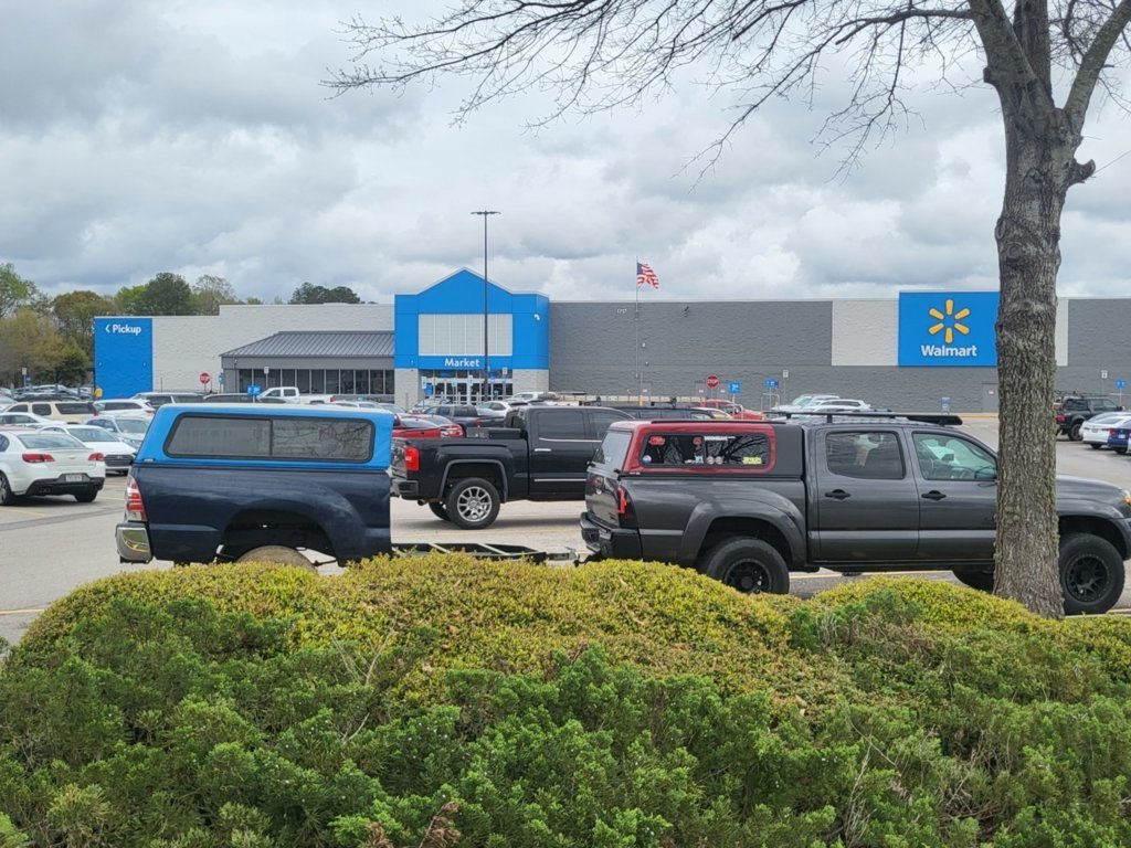

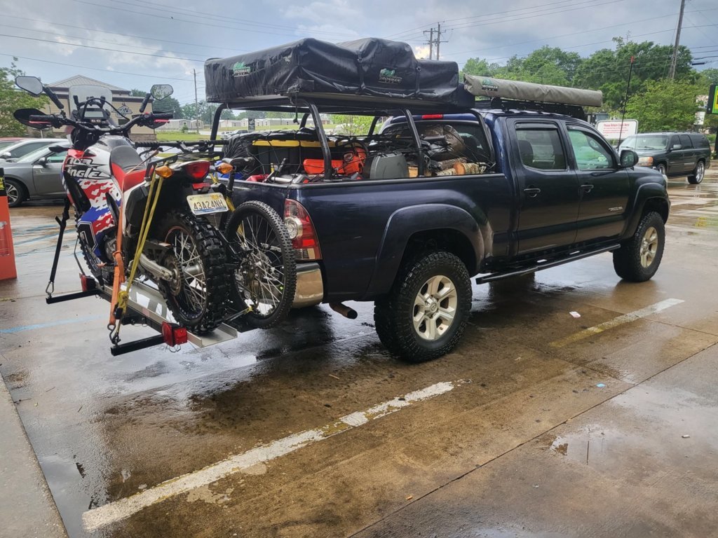

    Nice!! Love seeing a real world example of how the truck will look.
    Looks like you had a pretty heavy load in that second picture, and the truck wasn't squatting very much.
    Very good to see
