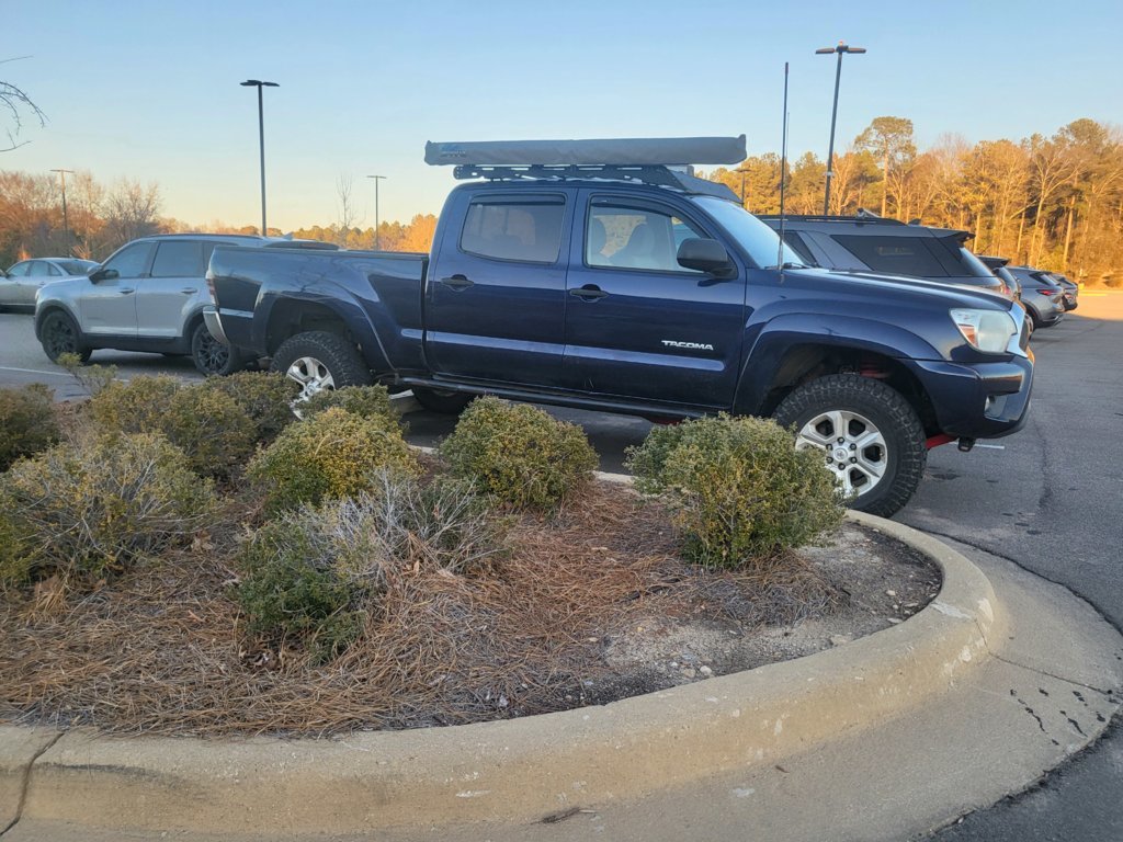

    The first section of bed was full of wood. I also had a 3500W generator, 2 5 gal water jugs, and a bunch of other crap. The CRF is 339lbs stock....so it had quite a bit of weight :rofl:
