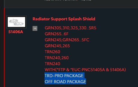

    Hello all! After some searching I couldn't find a concrete answer regarding this skid plate in specific. Got the ECGS bushing installed recently and noticed that there was no second smaller skid plate behind the main plate in the front that would cover the front diff.
    I ordered up this guy -
    https://parts.tustintoyota.com/p/To...upport-Splash-Shield/63047074/5140604020.html
    and the dealer emailed me saying that that specific plate never came on the truck from factory and is not compatible. Is there any chance he was mistaking and that that skid plate will fit on my 2012 dclb 4x4 sport?

    you're talking about this one at the bottom right of the pic below, yes? I honestly can't say whether the smaller piece came on all, but to my understanding the factory "skids" seen below on the right side were only included on the offroads, bajas, and I believe pros.

    yes, the smaller one on the right. Yeah I am wondering if that's the case. Thanks for your input! Much appreciated!

    ahh sure enough I didn't see this drop down when I ordered the plate. I am getting a refund, haha. Thanks again!

    It Will fit on your Sport, even tho they didn't come on the Sport package. I have both on my sport

    yeah the threaded holes in the crossmember will be there to bolt it up, but only the TRD OR and PRO came with them from the factory.

    I've seen a few posts about both skids coming with upper level trims from the factory as mentioned above^^^^^ but my stock-as-a-rock '09 RC 5-speed, with not even the convenience package or power-anything, had both on when new.
