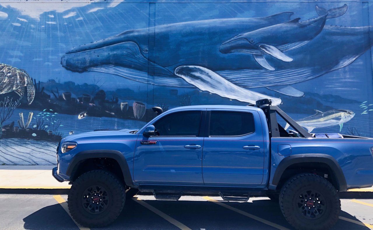

    Drop bracket is a lift cutting into your frame permanently and replacing your crossmember with a aftermarket one to accommodate with the Db lift. Since these trucks can only go about 3" max of coil over lift which is superior for offroading with coil overs. If you wanna pass 3" and gain 6" of lift, then you may need to go with a drop bracket (DB).
    Tho i like the way your truck sits, what lift you went with? Do you offroad?
