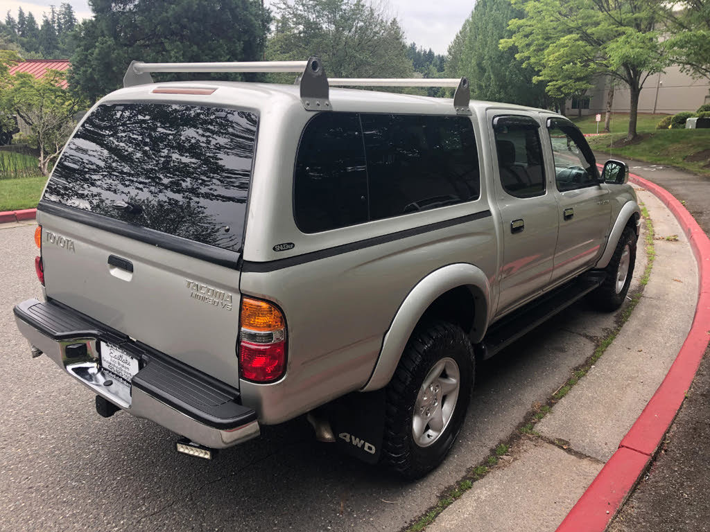

    I’m wondering if the 2002 Tacoma crew cab 4wd 3.4L V6 “Limited” is also a TRD? I ask because this truck is advertised as a Limited and a TRD, but it doesn’t have the TRD Off Road graphics. I’m concerned because I know of a 2004 crew cab 4wd 3.4L V6 Limited that does have the TRD Off Road graphics.
    Are some Limited models not TRD? Or maybe the TRD graphics were removed? Or does Limited already imply that it’s a TRD?

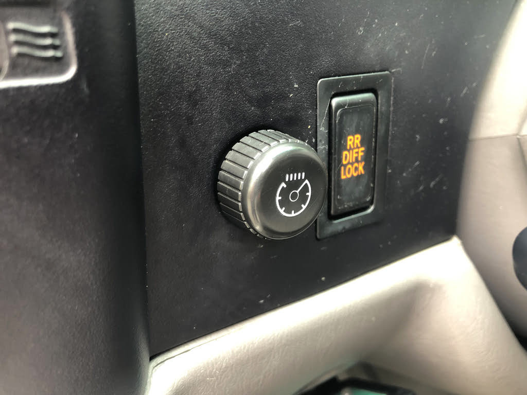

    This 2002 Limited does have the rr differential locker which makes me think it is in fact a TRD as well. I’m unsure of the shocks at this point but could find out soon. I included some pics below. Any help would be great, my head is spinning trying to figure this out. Thank you.

    A buyer could have wanted a limited model taco and ordered it to have a rear locker as an add-on. It didn't happen often, but definitely happened.
    The rear stickers could have been removed, the rear might have been in accident and body shop did not add those decals back after repair, or it is not a TRD model and is Limited with added locker.

    Thanks for the quick reply. The carfax doesn’t show any accidents. The other scenarios you mentioned seem possible though.

    It also has the TRD style wheels. Just food for thought look under the truck to see the locker motor on the rear end. All the other TRD stuff is worthless by now. Shocks will need replaced etc. Are the seats the larger bolster seats with power lumbar?

    I had the same truck.If it has the locker it is the TRD OFFROAD..

    That's a dam fine looking Tacoma. Looks a lot like mine. I have a 2003 Tacoma limited, same color scheme. Mine is a TRD, but I had to have one of the rear quarter panels repainted from very minor fender bender. I chose not too replace the TRD stickers, so that I wouldn't look like every other TRD on the road.

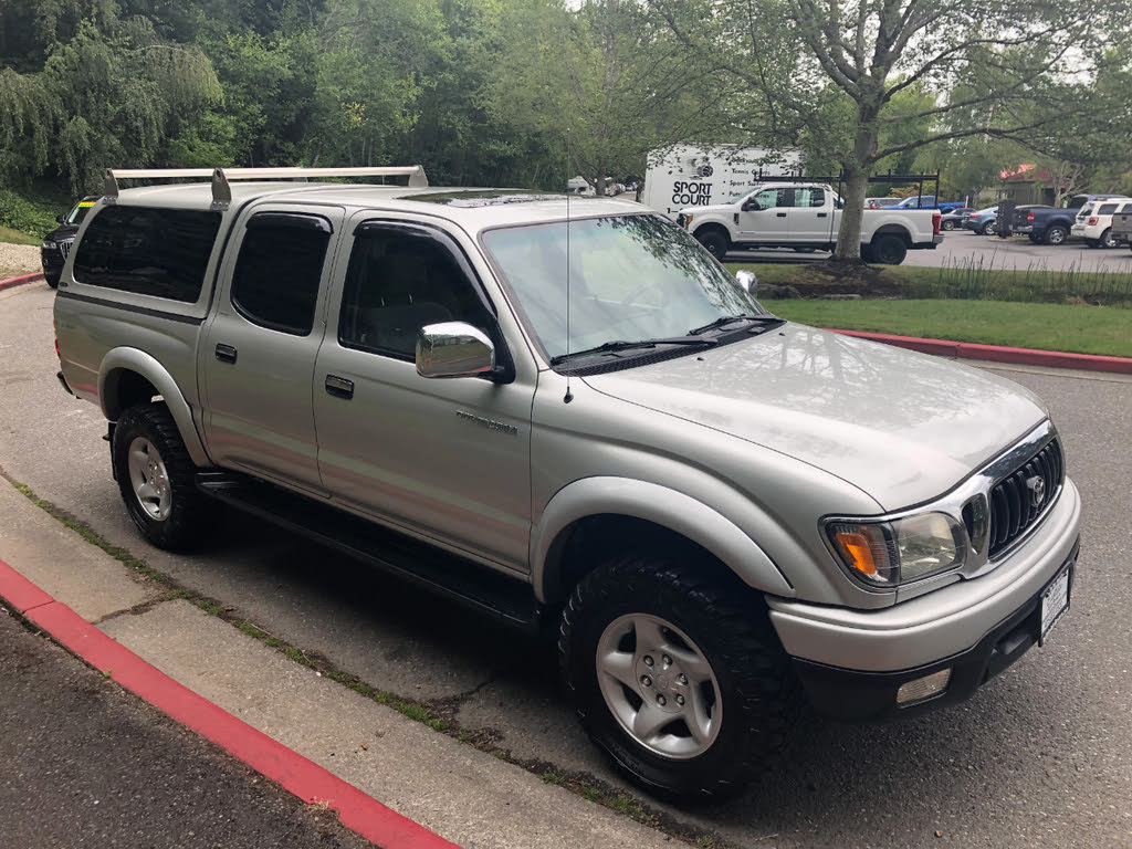

    That’s a cute truck

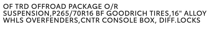

    Thanks for the input. Turns out you can figure this information out very quickly by requesting a Vehicle Spec Sheet from any Toyota dealer. All they need is the vin. The spec sheet only shows what was included at the time of the original purchase however. Anything added later will not be included.
    The vehicle in question does have the TRD Off Road package included, as well as the Limited package (which was never a doubt). Again, all this was verified by a Toyota dealership via the Vehicle Spec Sheet. I believe the graphics were removed for personal aesthetic reasons. The dealership was also able to supply the original TRD graphics.

    Was that sun roof factory? Does it come with the limited package standard? What a beautiful vehicle...

    Thank you and yeah it is! Looking at the spec sheet it was a factory add-on not included with the limited package.
