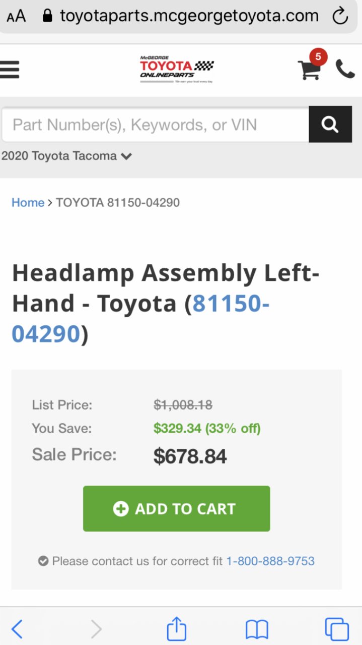

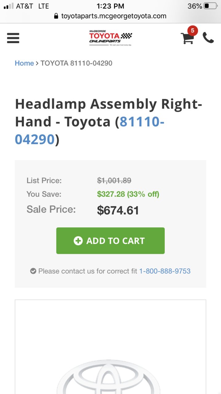

    $1400.00 for 2 headlights and I bought a 1967 , 4 door Malibu with a strong 283 for $200.00 back when . The paint was all faded but only had 50k miles on her .

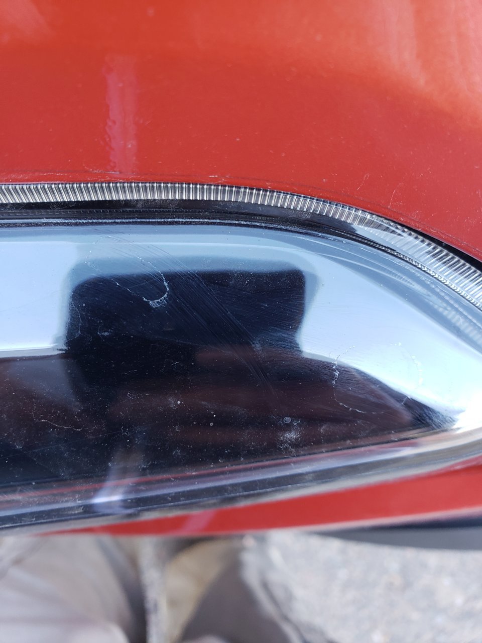

    Not impressed with the quality of my OEMs (not referring to output). This is not the first time someone has posted peeling associated with them. Vehicle has never been garaged but this would make me VERY hesitant to spend the premium on the new pros or OR's headlight that have the same dumb shape and the same materials. A shape that let's the elements have their way with these. Heard you can get them "re-cleared" but not sure if that's true. Waiting until they look like complete shit before I do anything. Well on their way though.

    any polycarbonate lens you can "reclear". You don't even really need to reclear, just add sealant on every 6 months or so. But if you want to, it's just clear polyurethane that's been diluted with mineral spirits.
    In cases of peeling or clouding you can use a kit that 3m sells, which is basically just sand paper, and some polish and polishing drill attachment.
    Honestly I would do it now, since you only have a small spot instead of the whole headlight.

    Sweet, good news. I'll look into that thanks. I've seen restoring kits but thought it was for "clouding". Haven't seen a kit for peeling, but honestly never really investigated. Seems it would be the same process though. Thanks again! :cheers:
