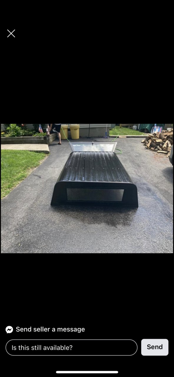

    Bringing this back up. I would like to put this on a 2nd gen. Owner had it on a 2016. The tailgate hatch doesn’t seem to have the curvature that most 3rd gen caps do. I wouldn’t mind it being an inch shorter. What do you guys think?

    Did you get that cap? I put a curved tailgate skirt from a 3rd gen cap on my 2nd gen cap and it fits. A little short at the front, but no water gets in. The hard part is getting the tailgate curved skirt.
