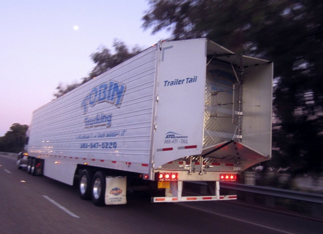

    Maybe someone will come out with fins for passenger trucks like semi trailers. I would think a hard top cap on a truck would be the most drag.
    "These fins are not keeping the flow from transitioning to turbulence. The flow is very turbulent. (Check the Reynold's number you scientists!) In fact, laminar flows are often associated with higher form drag (see: why golf balls are dimpled), which wouldn't be desirable. More drag = higher fuel costs.
    The flaps are aerodynamically easing the flow around the blunt rear end of the truck. This reduces the size of the recirculated air pocket behind the truck, which is low pressure and effectively "sucking" the truck backwards from its direction of motion."

    I wonder if the fuel burnt at idle while the driver unfolds and packs that contraption away, will nullify any fuel savings gained while on the road?

    Not sure, but some truckers are driving 100k+ miles a year so saving a fraction of a mpg adds up pretty quick.

    Working for a large transportation company we moved away from these because the cost of continuing to have the repair them and the down time related to that and the time around setting up and taking apart the system at each load/unload negated the minimal fuel gains we received.
    Frankly our time is better served around driver coaching on fuel usage/idle time when the truck is not in motion.

    Damn so you have to take them off everytime they dock?

    Yes I'm sure those things add mpgs along the way.

    Yes. All the flaps need to fold back. The door is also two swing doors so those swing to each side as well. Needs to be removed before you swing the doors and bump the dock and then put back up before the driver leaves out.
    Needless to say with how much those pieces are taken apart and put back together they pick up a lot of damage. And when there is a broken part of it, it’s just further time wasted that they are waiting for a service to come repair that they otherwise wouldn’t have to deal with.
