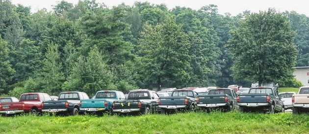

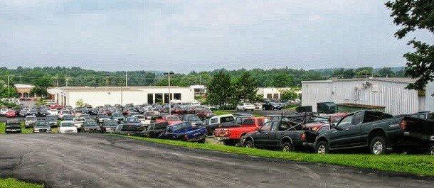

    Pics of bought back Tacoma's waiting their demise on my dealer lot back in 2007.
    2006 rust in 2009

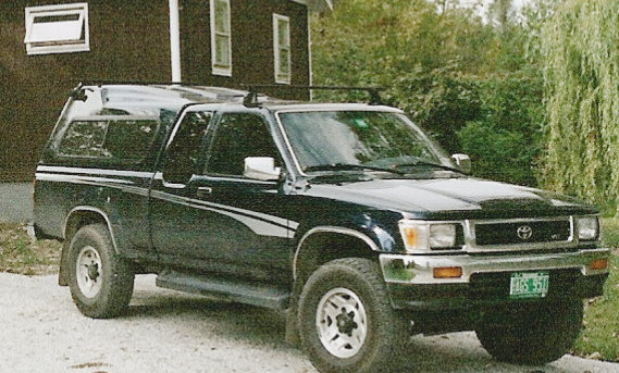

    My 1995 new
    My 1995 in 2008
