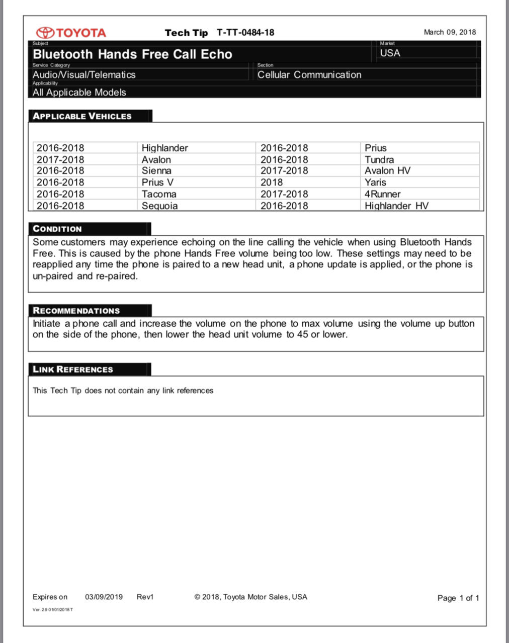

    Not sure if it applies to you guys, but there is an update for the headunit
  6. Aug 1, 2018 at 4:07 PM
    ToyoVL
    ToyoVL Well-Known Member
    Mar 22, 2018
    #248053
    65
    Tech tip on echo

    33DCC525-8B00-426C-8734-35418D2A75C5.jpg Have tried you this yet?

    Wow! That might have done it! I’m going to take a drive and try it out while on the road.
  17. Feb 17, 2019 at 12:36 PM
    #17
    Quickdraw08
    Quickdraw08 Well-Known Member
    Feb 10, 2019
    #282538
    58
    Andrew
    2019 White Tacoma TRD OR
    Yes sir! Mad rep's to St0rm-Tr00per. That fixed my issue. I never stumbled upon that article until you posted it.
    I have to keep my car volume at 38 and turn my iPhone volume up to high. It's perfect now.
    You just saved me a ton of time tomorrow by not having to go to the dealership!

    Glad to help!! I experienced the same issue when I first got my OR several months ago and stumble across this in the “sticky threads” section of the forums. ToyoVL actually posted the PDF of the tech tip first ... I just converted it to an image for ease of reading.
