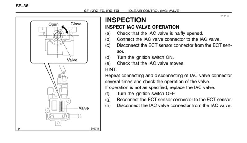

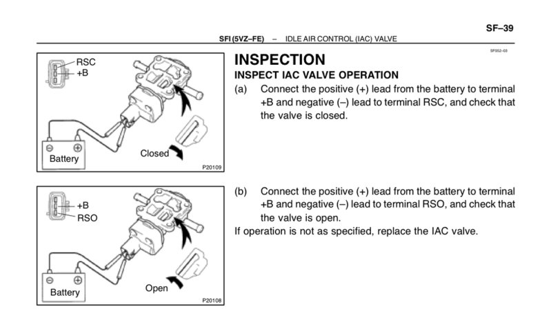

    If your IAC is like the 96 IAC (that's I'm familiar with), you can check the resistance across the terminals, and there's a way to hook battery up to specific terminals and check that the valve is fully open and fully closed. Refer to the repair manual for your year.

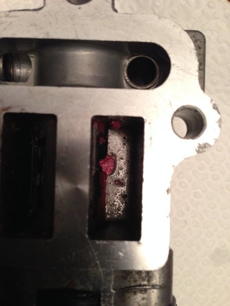

    I finally got around to checking my IAC valve and this is what it looked like. What do you think that pink stuff is? Anyway I ordered a new from Toyota. This is a $30 special, ordered on Alibaba and shipped from China. The valve wouldn't move at all even after I cleaned it out. It never worked right from day one. I guess you get what you pay for.
