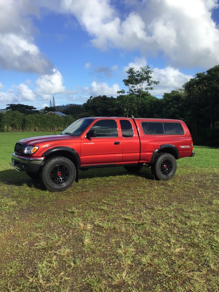

    Mostly cosmetic but she ain’t stock(looking) anymore.
    First Gen. hub bore size 139.7 and the offset for ‘24 wheel is like -33 or something so totally different animal. My 16” 6 lug stock alloy wheel on my ‘04 had a +15mm offset. After some research I’ve found that the ‘16-‘19 TRD Pro 16” 8-spoke wheels with +13mm fit best for me. Stock suspension no spacers.

    Looks good!

    Thanks koco!
