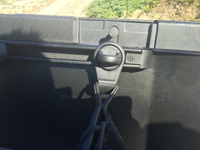

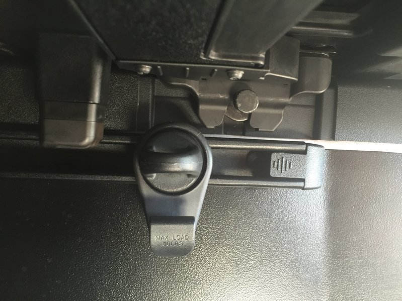

    My factory Tonneau cover wasn't flush as well when I took delivery of my truck. I moved the bed rail tie down away from the locking mechanism on the last section of the cover and now it sits perfectly flush. I also picked up some of the Toyota mini tie downs because I like having the cargo net at that exact spot where the Tonneau locks. Problem solved, tight, flush fitting factory Tonneau cover, and might leak a few drops when it rains, but hardly at all. The rearmost section of the cover actually clicks twice; the initial click where it catches but still has play in it, then the second click that locks it snug. The tie downs were preventing this second click.

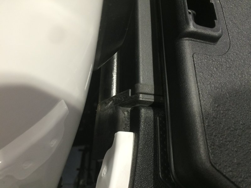

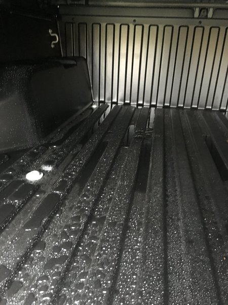

    This is how tight my factory cover seals on my 16 taco. Not very impressed image.jpg

    @Blek13 Did you compress past the first click? It has a two stage lock.
  12. Jan 16, 2016 at 11:54 AM
    #72
    Blek13
    Blek13 Active Member
    Nov 23, 2015
    #170485
    40
    Nantucket
    2016 super white TRD Sport DC

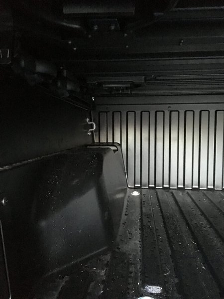

    Yes, I did. I couldn't find any other adjustments. I sent an email along with pics to dealer..... I'll see what they have to say. Not impressed. It was raining hard and windy, but that much rain to get in is just not acceptable.
  13. Jan 16, 2016 at 11:57 AM
    #73
    Jaybez
    Jaybez Well-Known Member
    Sep 7, 2015
    #163607
    178
    Fort Mill, SC
    2016 Tacoma TRD Sport 4X4
    From your picture, I can see a speck of light in the top left. If the top can't be adjusted anymore, maybe you can get a piece of 3M foam to go in there to close the seal

    Thats a bummer. It's been dumping for several days where I live and I just checked and only a few drops inside the bed. I wouldn't get my hopes up though going back to the dealer. The owners manual actually says it's technically not waterproof, and they'll probably side with the owners manual when you take it in.

    Looks like you are missing the foam seal on the header end rails. Believe Toyota started adding them only recently to models with the tonneau. Part numbers 62541-04010 and 62542-04010
    cemented likes this.

    I think I have the foam seal on the header, but there are large voids in all 4 corners. You can see all the light that comes through.

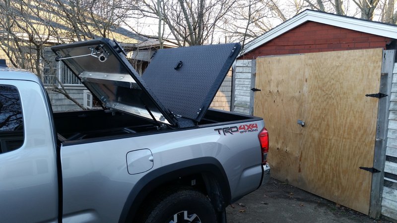

    Id go aftermarket. Diamondback SE

    I emailed the salesman with pics of water and where it's getting in. He emailed back and put me in touch with the service Dept. I just spoke to them. They are ordering me a brand new cover and installing it to alleviate the problem. Not all dealers are bad. :thumbsup: Thumbs up to Hyannis toyota!!!
